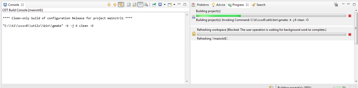

We have observed that project build time increased exponential over period of time. Initially we were facing issue as described in thread.
To ensure performance on fresh system We have build our entire tool chain again and added benchmark for build time.
We saw that on fresh system build time of project is 4 min. Over time of 4 weeks build time increase respectively to 15 min, 21 min and 46 min.
We build CCS project using external builder through command line though problem is not limited to command line build. We even tried using IDE and attached screen capture shows build state during stalling.
OS:  Virtual machine with Win7 Ultimate, Service Pack 1.
CCS  Version: 8.3.0.00009
Compiler Version: TI v18.1.3.LTS
No Anti-virus running on machine.
Can anyone from community guide us? What can cause increase of build time over period of time using external builder?  Slow build is bottle neck for our development cycle. Let me know if anyone needs more info on the above issues

    We can not upgrade to CCS 9.0.1 as XDS510 class debug probes are not supported with CCSv9. I tried disabling parallel build and disabling windows Defender. I also increased Java heap size to 1024M, but no change observed on build behavior.
    However cleaning system temp folder improve build performance significantly, we will be monitoring build time for next couple of weeks and update you.
