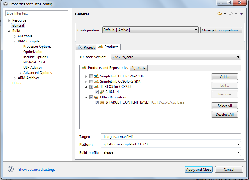

  • Yes, my application is based on Ti-rtos. This is the present configuration of ti_rtos_config. Which is currently using XDCtools version 3.32.2.25_core.
    But when I changed it to 3.50.8.24_core and Re-Builded it then it throwed the following error-
    Description Resource Path Location Type
    xdc.cfg.Program : The package 'ti.sysbios.knl' is not compatible with XDCtools used in this build. Please either use XDCtools compatible with that package, or update the product containing that package, or rebuild the package with XDCtools 3.50 or later. .xdchelp /ti_rtos_config line 71 C/C++ Problem
    Keshav
  • That TI-RTOS does not support XDCtools 3.5x. You need to stick with 3.32.2.25 that you were using and then use ROV classic.
