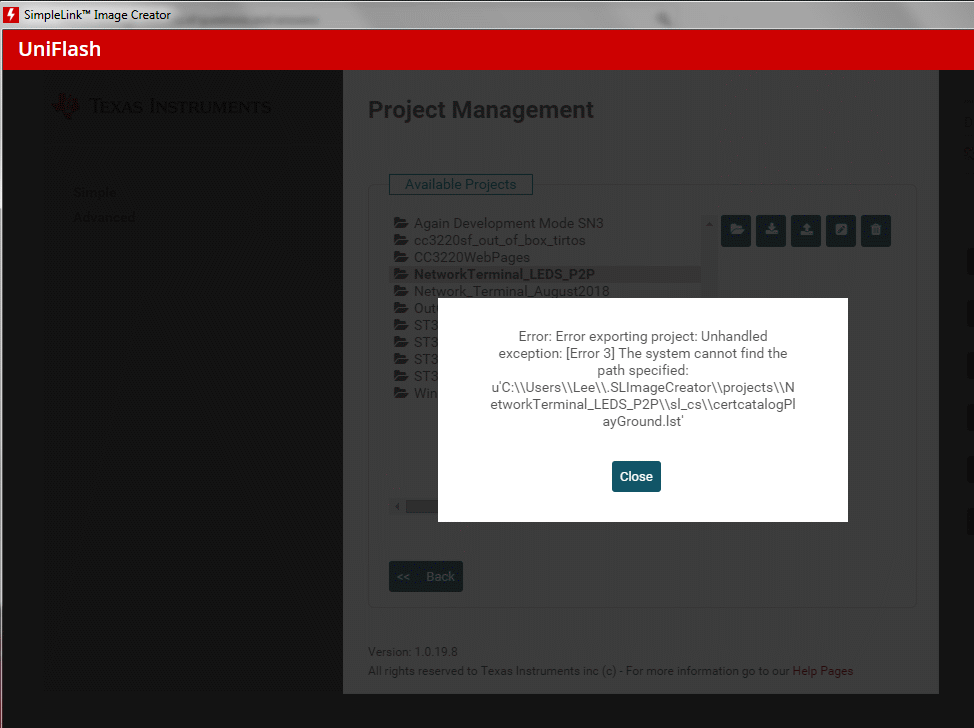

    I am trying to work with a Project Image per section 7.1.3. I have a project in Uniflash GUI which I have programed into the Launchpad where I changed the version reported on the network_terminal menu so that I can differentiate the project and know I have flash programing success.
    When I try to export the project from Uniflash GUI however I get an error.
      (Note: Since I have modified the example project, I renamed the project from Network Terminal to NetworkTerminal_LEDS_P2P after this screen shot was made.)

    Uniflash saving issue:
    The project you are trying to export cannot find the certs requested. Make sure the either the default is set, or reset these and try again.

  • Uniflash GUI Export failure.
    FYI, This project is the network_terminal example with a few changes I made to enable the LEDs to show status of the P2P connection progress.
  • Forrest,
    From the message, it looks like it can't find the certcatalog. Can you verify these are setup properly in the GUI before exporting the project?

  • Vince,
    Regarding, "Can you verify these are setup properly in the GUI before exporting the project?"
    I do not have one anwser to this.
    First answer would be,  I can program the target with Uniflash from the GUI. So that seams to be a yes.
    Second answer would be, I have no certCatalog in the GUI so perhaps I have an invalid GUI setup.
    I do not know how to understand the requirement further.
    Can TI provide a properly setup GUI example as a base line?
