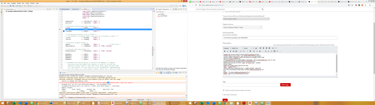

CCS/LAUNCHXL-F28069M: I CANT BUILD Caused by JUST ONE ERROR
Part Number: LAUNCHXL-F28069M
Other Parts Discussed in Thread: CONTROLSUITE
Hi ALL MEN WO MEN!!
So Look at this
makefile:149: recipe for target 'Example_2806xLaunchPad.out' failed
warning: creating output section ".cio" without a SECTIONS specification
warning: creating ".esysmem" section with default size of 0x400; use the -heap
option to change the default size
"D:/ti/controlSUITE/device_support/f2806x/v140/F2806x_common/cmd/F28069.cmd", line 141: error:
program will not fit into available memory. run placement with
alignment/blocking fails for section ".ebss" size 0x223 page 1. Available
memory ranges:
RAML2 size: 0x400 unused: 0x0 max hole: 0x0
.ebss : > RAML2, PAGE = 1
warning: entry-point symbol other than "_c_int00" specified: "code_start"
error: errors encountered during linking; "Example_2806xLaunchPad.out" not
built
gmake: *** [Example_2806xLaunchPad.out] Error 1
gmake: Target 'all' not remade because of errors.
**** Build Finished ****
AS you can see in the picture above
now iam using example program but i think consol says now you are using not fit memory right?
i dont uhnderstand easily
wht should i do T,T
have no idea where i should be on start.
plz give me tips! thanks
Now iam using ccs ver7
and this is fullversion about consol announcement

"../sci_io.c", line 112: remark: parameter "new_name" was never referenced
  int SCI_rename(const char * old_name, const char * new_name)
'Finished building: ../sci_io.c'
'Building target: Example_2806xLaunchPad.out'
'Invoking: C2000 Linker'
"D:/ti/ccsv7/tools/compiler/ti-cgt-c2000_16.9.3.LTS/bin/cl2000" -v28 -ml -mt --cla_support=cla0 --float_support=fpu32 --vcu_support=vcu0 -g --define=_DEBUG --define=_FLASH --define=LARGE_MODEL --quiet --verbose_diagnostics --diag_warning=225 --issue_remarks --output_all_syms --cdebug_asm_data -z --stack_size=0x200 -m"Example_2806xLaunchPad.map" --warn_sections -i"D:/ti/ccsv7/tools/compiler/ti-cgt-c2000_16.9.3.LTS/lib" -i"D:/ti/ccsv7/tools/compiler/ti-cgt-c2000_16.9.3.LTS/include" -i"D:/ti/controlSUITE/device_support/f2806x/v140/F2806x_common/lib" -i"D:/ti/controlSUITE/libs/math/IQmath/v160/lib" -i"D:/ti/controlSUITE/libs/math/FPUfastRTS/V100/lib" --reread_libs --priority --verbose_diagnostics --issue_remarks --xml_link_info="Example_2806xSci_Echoback_linkInfo.xml" --entry_point=code_start --rom_model -o "Example_2806xLaunchPad.out" -lrts2800_fpu32_fast_supplement.lib -lrts2800_fpu32.lib "./Example_F2806xLaunchPadDemo.obj" "./F2806x_Adc.obj" "./F2806x_CodeStartBranch.obj" "./F2806x_CpuTimers.obj" "./F2806x_DefaultIsr.obj" "./F2806x_GlobalVariableDefs.obj" "./F2806x_PieCtrl.obj" "./F2806x_PieVect.obj" "./F2806x_Sci.obj" "./F2806x_SysCtrl.obj" "./F2806x_TempSensorConv.obj" "./F2806x_usDelay.obj" "./sci_io.obj" "D:/ti/controlSUITE/device_support/f2806x/v140/F2806x_common/cmd/F28069.cmd" "D:/ti/controlSUITE/device_support/f2806x/v140/F2806x_headers/cmd/F2806x_Headers_nonBIOS.cmd"  -lIQmath_fpu32.lib
remark: --output_all_syms is deprecated and will be removed in a subsequent
   release. This is now the default behavior of the compiler.
remark: --cdebug_asm_data is deprecated and will be removed in a subsequent
   release.
>> Compilation failure
   memory ranges:
   built
  • Hello SungJin,
    memory ranges:
    Yes, you are correct. Your linker command file (F28069.cmd) is telling the linker to place the .ebss section to RAML2 memory range (address 0x8C00 with length of 0x400). According to the message above, there is no unused space available (if is already full). So you will have to modify the linker command file so that you either free up space in RAML2, or try to place .ebss somewhere else.
    How to do that? Please carefully read the below document on how to modify your linker command file:
    http://dev.ti.com/tirex/explore/node?node=APJQ1q8Ox6tOF4TmB4THeg__FUz-xrs__LATEST
    There is a lot of information, but it is very useful to go through it slowly.
