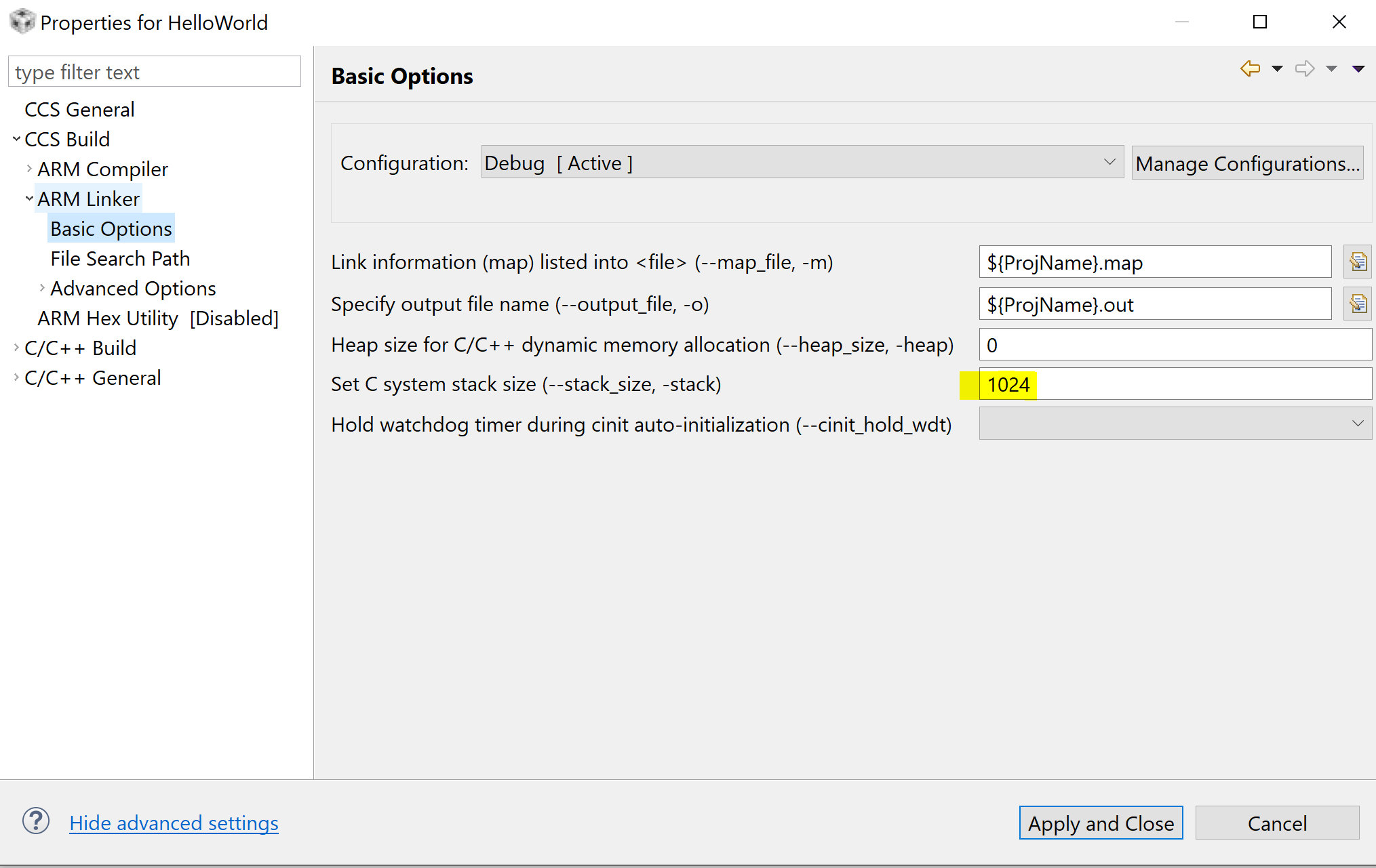

I created a new "Hello World" project using the builtin New-> CCS Project-> Basic Examples->Hello World.  When I first ran it, started at main() in C code it went to FaultISR(), displayed as C code.  Running it again it halts initially at _c_int00_template(...) in assembly code.  When I press the Run arrow it starts but immediately returns and stops at the same location.
I have no idea about how to go about debugging this.

  • The issue is that the default stack size, 512 bytes, is too small for the CIO printf() function. To increase the stack size you need to change it in two places. First in the build configuration. Right click on the project name and select "Show Build Settings...". Then expand the tabs "CCS "ARM Linker" and "Basic Options". Change the stack size as shown here:
    The second change is in the link command file "tm4c1294ncpdt.cmd" (The actual name may be different if you picked a different device when you started this project.) Line 45 (or close to the end), change:
    __STACK_TOP = __stack + 512;
    to
    __STACK_TOP = __stack + 1024;

  • Thanks Bob. This did not solve my issue, the stack size was set to 512 and I upped it to 2048 and it's still the same. The target is not a Launchpad but my own prototype.
