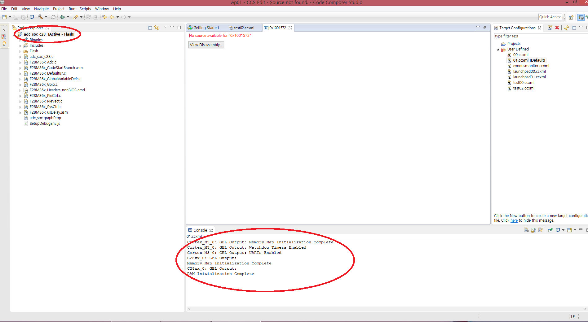

I have a develop kit F28M36P63C2 one and i got succeed on build example project & take .out file either
And I made target configure options be done (Option was selected in XDS100v2 USB Debug Probe_0/Cortex_M3_0, F28M36P63)

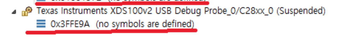

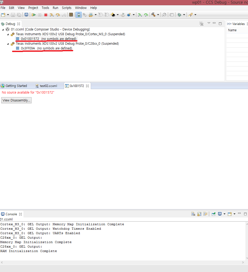

Next I moved Debug pages and I did connect target already
I know the next Stage is Load my files on those probes(?) and m3 is about communication conditions n the other one is about F28M36P63C2 right?
Now my question where is those 2 files?

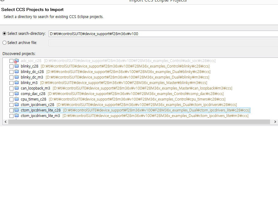

  • Currently you have a single project for the c28 core on the F28M36P63C2.  It generates a program to run on the c28.  You would need another project for the m3 core.
    If you want to load the output of that project onto the c28:
    select the c28 in the Debug View
    And then click on the Load Program button on the toolbar
    You can then select the .out that was generated by your project to load on the C28x core.

  • So i should select 2 project and build each and each Right?
    and that seems adc_soc_c28 has not m3 project
    and that's the end of our journey..
