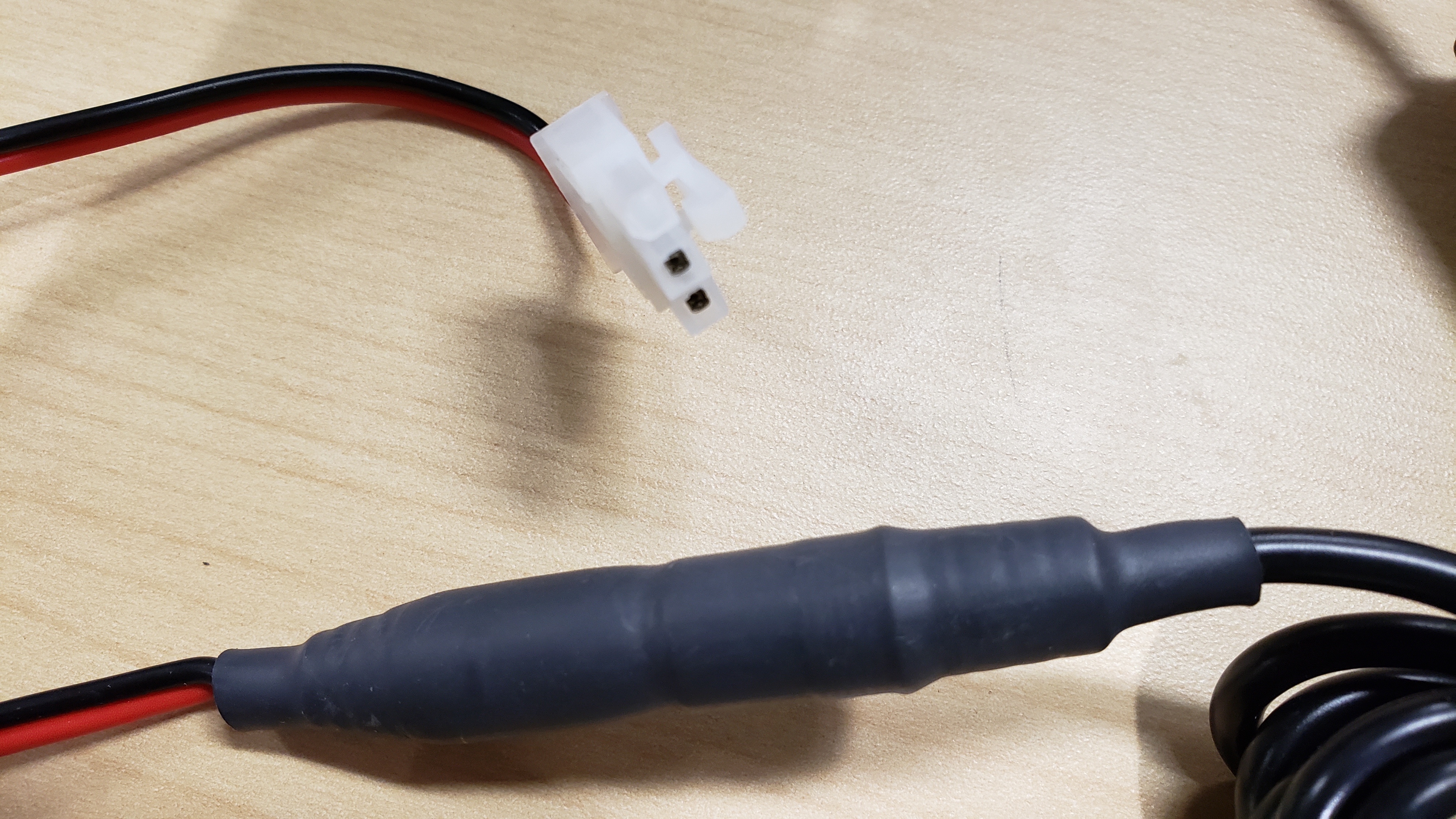

Hello Experts,
My customer bought TMDSEMUPROTRACE (www.ti.com/.../TMDSEMUPROTRACE but it doesn't contain power supply due to PSE. So they will buy a power supply for TMDSEMUPROTRACE. Can you please let us know the part number of power supply? We just found that TMDSEMUPROTRACE requires 12V/5A.
Ken
  • Ken,
    We do not have a specific part number for a power supply - instead we have a regular 12V/5.0A universal power supply with a barrel jack output and a small adapter manufactured at the assembly house.
    Our last batch used Volgen KTPS65-1250DT-3P-VI as the power supply with a standard 2.1mm inner diameter barrel jack DC plug.
    The connector on the probe is a Molex 39014030 fitted with two pins Molex 39000059 (reel) or 39000060 (bag).
    The polarity is shown in the photo above: pin 1 is Not Connected, pin 2 (center) is negative and pin 3 is positive.
    You can also see the barrel jack and its connector shrouded inside the shrink plastic. The connector is similar to a MCM 27-5996 or a CUI PR-002A and the cable is a pair of VW-1 rated (flame retardant) AWG18 wire.
