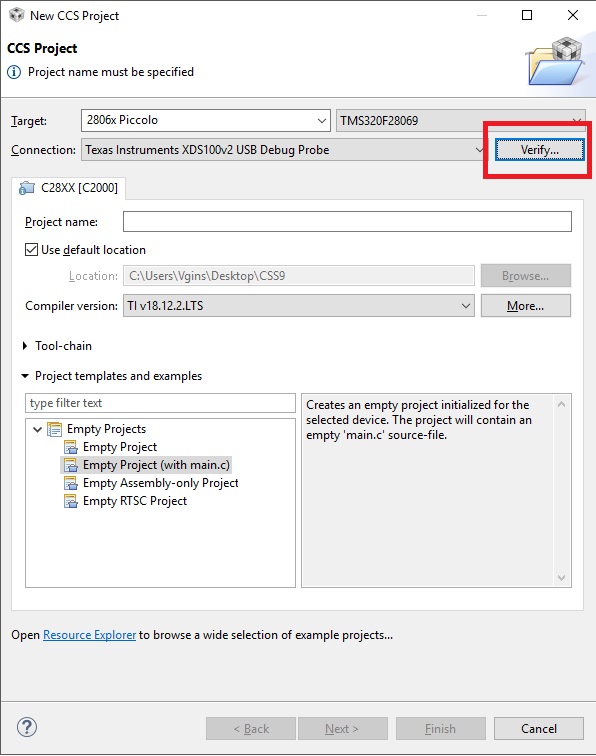

  I'm new to TI microcontrollers and so i have recently purchased new launchpad LaunchXL-F28069M. Now i have recently installed new laterst 9.0.1 CSS from TI website. After installing the CSS i connected my New Launchpad to USB port and try to open new project in CSS. After entering options as below:
  After i click Verify it gets failed... What is problem? How can i use my launchad?

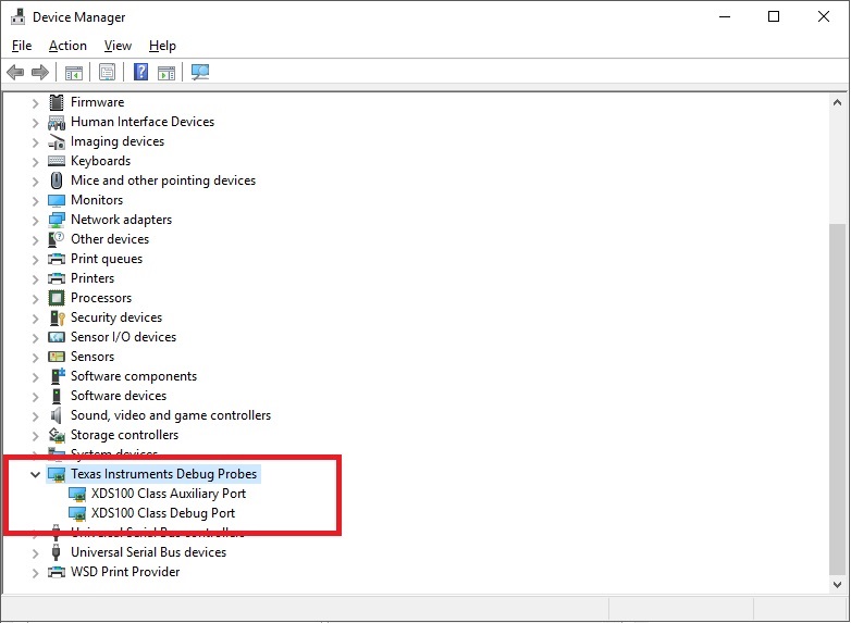

Device manager shows Launchapd installed Sucessfully. (See image)
My error after clicking verify is as follows:

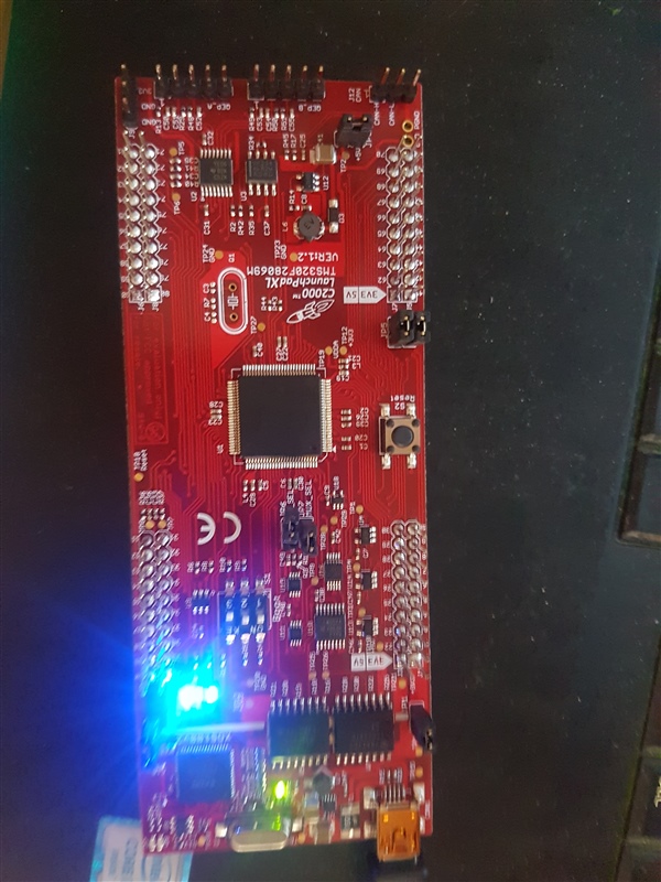

  • Dear Sir,
      Thank your for your quick reply... But i'm using the TI manufactured launchPad "LaunchXL-F28069M". I have not created my Own JTAG for communication. I connecting it directly to PC using cable provided by TI.
    See picture below:
      Now as per link you gave me it say my problem is
    • If the data read back is all ones (0xFFFFFFFF), it is possible that one of the JTAG lines has a short to VCC.
    Am i suppose to send card back? What am i suppose to do? Is the card defective?

    Thank you for sending the photograph. I sourced the same board here and found out that, if I leave S1-3 in the ON position just like you, I can reproduce the same problem.
    In this case, when I switched S1-3 to OFF I was able to connect.
    This is shown in Table 2 of the LAUNCHXL-F28069M Overview document at:
    www.ti.com/.../sprui11b.pdf
    Hope this helps,
