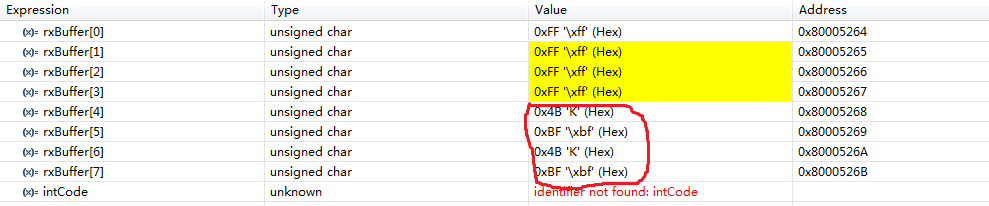

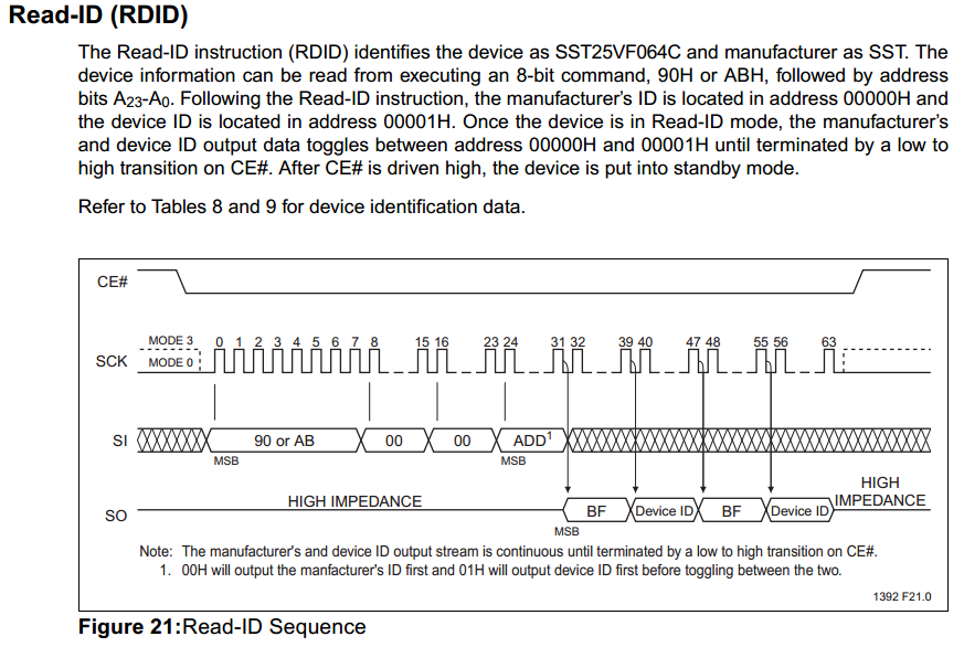

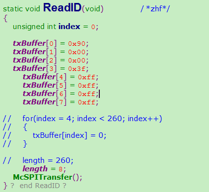

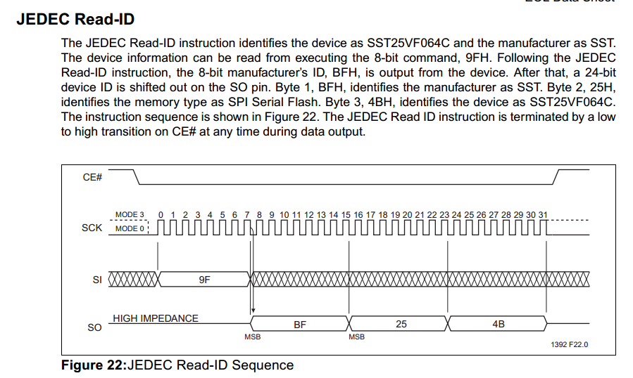

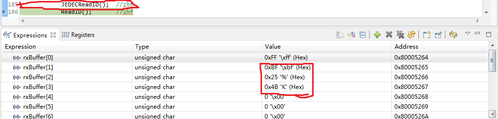

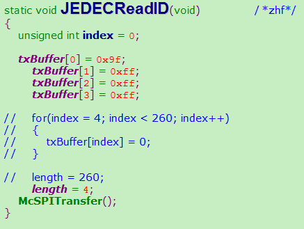

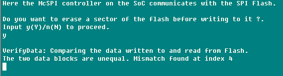

My board's cpu is am3354. The SPI FLash is SST25VF064C.I want to verify that spi flash works, so I simulated the board on CCS. The Starterware version I am using is AM335X_StarterWare_02_00_01_01. When I compile and run mcspiFlash.out, the serial port prints the information as follows:
Can you tell me why the data were verified failed?
I have verified that the spi flash on the board can be read ID normally.
  • Anyone give me some help?Thanks!

    The general guidance when migrating to custom board with custom flash device are as follows:
    1. Compare the flash device used on custom design with TI evaluation hardware. Users need to check for mode requirements (phase and polarity where data is sampled), compatibility of protocol and commands to read and write to flash
    2. From SOC perspective, is the clocking, pinmux for MCSPI configured correctly. If the clock and MCSPI instance/ chip select are different, you need to modify the code accordingly.
    3. Connect a scope to the MCSPI pins and check signal integrity, timing for chip select, clock and if the data appears correctly on the SPI lines.
    The flash writer is provided in source so users can single step and debug the code. to figure out the root cause. Debugging on custom HW is responsibility of the user as we don`t have access to the HW. If it helps, you should run the code on the TI evaluation HW so you know what to expect from the flashing software.
