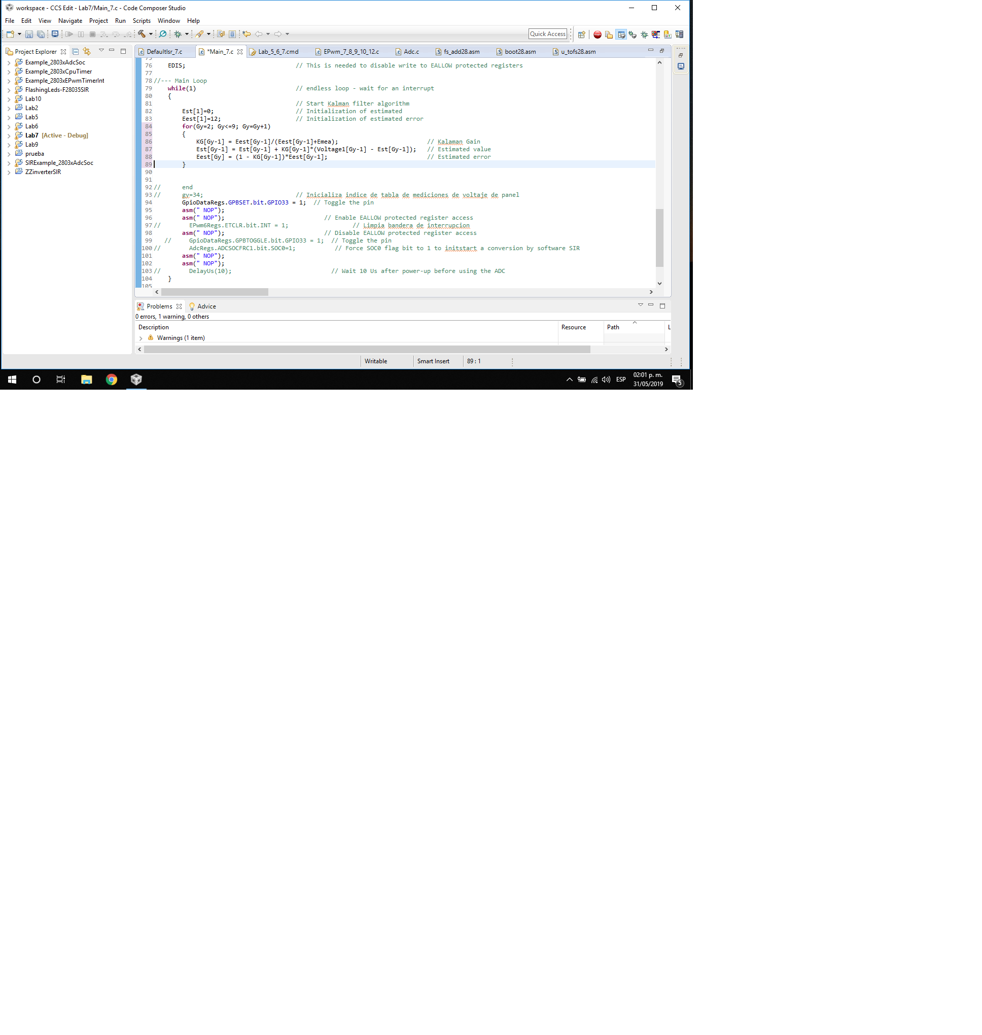

I have a issue with the debugger. I´m using the experimenter kit with the TMS320F28035 microcontroller. When I´m debugging my program and I try execution step by step in a secction where I´m making several calculus in the window of edition of CCS appears assembler files, then the execution step by step pass to the assembler file.
I don´t known what happen.
I send the screen view where I show the for cycle in my main program.

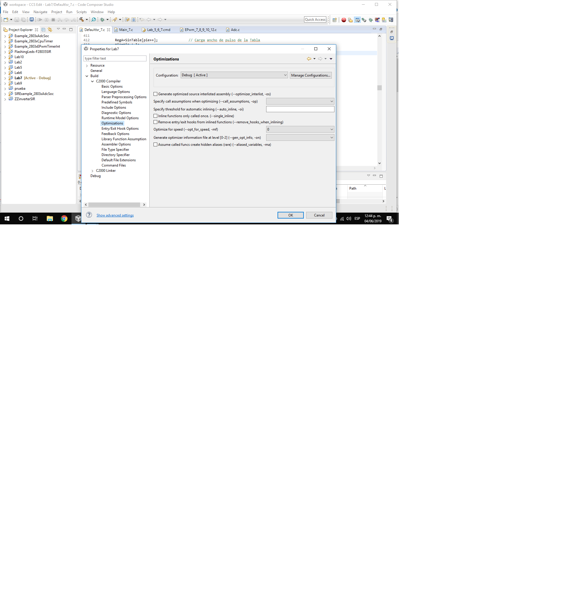

    I´m working with the CCS V.7. I modified the file where its my main program, specificaly, I have change the Optimize for speed from 2 to 5. Then I can debug my main program step by step.
    But, what i can do to that my project excutes correctly and I can debug all?
    I need develop a big program because I´m developing a photovoltaic inverter. My experience in C++ is litle, but I can study. In another projects I used assembly language and never had this kind of troubles with the develop tools.
    What do you recomend to me for make my job?
    Thank you very much in advance
    I assume that is for the --opt_for_speed option. But what is the --opt_level value?
    As mentioned in the article I mentioned in my last post, you can first try disabling optimization (set --opt_for_speed to off). This will give you best debug visibility. Make sure everything works as expected. Once you validated that it does, then you can enable optimization again.

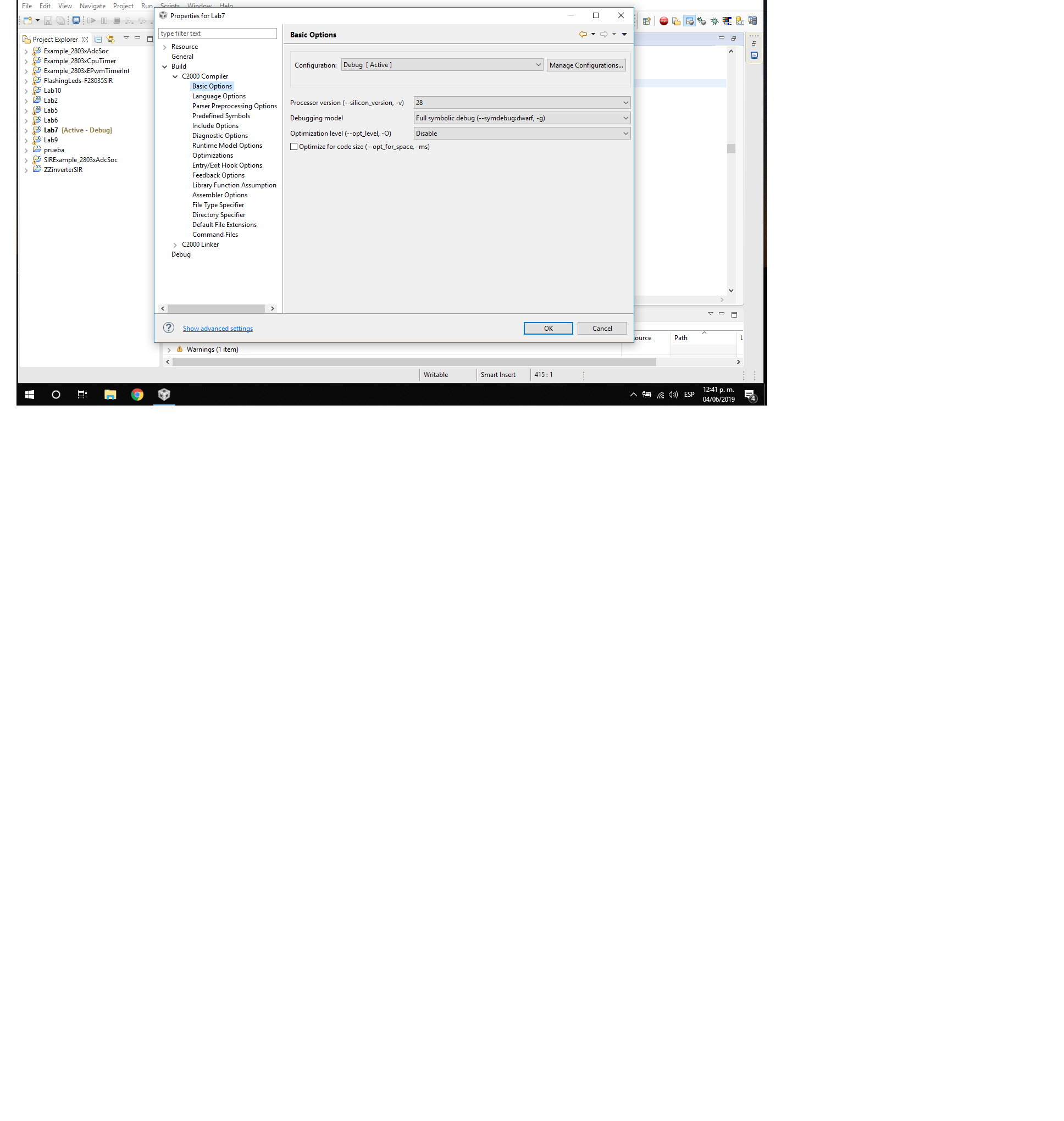

    Considering your advices I modified the --opt_for_speed from 5 to 0. Furthermore I reviwed the optimization level and this option is disabled.
    I send the screenviews of both options.
    I can´t debug my program because when I try execute the program step by step, the program counter go to the assembler programs.

    I source stepped through the main loop (lines 82 - 109 in Main_7.c) and did not have any issues. It stepped through the source lines the whole time. Can you explain in more details what behavior you see that is the issue?
  • Hello Ki,
    When I execute the program with a breakpoint in line 87. The CCS V.7, in the console window appears the following error: "C28xx: Breakpoint Manager Error enabling this function: This function cannot be accomplished with the existing AET resources. Then the program counter goes to an assembler file.
    Furthermore when I Build my program again and try debug the CCS doesn´t let me execute the program, because the butom of run it's disabling.
    Thank you very much.
    Sebastián...
    Ah! This is the key piece of information I needed. I understand the issue now.
    A HW breakpoint (which is required when setting a breakpoint in flash memory) uses up an emulation (AET) resource. On the 28x, there are very few of these resources. For example, 28x only has enough resources for 2 HW breakpoints. If you set more than two, you cannot set any more - and you will get that error you mentioned. Other things also use a AET resources under the hood. Another example is single source line stepping. This is because a single source step uses a breakpoint under the hood (it sets a breakpoint on the next line and runs to it). If you are single source stepping code in flash, then that would use a HW breakpoint. If you have no more AET resources, then you will not be able to single source step (which is why it forced you to an assembly step). Try removing that breakpoint on line 87 after you reach it. Once you remove it, you will likely be able to single source step without issue.
