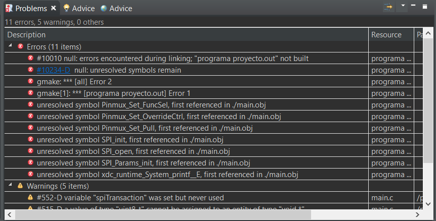

Hello i have the problem when I build my project im getting the next errors:
#10010 null: errors encountered during linking; "programa_proyecto.out" not built
#10234-D null; unresolved symbols remain
gmake:***[all] Error 2
gmake[1]:***[programa_proyecto.out] Error 1
unresolved symbol Pinmux_Set_FuncSel, first referenced in /main.obj
the liberies of the drivers are included in the file and i want to know if someone could help me with this errors

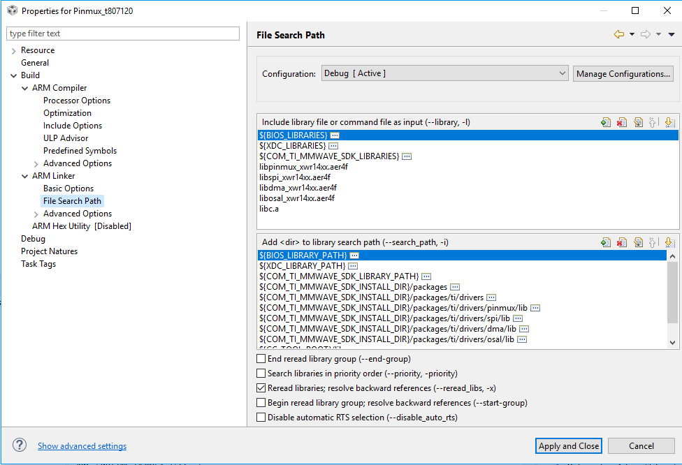

    please post your full Console output.
    My Console output shows no errors:
    **** Build of configuration Debug for project Pinmux_t807120 ****
    "C:\\ti\\ccs901\\ccs\\utils\\bin\\gmake" -k -j 2 all -O
    Building file: "../main.c"
    Invoking: ARM Compiler
    "C:/ti/CGT/ti-cgt-arm_18.12.2.LTS/bin/armcl" -mv7R4 --code_state=32 --float_support=VFPv3D16 -me --include_path="C:/TI_Trash/CCS901/Pinmux_t807120" --include_path="C:/ti/CGT/ti-cgt-arm_18.12.2.LTS/include" -g --diag_warning=225 --diag_wrap=off --display_error_number --enum_type=packed --abi=eabi --preproc_with_compile --preproc_dependency="main.d_raw" "../main.c"
    Finished building: "../main.c"
    Building target: "Pinmux_t807120.out"
    Invoking: ARM Linker
    "C:/ti/CGT/ti-cgt-arm_18.12.2.LTS/bin/armcl" -mv7R4 --code_state=32 --float_support=VFPv3D16 -me -g --diag_warning=225 --diag_wrap=off --display_error_number --enum_type=packed --abi=eabi -z -m"Pinmux_t807120.map" --heap_size=0x800 --stack_size=0x800 -i"C:/ti/CGT/ti-cgt-arm_18.12.2.LTS/lib" -i"C:/ti/CGT/ti-cgt-arm_18.12.2.LTS/include" --reread_libs --diag_wrap=off --display_error_number --warn_sections --xml_link_info="Pinmux_t807120_linkInfo.xml" --rom_model -o "Pinmux_t807120.out" "./main.obj" "../xwr1443_r4f.cmd" -llibc.a
    <Linking>
    Finished building target: "Pinmux_t807120.out"
    **** Build Finished ****

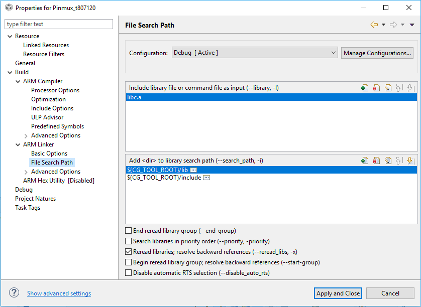

    Check linker file search paths. Should be like this:
  • Hello
    Here is what my console shows :
    **** Build of configuration Debug for project programa proyecto ****
    "C:\\ti\\ccs901\\ccs\\utils\\bin\\gmake" -k -j 4 all -O
    "C:/ti/ccs901/ccs/tools/compiler/ti-cgt-arm_18.12.2.LTS/bin/armcl" -mv7R4 --code_state=32 --float_support=VFPv3D16 -me --include_path="C:/ti/mmwave_industrial_toolbox_3_4_0" --include_path="C:/ti/mmwave_sdk_03_02_00_04/packages" --include_path="C:/ti/bios_6_73_01_01/packages" --include_path="C:/Users/victo/workspace_v9/programa proyecto" --include_path="C:/ti/xdctools_3_50_08_24_core/packages" --include_path="C:/ti/ccs901/ccs/tools/compiler/ti-cgt-arm_18.12.2.LTS/include" --define=SOC_XWR14XX -g --diag_warning=225 --diag_wrap=off --display_error_number --enum_type=packed --abi=eabi --preproc_with_compile --preproc_dependency="main.d_raw" "../main.c"
    "../main.c", line 136: warning #225-D: function "System_printf" declared implicitly
    "../main.c", line 142: warning #515-D: a value of type "uint8_t" cannot be assigned to an entity of type "void *"
    "../main.c", line 142: warning #551-D: variable "txBuff" is used before its value is set
    "../main.c", line 143: warning #515-D: a value of type "uint8_t" cannot be assigned to an entity of type "void *"
    "../main.c", line 143: warning #551-D: variable "rxBuff" is used before its value is set
    "../main.c", line 117: warning #552-D: variable "spiTransaction" was set but never used
    Building target: "programa proyecto.out"
    "C:/ti/ccs901/ccs/tools/compiler/ti-cgt-arm_18.12.2.LTS/bin/armcl" -mv7R4 --code_state=32 --float_support=VFPv3D16 -me --define=SOC_XWR14XX -g --diag_warning=225 --diag_wrap=off --display_error_number --enum_type=packed --abi=eabi -z -m"programa proyecto.map" --heap_size=0x800 --stack_size=0x800 -i"C:/ti/ccs901/ccs/tools/compiler/ti-cgt-arm_18.12.2.LTS/lib" -i"C:/ti/ccs901/ccs/tools/compiler/ti-cgt-arm_18.12.2.LTS/include" --reread_libs --diag_wrap=off --display_error_number --warn_sections --xml_link_info="programa proyecto_linkInfo.xml" --rom_model -o "programa proyecto.out" "./main.obj" "../xwr1443_r4f.cmd" -llibc.a
    <Linking>
    undefined first referenced
    symbol in file
    Pinmux_Set_FuncSel ./main.obj
    Pinmux_Set_OverrideCtrl ./main.obj
    Pinmux_Set_Pull ./main.obj
    SPI_Params_init ./main.obj
    SPI_init ./main.obj
    SPI_open ./main.obj
    System_printf ./main.obj
    error #10234-D: unresolved symbols remain
    error #10010: errors encountered during linking; "programa proyecto.out" not built
    >> Compilation failure
    makefile:141: recipe for target 'programa proyecto.out' failed
    gmake[1]: *** [programa proyecto.out] Error 1
    makefile:137: recipe for target 'all' failed
    gmake: *** [all] Error 2

  • Hello Victor,
    System_printf() comes with XDCtools.
    In your case I would create a new SYS/BIOS project with XDCtools support and dependent on the mmWave SDK version you need.
    Needed pimux, spi and other needed libs you would find using a scheme like on the picture below:
  • Hello
    This solve my problem, i need it the other libraries, thanks for your help
