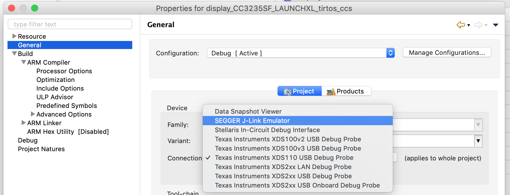

    Once you have imported an example from the SDK you can change the debug probe that it is configured to use.
    Right click on the project in the project explorer and select properties.
    The debug probe selection is here:
    Click on the connect field to change it to SEGGER J-Link.
