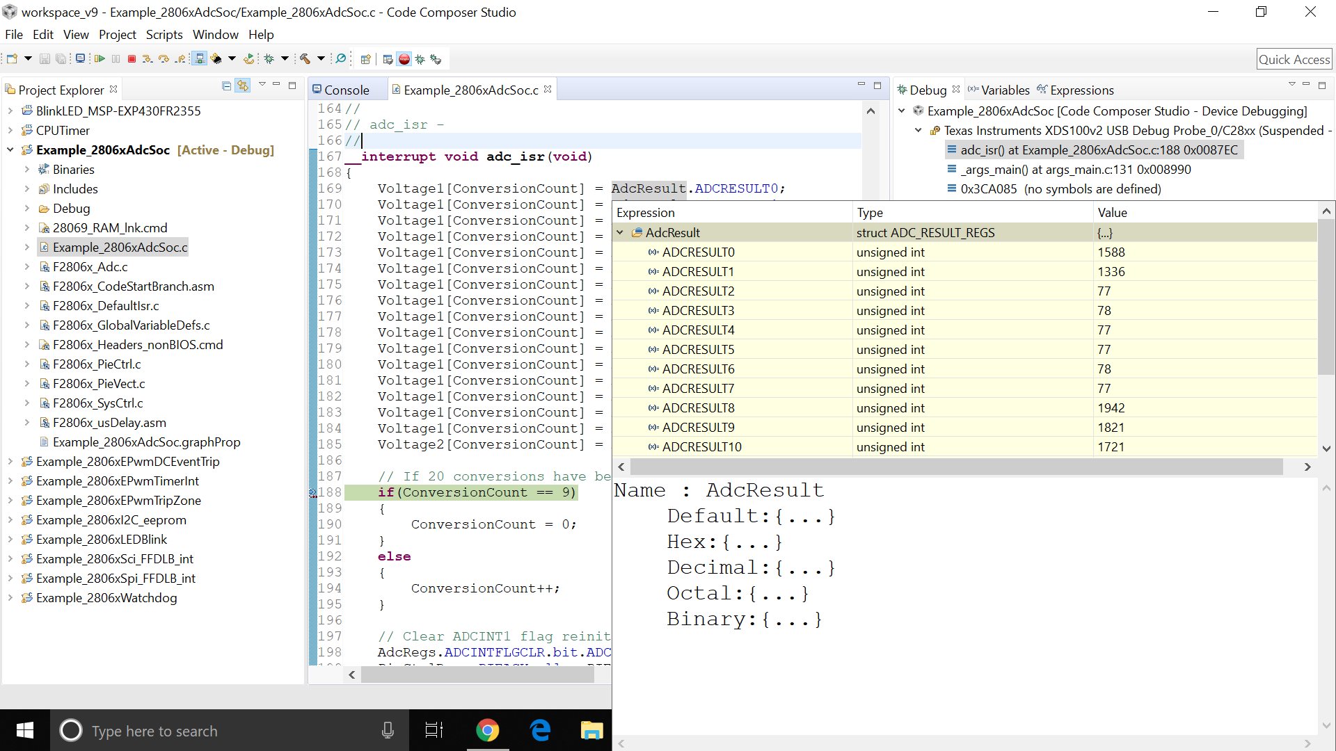

I have down loaded Example_2806xAdcSoc, and I have Launchpad LAUNCHXL-F28069M.
I compiled and ran program in debug mode successfully.
I shorted, J1-PIN-1 (+3.3V) and  J3-PIN-25 (ADCINA2), Expecting ADCResult1 will show Value 0xFFFFh.
I did not  get ADCResult1 = 0xFFFFh.
I tried to see all ADCResult0 To ADCResult15, and I got none of them equal to or near by value 0xFFFFh, by pacing cursor over line,
Voltage1[ConversionCount] = AdcResult.ADCRESULT0; and word ADCRESULT0 To ADCRESULT15.
My Program Example_2806xAdcSoc.C is as follows.

  • Thanks for quick reply,
    Launchpad LAUNCHXL-F28069M, Device Selected TMS320F28069.
    Code Composer studio Version: 9.0.0.00018.
    Compiler Version TI v18.12.2.LTS.
    Texas Instruments XDS100v2 USB Debug Probe. Connection Verified OK.
    Windows 10, 64-bit, Service Pack V4.
    Normally My computer automatically update service pack, so I think it is latest update.
    I am re pasting code as suggested by you.

  • Dear Sir Tom,
    I am attaching my screen shot file.
    See my Code, I used the calibrations,
    AdcOffsetSelfCal(); , as given in Example_2806xAdcSoc.c
    One more clarification, I have CODE_COMPOSER_STUDIO_V9 and Not CODE_COMPOSER_STUDIO_V8.
  • Vijay,
    The example code will only populate ADCRESULT0(from ADCINA4) and ADCRESULT1(ADCINA2).  The other ADCRESULT registers are not relevant, some have leftover data from the calibration function that is executed before main.
    Sampling a LDO output with a higher bit ADC(like this one) is a tricky proposition as likely there is not very good buffering in addition to noise from the supply rail.  With that said you should see something above mid code:
    ADCINA2 and ADCINA4(as well a ADCINA6) are special analog inputs in that they are also connected to the internal comparators simultaneously to the ADC.  When properly driven, there would be little to no evidence on the ADC Result to the above, however, using the LDO output there may be some artifacts of the hystersis circuit showing up.  We can discuss how to work around this later if needed.
    I recommend shorting ADCINA1 to the VDDIO rail, and changing the below lines so that ADCINA1 is sampled both times to ADCRESULT0 and ADCRESULT1
    AdcRegs.ADCSOC0CTL.bit.CHSEL    = 1;   // set SOC0 channel select to ADCINA1
    AdcRegs.ADCSOC1CTL.bit.CHSEL    = 1;   // set SOC1 channel select to ADCINA1
    Additionally the ISR function used to capture values will only capture ADCRESULT15 to the Voltage1 array and ADCRESULT4 to the Voltage2 array, both of which are invalid.  You can remove the extra reads and just use ADCRESULT0 to VOLTAGE1 and ADCRESULT1 to VOLTAGE2
