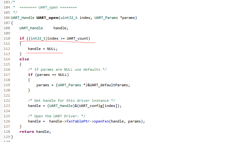

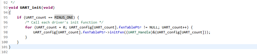

Is the callback function an error?
Thank you for your reply. It is my carelessness that I did not notice the accumulation of UART_count in the for loop.Now UART_count = 2 after the loop is complete.
