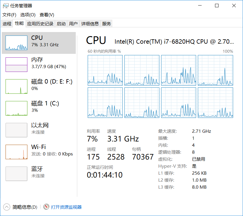

  • Hi Ki and Tom,
    I will give your comments to my customer. They are using workstation so generally a too slow build should have some problem.
    They find one interesting thing that CPU usage in the "slow build machine" is always less than 10%.
    BTW, I have let them disconnect from any network to have a try. This make no difference with the "slow build machine" in rebuild operation.

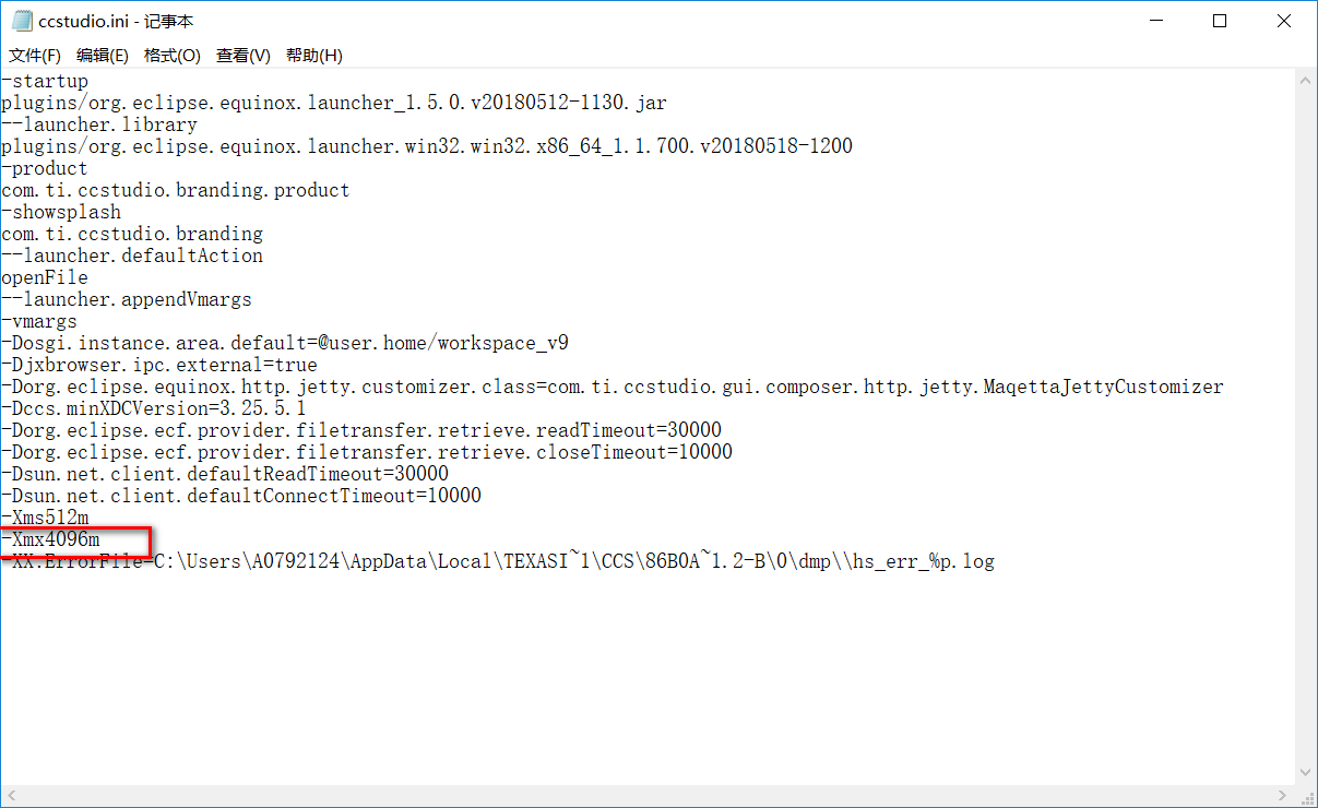

  • Hi Tom,
    They have had value as 768, after they changed to 4096 nothing improves. Do you have any comments?
    Sheldon

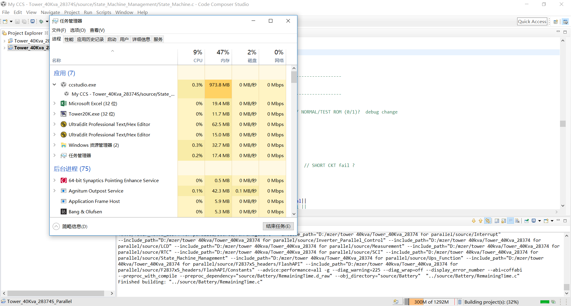

  • Hello Sheldon,
    what memory usage the CCS java heap monitor shows?
    4 GB allocation is much to high, probably.
    Do they use parallel builds on slow PCs?
    Do they have HDD or SSD?
    There is a recommended value that varies per PC. On CCSv8, you don't want to go higher that 1024m. On CCSv9, you have more room but you likely don't need to go over 2048m
    Did the customer check their parallel build setting?
