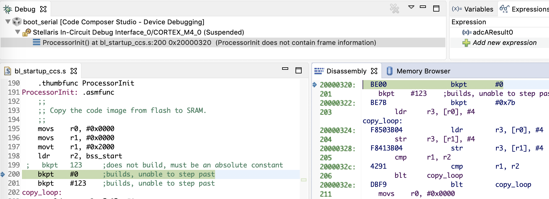

I'm using CCS 8.1.0.00011 and have the issue mentioned in the linked question from 2014 wrt CCS 5.5 and CCS 6 where a BKPT instruction with a non-zero parameter does not allow the debugger to step over the instruction.
Is there any plan to fix this bug? Like the poster of the original question I'd like to be able to use non-zero BKPT parameters to distinguish software breakpoints inserted in different places in my code.
If it is important I'm working with TM4C129 family processors.

    I have tried this out on MSP432E401Y and TM4C1294.
    Which compiler are you using? Using the TI compiler I can't build without the #.  However even if I do BKPT #123 I am not able to step over the instruction.
    When working with the Cortex A device in the other thread I would have been using GCC.
    Regardless I think there is a bug here.
    John

  • Here is a summary of what I see.  I changed my compiler to be the same as yours.
        bkpt 123 ;does not build, must be an absolute constant error
        bkpt #0  ;builds, unable to step past
        bkpt #123 ;builds, unable to step past
    Are you able to step past bkpt #0?
    I am using the latest CCS I am going to setup 8.1.0 to see if I can step past bkpt #0 in that.
    John
  • In CCSv8.1.0 I see the same as in v9.  I can't step past any bkpt instruction.
    I will update the bug report as to me this is worse.
