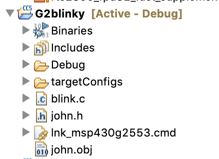

    One way of doing this would be as follows:
    Make a copy of your project so you don't lose anything
    Here in this project you can see that I have blink.c and john.c
    Inside my Debug folder will be the object files for each of my source files.
    What I did next is I dragged john.obj into the root of my project.  Now John.obj is a source file for my project and I then deleted John.c (safer at first to just exclude John.c).
    I can build this project fine.  I can now share it and not be giving the C source to the contents of John.c

  • Hello!
    Though sharing specific object file may work, rational way of doing this job is to create a library. This way you have to create separate project with output type static library, move your sources there and produce the library. Once built, you may as use it in your projects, so share with customers. This way we obtain shared code from TI, lie DSPLIB and so on.

  • rrlagic's suggest would be the proper way to do it.  Swapping in the .obj file is a quick method but building a library is better.
    I see that you mentioned .pjt files in your reply.  Are you using CCSv3.x?  I don't know that my method would work in that version as it is a completely different build system.  You would likely have to add the .obj file to the items being passed to the linker via the project options.
