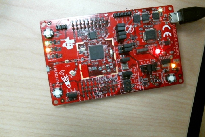

  • Hassan,
    Did you change the jumpers on the CC3200 LaunchPad in order to program the serial flash via the Energia IDE?
    CC3200 is a bit different than most of our MCUs.  The flash memory here is not your usual on chip flash it is serial flash.
    From within CCS Cloud if you try to create a new Energia Sketch and select the Blinky example under Basics what is the error message that you get when you launch your debug session?
    Here are what my jumpers look like.  Not that J8 is on (near the top of the picture) and none of the SOP jumpers (bottom of picture) are on.
    John

  • Good day John,
    I didn't change jumper settings. The jumper setting for yours in the figure is the same as mine except for J8 that it is without jumper for the sake of programming (connecting J8 to J2).

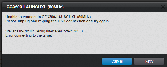

    I tried the Blinky example, the matter is that neither debug or run can proceed as connection to the target can't be made. Stellaris In-Circuit Debug Interface/Cortex_M4_0 reports "Error connecting to the target".

  • Hassan,
    Please add the jumper to J8.
    If I remove J8 I get:
    Add the jumper back and you will be able to connect and program the device in CCS Cloud
    CCS is not able to program the serial flash on this device. That little trick of connecting J2 to J8 will not work.
    John
  • John,
    You are correct. By replacing J8, it correctly works.
    It should say it is yet confusing, as it was working before by connecting J8 and J2 as we see in online documents.
