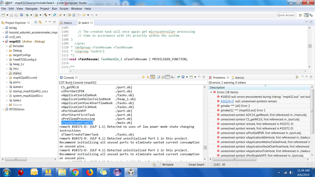

I am using CCS V8 for programming the msp432p401r with FreeRTOS. When I am build the module I am facing the link error.

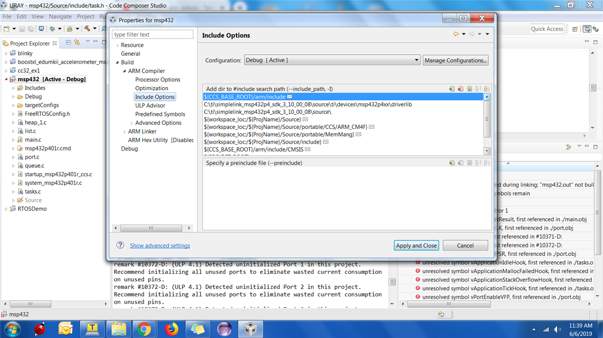

I have gone through the every link provided for the similar issues and have already done all including the files and etc.
I have followed the http://processors.wiki.ti.com/index.php/Include_paths_and_options also  which did not give me the answer I am attaching the snapshots of the project below
There are no library files only clear .c and .h files and c functions which I am trying to integrate.
Thanks in advance,
Basu
    unresolved symbols are not related to the includes list, they are related to the linking process and needed libraries.
    Please, post your full Console log.
    Which  Free-RTOS version do you use?
    Did you defined the FREERTOS_INSTALL_DIR mandatory variable?
    The vApplicationIdleHook() is a user defined function.
    You need to implement it!
    The same with the vApplicationMallockFailedHook.
    Tom is correct. You are getting a linker error, not a compiler error.
    Please see:
    http://software-dl.ti.com/ccs/esd/documents/sdto_ccs_build-errors.html#error-unresolved-symbols-remain
    Yes, you either need to implement it or include the object file that defines/implements it.
