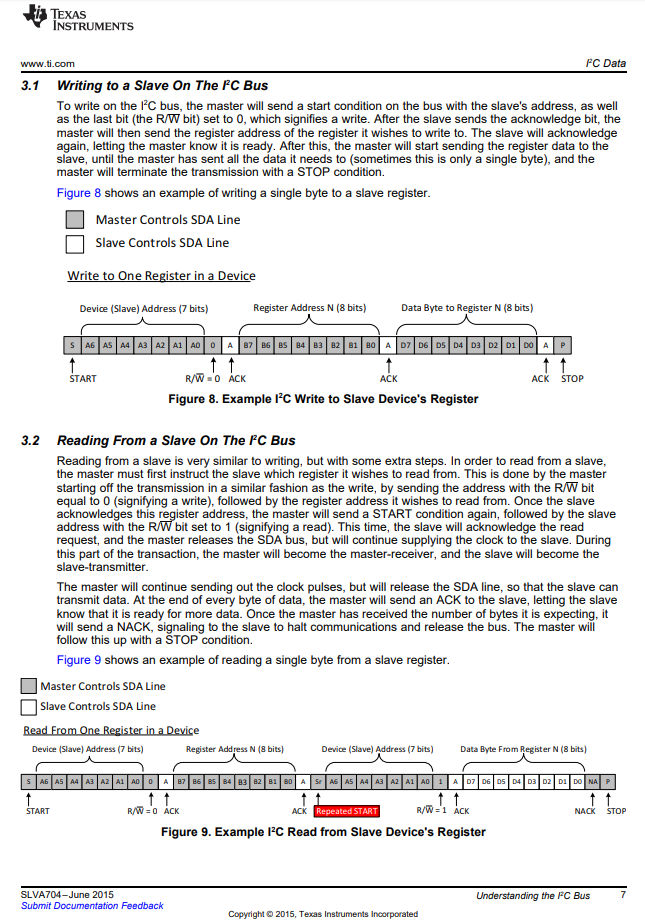

I have been trying to interface AS7262 Spectrometer module with CC2640R2F Launchpad. It has an I2C interface. I am using i2ctmp116 driver example for interfacing the spectrometer.
I am successful in interfacing it with CC2640 but I am getting 0 as received data from the sensor. I think I am doing something wrong with registers initialization. Below is the data sheet for as7262 and code used by me.
https://cdn.sparkfun.com/assets/f/b/c/c/f/AS7262.pdf

I2C_Params_init(&i2cParams1);
i2cParams1.bitRate = I2C_400kHz;
i2c1 = I2C_open(Board_I2C_TMP, &i2cParams1);
txBuffer1[0] = 0x81;
txBuffer1[1] = 0x01;
i2cTransaction1.slaveAddress = 0x49;
i2cTransaction1.writeBuf = txBuffer1;
i2cTransaction1.writeCount = 2;
i2cTransaction1.readBuf = rxBuffer1;
i2cTransaction1.readCount = 20;
I2C_transfer(i2c1, &i2cTransaction1);
I2C_close(i2c1);
I2C_Params_init(&i2cParams2);
i2cParams2.bitRate = I2C_400kHz;
i2c2 = I2C_open(Board_I2C_TMP, &i2cParams2);
txBuffer2[0] = 0x02;
txBuffer2[1] = 0x28;
//txBuffer2[2] = 0x0;
i2cTransaction2.slaveAddress = 0x49;
i2cTransaction2.writeBuf = txBuffer2;
i2cTransaction2.writeCount = 2;
i2cTransaction2.readBuf = rxBuffer2;
i2cTransaction2.readCount = 20;
