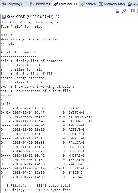

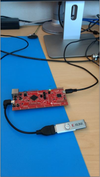

Hi all,
I'm programming on TM4C1294NCPDT for read data.txt file.
But when I try with example usb_host_msc, Revision 2.1.4.178 of the EK-TM4C1294XL Firmware Package, just one of all USB device connected(via UART)
The remainning devices, it stuck in USBHCDPipeWrite function, at USBHCDPipeWrite, at line 1564 (Wait for a status change while(1)).
And, if USB device was plugged more than about 15 seconds, when I unplugged, the UART show: Mass storage device disconnected,otherwise it not.
