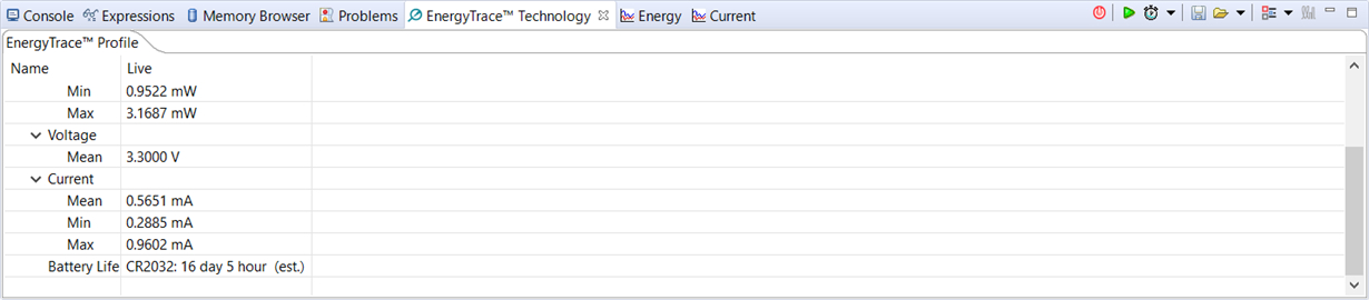

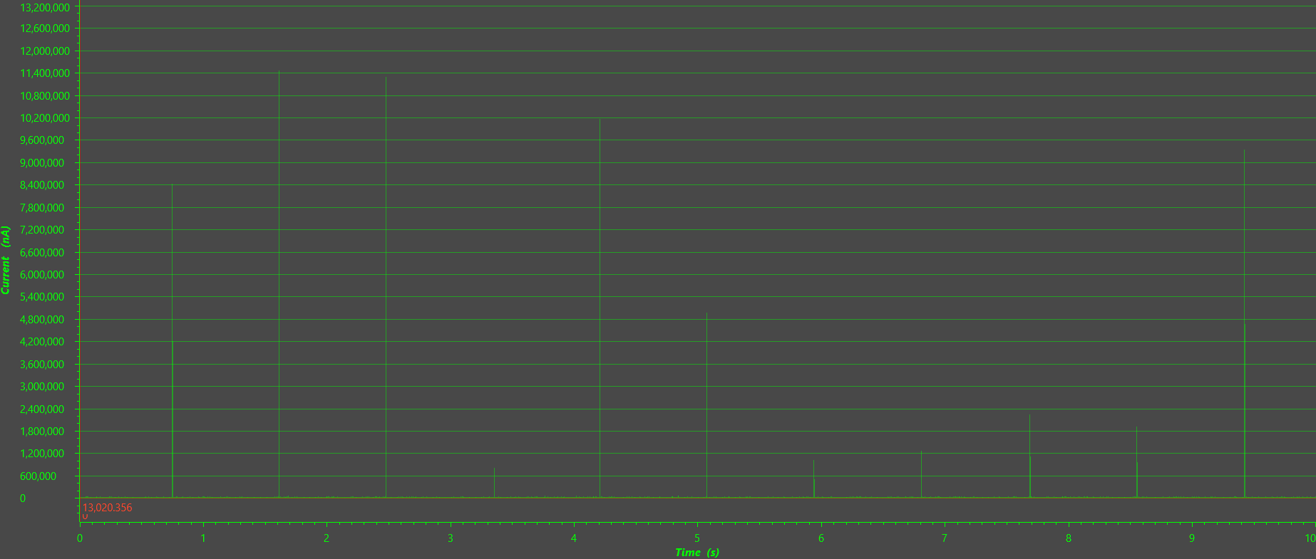

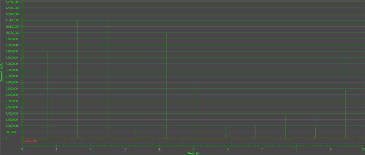

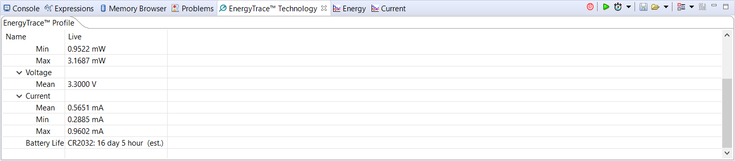

    When i'm trying to use Energy trace to estimate the current consumption, I found that in sleep mode, the current is always around 275uA.

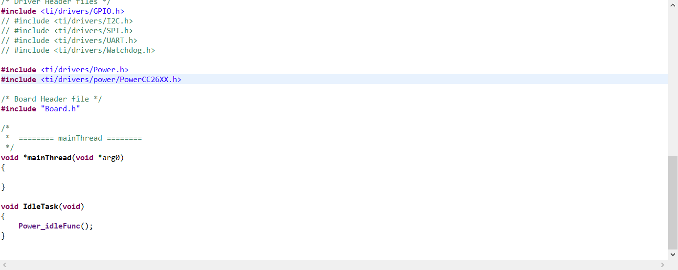

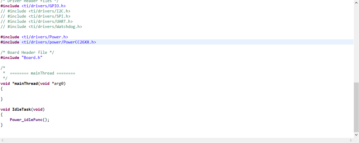

    Then I imported the empty project and deleted the LED blinking code. Besides, I added a Idle task and put Power_idleFunc(); Into the Idle task.
    However, the current is still around 275uA.
    The screenshot shows my edited edition of empty project and the current from EnergyTrace.
