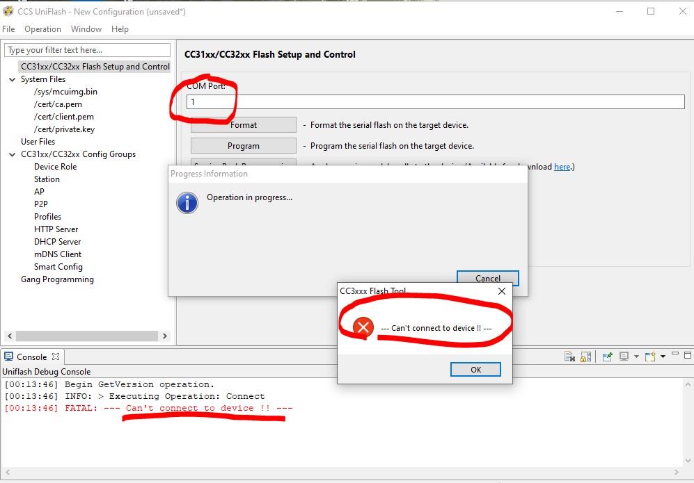

Hi TI Development,
It very hard time to get uniflash visible on COM Port on windows 10 see below error receiving. I do have COM Port visible on device Manager but showing hardware device is not connected to the computer. (Code 45)
Please help!
    It seems you are using Uniflash 3.4.1, which is the last version to support CC3200 devices.
    That said, can you be sure the SOP jumpers on your Launchpad are properly configured for Flashing? Consult the board's documentation for details.
    Hope this helps,
    Rafael

  • Hi Amit,
    Please make sure that you have selected correct COM port number. Please provide screenshot from device manager with list of you COM ports.
    Uniflash version 3.4.1 works with Windows 10 without any issue. I have tested version 3.4.1 with following builds of Win 10:

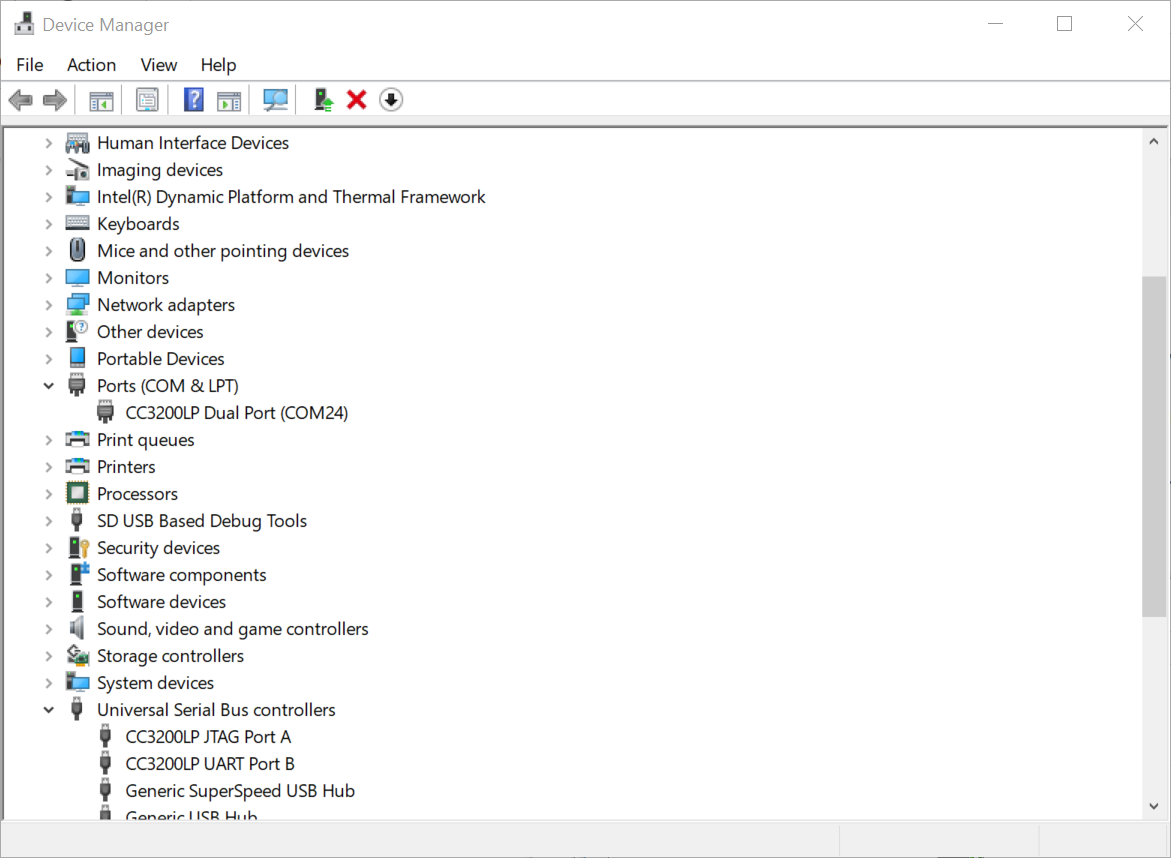

  • COM port number 1 does not look as correct value.
    Check device manager. It should say like this: CC3200LP Dual Port (COMxx)
    As Tom and Jan mentioned, check for the following in your system.
    Also, the board should be populated with the UART signals set to Flash and a single jumper on SOP2. This is mentioned on sections 2.4.4 and 2.4.5 of the CC3200-LAUNCHXL User's Guide:

  • Thanks my device able to connect to COM port now but is there any way to bump up the flash memory? I am seeing below issue. Please suggest.
