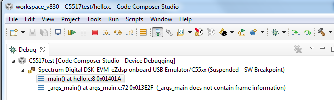

    I managed to find a 5517 EVM.  It definite has the Spectrum Digital eZdsp debug probe on it.
    When I connect the 5V power supply and connect the USB cable (opposite corner from the power supply) labelled EMU USB I get a red LED by the power connector and a green LED near the Spectrum label (DS2).
    In device manager I see:
    So that is what you want to see vs the unknown device.
    I am then able to create a simple project in CCS and load it onto the device:
    Try to use a short USB cable that makes a solid connection.  Avoid using a USB hub.
    Worst case there is a JTAG header next to the USB connection and a cheap debug probe like an XDS100v2 could be connected to.  I tried an external XDS100v2 and that worked fine.  I was also able to use the newer XDS110.

    Thanks so much for all your help. Turns out the driver files were not in the correct location. The Spectrum Digital installation put the drivers in a folder in the Program Files that I did not notice. I was able to run the demo just as you did above once I updated the driver for the device by searching in that specific folder.
    Thanks again,
    Kira
