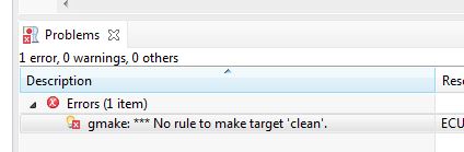

I need to dstribute a program and the final user have only CCS installed. I cannot deliver the source code.
So, I need to load the .out file without build it.
Of course, I have uncroos the option in workspace preferences
But it seems that it is not working.
And it seems to be a build problem:
Is there another option for loading a file without building it.
