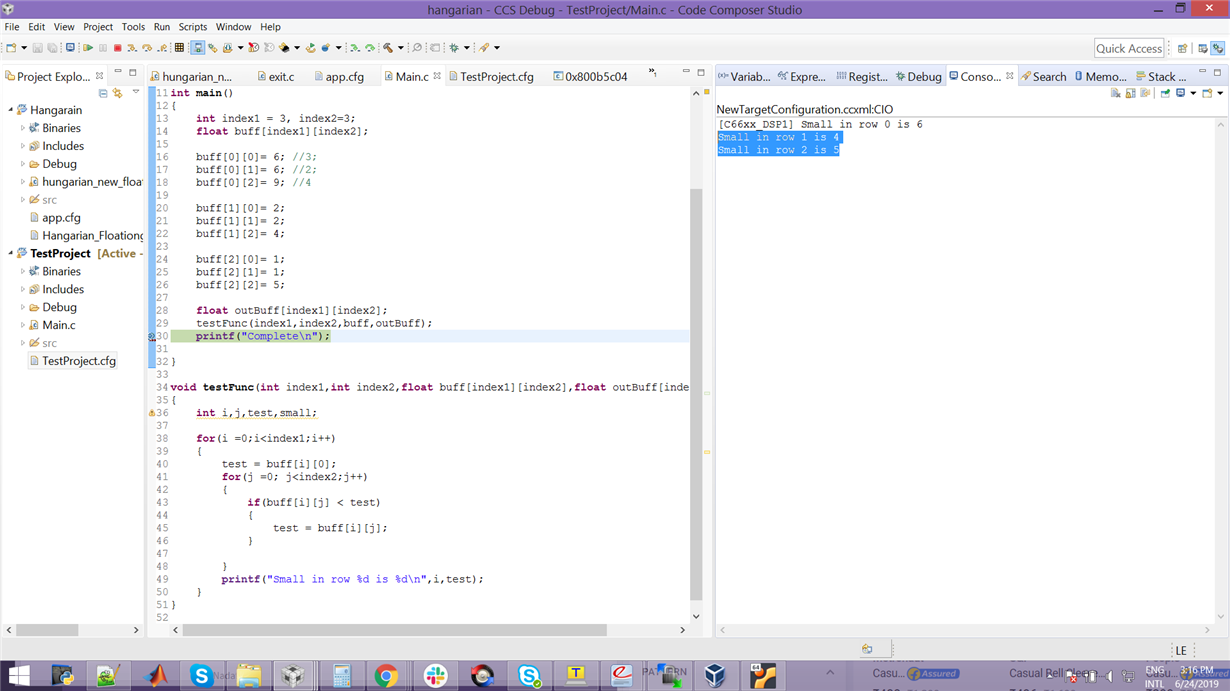

hi,
with the following type of function declaration CCSv7 is not giving any build error, but CCSv6 gives up build error.
#include<stdio.h>
void testFunc(int index1,int index2,float buff[index1][index2],float outBuff[index1][index2]);
int main()
    int index1 = 3, index2=3;
    float buff[index1][index2];
    buff[0][0]= 6; //3;
    buff[0][1]= 6; //2;
    buff[0][2]= 9; //4
    buff[1][0]= 2;
    buff[1][1]= 2;
    buff[1][2]= 4;
    buff[2][0]= 1;
    buff[2][1]= 1;
    buff[2][2]= 5;
    float outBuff[index1][index2];
    testFunc(index1,index2,buff,outBuff);
    printf("Complete\n");
    int i,j,test,small;
    for(i =0;i<index1;i++)
        test = buff[i][0];
        for(j =0; j<index2;j++)
            if(buff[i][j] < test)    //error seen here
                test = buff[i][j];
        printf("Small in row %d is %d\n",i,test);
IN CCSv7: following is the behavior seen
In  the above code the expected result had to be
[C66xx_DSP1] Small in row 0 is 6
Small in row 1 is 2
Small in row 2 is 1
Complete
but the output seen is as follows.
Small in row 1 is 4
Small in row 2 is 5
Complete
in the above code , inside testFunc the if condition is failing for the 2nd and 3rd row. Can this be explained?

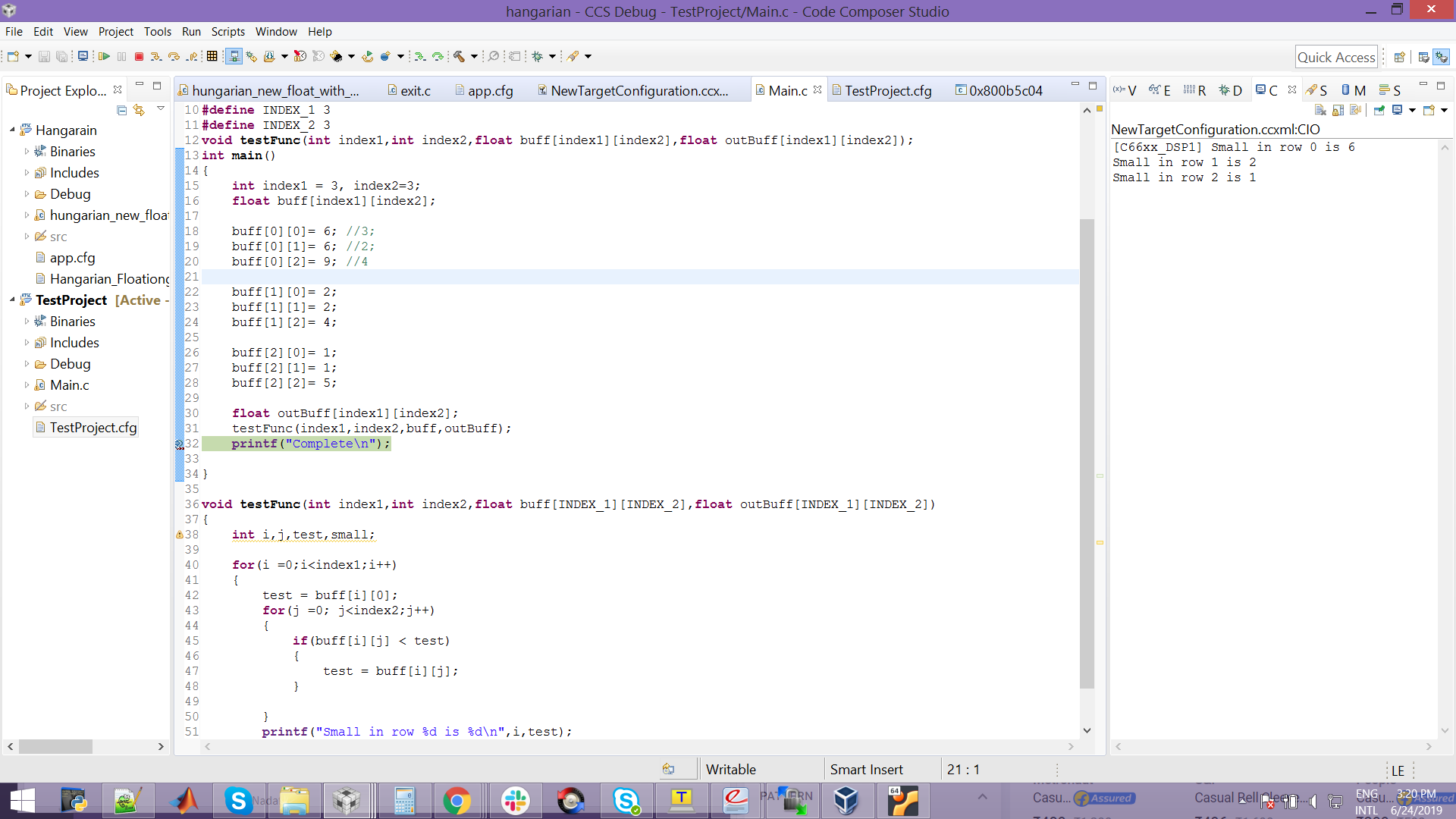

but when ,
is replaced with
void testFunc(int index1,int index2,float buff[INDEX_1][INDEX_2],float outBuff[INDEX_1][INDEX_2])
where INDEX_1,INDEX_2 are macros ( #define INDEX_1 3  , #define INDEX_2 3)
the code works fine and i get the expected output.

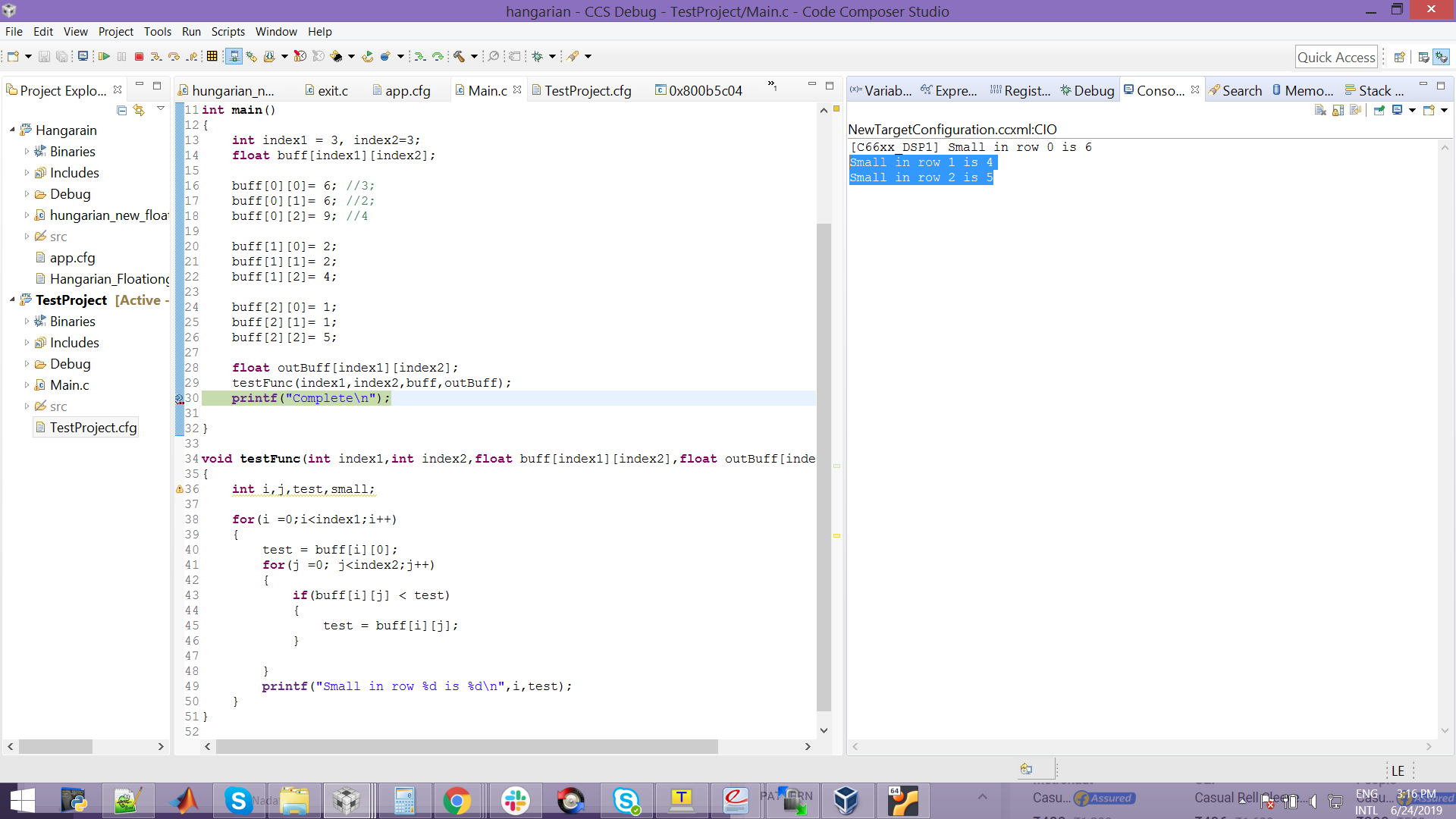

    Thank you for the reply.
    I have attached the screenshot of the console for both the cases.
    1) Working Case with the macros
    2) If condition Fail case
    Asha

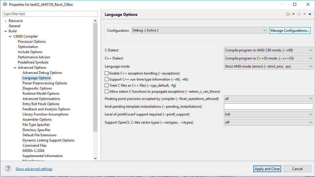

  • Asha,
    in both cases you use ti-cgt-c6000_8.2.2.
    cgt v8.2.2 uses ANSI C89 with relaxed ansi mode as default.
    If you use compiler setting like on the following picture:
    you would get the following errors:
    Building file: "../main.c"
    Invoking: C6000 Compiler
    "C:/ti/CGT/ti-cgt-c6000_8.2.2/bin/cl6x" -mv6600 --include_path="C:/TI_Trash/CCS901_MSP430P401R/test02_AM5726_RevA_C66xx" --include_path="C:/ti/CGT/ti-cgt-c6000_8.2.2/include" --define=am5726 --define=core1 -g --c89 --strict_ansi --diag_warning=225 --diag_wrap=off --display_error_number --preproc_with_compile --preproc_dependency="main.d_raw" "../main.c"
    >> Compilation failure
    subdir_rules.mk:9: recipe for target 'main.obj' failed
    "../main.c", line 3: error #413: a parameter is not allowed
    "../main.c", line 11: error #28: expression must have a constant value
    "../main.c", line 13: warning #2581-D: '//' comments are not allowed in strict C89 mode
    "../main.c", line 30: error #413: a parameter is not allowed
    "../main.c", line 32: warning #179-D: variable "small" was declared but never referenced
    10 errors detected in the compilation of "../main.c".
    gmake: *** [main.obj] Error 1
    gmake: Target 'all' not remade because of errors.
    **** Build Finished ****
    All the above is because C supports variable sized arrays from C99 standard.
    Thank you for the solution.
    Can i know which ti cgt version supports C99 standards ??
    Asha
  • Check options under "C Dialect" present on the picture from my previous post.
