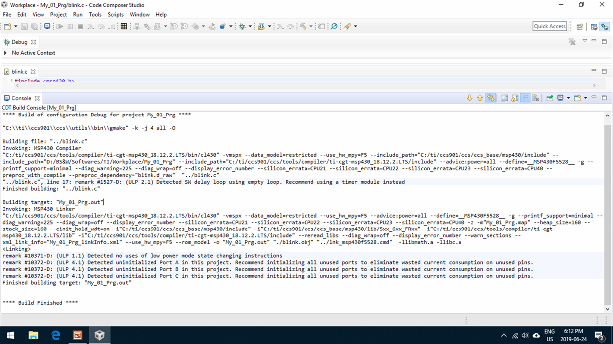

I am going to do my own application program to control FDC2214EVM. I was following the CCS user guide to start my first test project "Blink the LED" with the FDC2214EVM, and ended up with "No USB FET was found". The CCS is version 901, and my operating system is Win10. I am including the error screenshots and problem remarks. The USB connection was proper as the sensor solution GUI works fine with data-streaming.
I also followed a few troubleshooting steps found on TI web and still not able to get rid of the issue. Could someone help with it?

    I believe your problem is that the FDC2214EVM does not have debugger hardware, which is what the code is looking for. Section 3.1 of this application note discusses that hardware. If you look at your COM ports in Device Manager, you will only see the EVM and no debugger. We have some python sample code available to talk to the MSP430 on the EVM directly.
