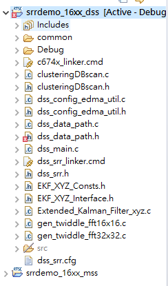

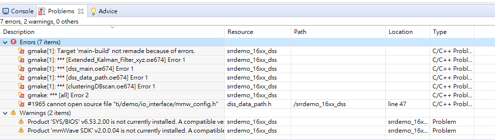

I use CCS v9 Build ssrdemo_16xx_dss and ssrdemo_16xx_mss
IDE OUT a error
How can I fix the problem?
IDE OUT a error
Read warnings.
Install mmWave SDK v2.0.0.04 and try again.
