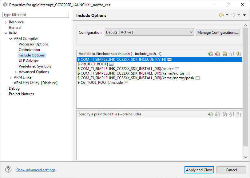

But I am getting the following error while compiling even after describing the resource path location,
Description Resource Path Location Type
#1965 cannot open source file "ti/drivers/utils/List.h" .ccsproject /led line 358, external location: C:\TI\simplelink_cc32xx_sdk_3_10_00_04\source\ti\drivers\Power.h C/C++ Problem
I have also attached the screenshots of the error.
    In your screenshot it seems that you tried adding the entire path to the #include. Instead the recommended solution is to leave the #include in Power.h as it originally was (#include <ti/drivers/utils/List.h) and add the path to it to the project's compiler include path option.
    Also it appears that you are trying to create a new project from scratch using the New Project wizard in CCS. If so, I would recommend against that and would suggest starting instead with one of the example projects from the SimpleLink SDK. The SDK includes many examples, you could pick one closest to what you want to do, and modify it to suit your needs. The reason we recommend this is that the example projects already have the appropriate source/header/linker command files added to the project and also have the relevant compiler include paths and linker libraries and paths already set. To start a project from scratch would take a lot more effort and understanding of the files and libraries to achieve the same result.
    For example, this is what the compiler include path is set to in the gpiointerrupt example. Note the path ${COM_TI_SIMPLELINK_CC32XX_SDK_INSTALL_DIR}/source. This path combined with the path in the #include statement should correctly resolve the path to List.h and avoid that compiler error.
