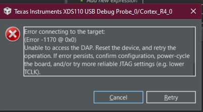

unable to access the DAP
Part Number: IWR1443
Other Parts Discussed in Thread: AWR1443BOOST
Hello
I try to debugg the demo for the IWR1443 of High accuracy on my own desing board but i get the next error and when I do the connection test it say that the JTAG is fine.

    The screenshot did not go through. If you are having any connection errors reported by CCS, please search for the error number at the Debugging JTAG page below to get additional details:
    http://software-dl.ti.com/ccs/esd/documents/ccs_debugging_jtag_connectivity_issues.html

    I try everything this thread said and I dont find the problem, could you look again, the image is up now
    Cheers
    Error -1170 is described in the page I sent before, and is usually tied to a problem with the status of the device - something the "Test Connection" would not catch.
    I tested my AWR1443BOOST with CCSv9.0.1 and it worked well, thus ruling out anything inherently wrong with the tools.
    Therefore, my other suspicion with this particular board is the position of the SOP jumpers - depending on how they are populated, you will have issues connecting to the device. Check the board User's Guide for details.
    One last detail is a possible issue with pre-loaded firmware. If code previously flashed to the board is somehow faulty (continuously resetting the device or putting it in power down mode) or contains any security procedure by design (block any JTAG access), you will have to follow the procedure to erase the serial flash. The board User's Guide contains details about that.
