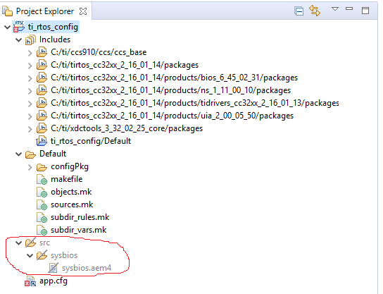

  • Good day Tom,
    Following your suggestion, I created a new workspace for CCS 9.1 and only imported ti_rtos_config from CC3200SDK_1.4.0.
    To be detailed, I set the compiler version to TI v18.12.2.LTS; XDCtools version: 3.22.2.25_core; TI-RTOS for CC32xx to 2.16.1.14.
    This still generates the same errors. The generated log in console shows the error in the following.
    I want to highlight something that is questionable to me. Under Project Explorer in the following picture, why src folder is gray? Can't this be the root of problem?
    Thank you,

  • Please take a look at this FAQ: https://e2e.ti.com/support/tools/ccs/f/81/t/786662
    If you follow the link to the CCS Build errors page, there are some solutions listed there. I suspect your issue may be related to item #2 - conflicting tools in your Windows system PATH that may contain another Cygwin shell and/or sh.exe/gmake.exe.
  • Aarti,
    The link was very useful and your guess was correct. sh.exe was called from an old Folder called WinARM. I used rapidee to edit PATH variable. I removed path to WinARM and added c:\ti to PATH under both System variables and User variables. These changes were enough to build ti_rtos_config. Now wlan_station project is correctly Build and works as expected.
