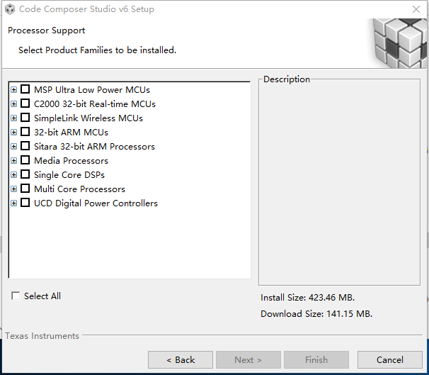

Hey engineers!
I want to know which product families the AWR 1642 belongs to,when i install the ccs.
  • Choose all of them, if your storage space allows
  • But the download speed is too slow and often being interrupted.
  • AWR1642 consists of MCPU parts: ARM Cortex M4F and C674x  DSP.
    Select 32-bit ARM MCUs and Single Core DSPs.
    You can rerun installer to add processors and debug probes to your existing installation.
    It looks like you are trying to install CCSv6, which is quite old. I would highly recommend installing a more recent version of CCS like v8 or v9.
    Also recent SDKs for the AWR family require CCS 7.4 or higher. I would suggest reviewing the Release notes for the version of SDK you plan to use as they document the recommended CCS versions.
