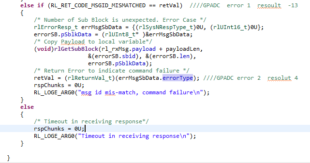

We are using SDK1.1.0.2 debugging gpadc acquisition function of external voltage, could you tell me the MmwaveLink_setGpAdcConfig () where is used to correct the output voltage value.Use the demo for high_accuracy_16xx.Error prompt during debugging: rlSetGpAdcConfig retVal=4。

    And at any point in time, you can map the return value to error type.
    mmwavelink.h: error code,
    RL_RET_CODE_INVLD_SB_LEN                      (4U)    /* Incorrect Sub-Block Length */

    I debugged the open source code and found that the number 4 came from the rlReturnVal_t rlDriverWaitForResponse(rlUInt8_t devIndex, rlDriverMsg_t* outMsg) function in rl_driver.c, with some screenshots and their own comments as shown in the figure below
