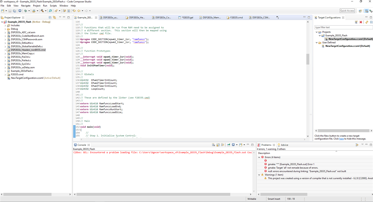

    I followed this steps.But there is still a problem.The Gel file make error.
    1-Could You share configured gel file (according to running from flash and flash address is 0x33FFF6).
    2-What are the other configurations setting on files as ".asm", ".cmd" .
    Thanks.

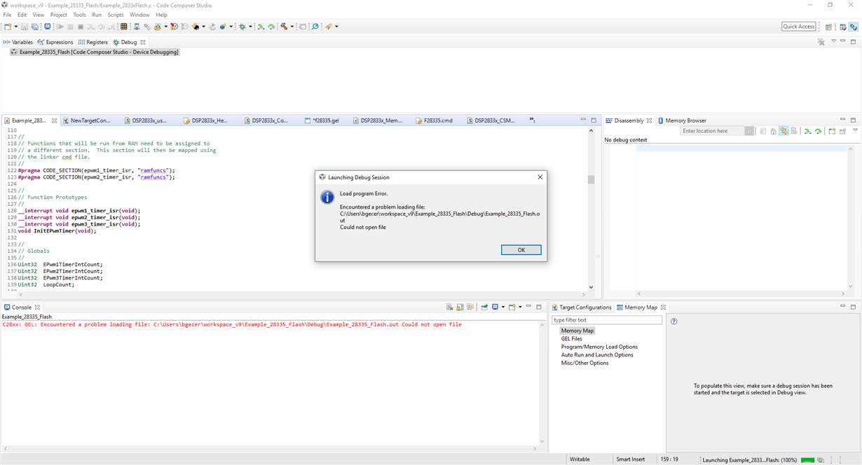

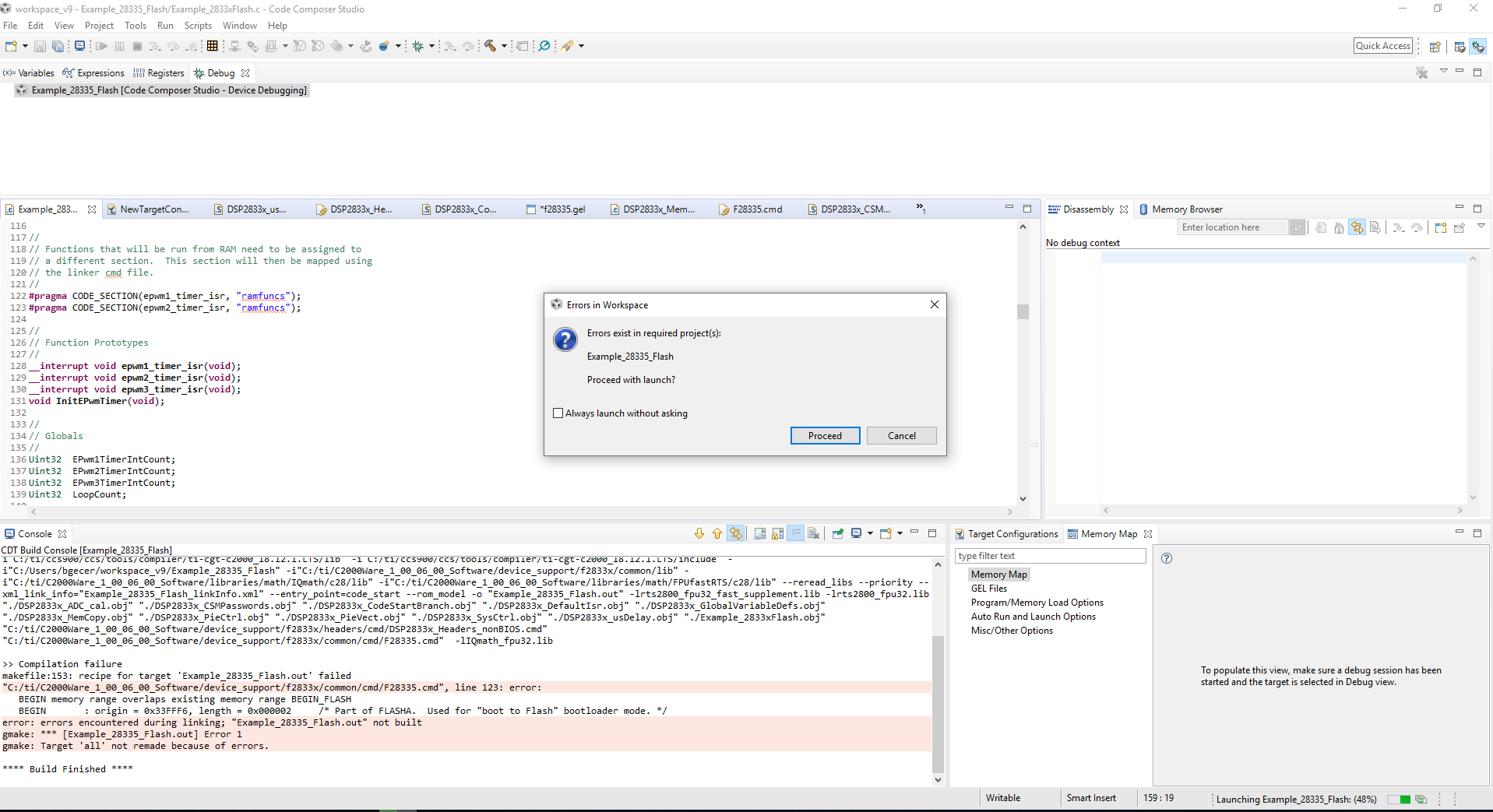

  • I have followed "Running an Application from Internal Flash Memory on the TMS320F28xxx DSP" tutorial,a specially under "Executing Your Code from Flash after a DSP Reset" title. I have problems as below in screenshot  When I debug my code.
    Problem 1;
    Problem 2:After I proceed ,I get second error as below:
    Problem 3:After I ok on Problem 2, get error as below;
    What Should I do ?
    Thanks.
  • Hi again,
    I solved my problem about F28335.cmd. (I can create Flash.out file and I can run my application.) BUT When I reset my experiment Kit, I cant run application after reset again.I still have same problem.
    They are my DSP2833x_CodeStartBranch.asm, DSP2833x_Headers_nonBIOS.cmd and  F28335.cmd (Linker Command File For F28335 Device) files;

    ARE ALL FILES OKAY ?
    What Shoul I do?
    Thanks .

    Firstly, Thanks for your response,
    I use CCS 9.0.But I also tried CCS 5 and CCS 6 too.
    Yes, I observe erasing,programming etc. When I load program.
    Thanks.
  • hi ,
    1. The linker issue seem to be because of having 2 memory sections mapped to the same memory region.
    MEMORY
    PAGE 0: /* Program Memory */
    BEGIN_FLASH : origin = 0x3F7FF6, length = 0x000002
    why do you have a BEGIN_FLASH in DSP2833x_Headers_nonBIOS.cmd file , doesn't the F28335.cmd already have BEGIN ?
    BEGIN : origin = 0x33FFF6, length = 0x000002 /* Part of FLASHA. Used for "boot to Flash" bootloader mode. */
    2. Please remove references of BEGIN from DSP2833x_Headers_nonBIOS.cmd the and keep it only in the F28335.cmd file.
    The DSP2833x_Headers_nonBIOS.cmd is primarily to map the peripherals to there memory spaces .
    All other memory usages including codestart can remain in the F28335.cmd file.
    Move back the codestart to point to the BEGIN in the default cmd file and remove any usage of BEGIN_FLASH from both cmd files.
    codestart : > BEGIN_FLASH, PAGE = 0
    Regards.

    If there is a mistake, Could you edit it please and send to me ?
    Thank you for your help.
  • hi ,
    Uncomment this line in F28335.cmd to use BEGIN instead of BEGIN_FLASH.
    // codestart : > BEGIN_FLASH, PAGE = 0
    to
    codestart : > BEGIN, PAGE = 0
    Rest looks fine. Please compile , load and check if you still see issues.
    Regards.
    I changed  F28335.cmd file according to your advive as below,compiled and load program.My application run but after reset It didnt run. I still have same problem.
    // FILE: F28335.cmd

    /* Allocate sections to memory blocks.
    Note:
    codestart user defined section in DSP28_CodeStartBranch.asm used to redirect code
    execution when booting to flash
    ramfuncs user defined section to store functions that will be copied from Flash into RAM
    SECTIONS
    /* Allocate program areas: */
    .cinit : > FLASHA PAGE = 0
    .pinit : > FLASHA, PAGE = 0
    .text : > FLASHA PAGE = 0
    codestart: > BEGIN, PAGE = 0
    ramfuncs : LOAD = FLASHD,
    RUN = RAML0,
    LOAD_START(_RamfuncsLoadStart),
    LOAD_END(_RamfuncsLoadEnd),
    RUN_START(_RamfuncsRunStart),
    LOAD_SIZE(_RamfuncsLoadSize),
    PAGE = 0
    csmpasswds : > CSM_PWL PAGE = 0
    csm_rsvd : > CSM_RSVD PAGE = 0
    /* Allocate uninitalized data sections: */
    .stack : > RAMM1 PAGE = 1
    .ebss : > RAML4 PAGE = 1
    .esysmem : > RAMM1 PAGE = 1
    /* Initalized sections go in Flash */
    /* For SDFlash to program these, they must be allocated to page 0 */
    .econst : > FLASHA PAGE = 0
    .switch : > FLASHA PAGE = 0
    /* Allocate IQ math areas: */
    IQmath : > FLASHC PAGE = 0 /* Math Code */
    IQmathTables : > IQTABLES, PAGE = 0, TYPE = NOLOAD
    /* Uncomment the section below if calling the IQNexp() or IQexp()
    functions from the IQMath.lib library in order to utilize the
    relevant IQ Math table in Boot ROM (This saves space and Boot ROM
    is 1 wait-state). If this section is not uncommented, IQmathTables2
    will be loaded into other memory (SARAM, Flash, etc.) and will take
    up space, but 0 wait-state is possible.
    IQmathTables2 : > IQTABLES2, PAGE = 0, TYPE = NOLOAD
    IQmath.lib<IQNexpTable.obj> (IQmathTablesRam)
    FPUmathTables : > FPUTABLES, PAGE = 0, TYPE = NOLOAD
    /* Allocate DMA-accessible RAM sections: */
    DMARAML4 : > RAML4, PAGE = 1
    DMARAML5 : > RAML5, PAGE = 1
    DMARAML6 : > RAML6, PAGE = 1
    DMARAML7 : > RAML7, PAGE = 1
    /* Allocate 0x400 of XINTF Zone 7 to storing data */
    ZONE7DATA : > ZONE7B, PAGE = 1
    /* .reset is a standard section used by the compiler. It contains the */
    /* the address of the start of _c_int00 for C Code. /*
    /* When using the boot ROM this section and the CPU vector */
    /* table is not needed. Thus the default type is set here to */
    /* DSECT */
    .reset : > RESET, PAGE = 0, TYPE = DSECT
    vectors : > VECTORS PAGE = 0, TYPE = DSECT
    /* Allocate ADC_cal function (pre-programmed by factory into TI reserved memory) */
    .adc_cal : load = ADC_CAL, PAGE = 0, TYPE = NOLOAD
    // End of file.
