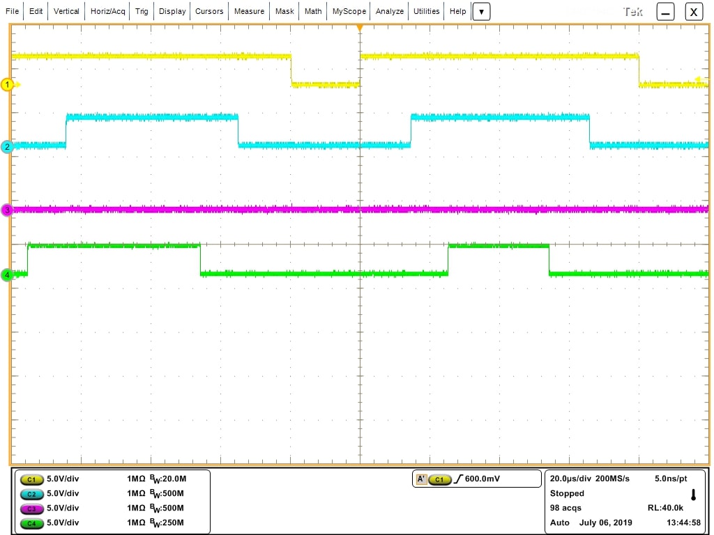

Dear Specialists,
I am trying to implement  XOR logic gate for 3  inputs in a three-phase inverter system using Developmental Kit TMS320F28069.
I found that many people suggest ^ symbol to do this logic gate. But, unfortunately, the output is not as the expected one, since the the output to be HIGH, only one of the three inputs must be HIGH and the other two inputs must be LOW. If two inputs are HIGH, so the output of the XOR must be LOW.
In other words, only two inputs must be HIGH at any time.
The next figure describe the results that I got (NOT the desired one)
Channels 1 , 2 and 3 represent the inputs to the ^ XOR symbol utilized in the code
Channel 4 represents the output of the ^ XOR symbol.
What I want is If any two of the inputs are HIGH, then Channel 4 must be LOW.
                       if only one input is HIGH, the Channel 4 must be HIGH
The code is attached, What I want to check is at the end of the code.
I would be grateful if any one can help me to do this, since I can not complete my research work.

    EPwm4Regs.CMPA.half.CMPA = EPwm1Regs.CMPA.half.CMPA ^ EPwm2Regs.CMPA.half.CMPA ^ EPwm3Regs.CMPA.half.CMPA;
