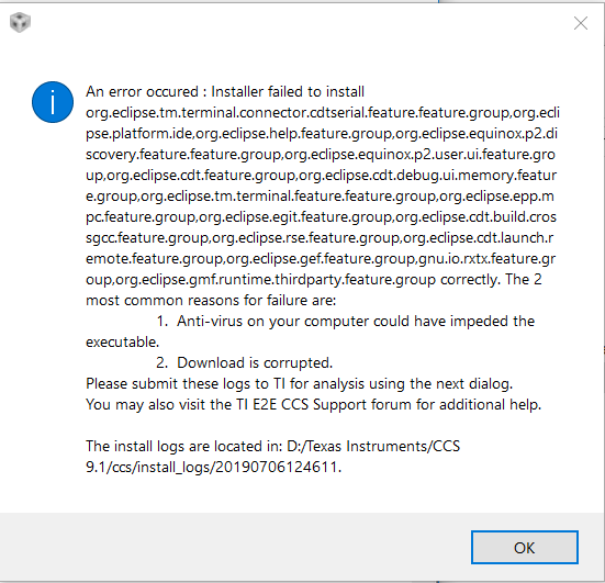

Hi, during installation of CCS 9.1 I'm experiencing the same problem as the user in this thread  - installation error occurring because Eclipse couldn't be installed.
I have followed all the guidelines etc., like turning antivirus off and checking for the JAVA environment variable (does not exist). I'm attaching the logs.

    I see that you extracted the offline installer zip inside a path with unicode characters. It is the folder "CV, CLs, Jobs" that is the problem. Please extract to a location without any unicode characters in the path and try again.
    I also recommend installing CCS in a folder without whitespaces. The current directory you selected (D:\Texas Instruments\CCS 9.1) has whitespaces.

  • Thanks, that was indeed the issue!
