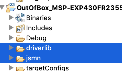

    If you are attempting to copy the code from the example project to your own project you will need to copy these folders:

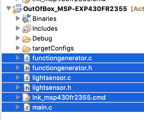

    And the source files
    Your project would then look like:

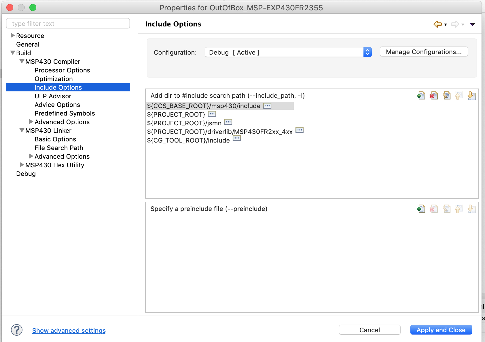

    You also will have to setup the compiler and linker search paths.
    Take a look at the paths that are setup for the example project.
    Here you can see the compiler search paths for the example project.  You will have to add the ${PROJECT_ROOT}/jsmn and ${PROJECT_ROOT}/driverlib/MSP430FR2xx_4xx paths

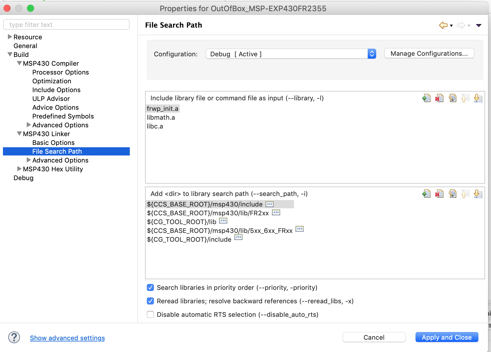

    Similarly if I look at the linker options I can see that you will have to add the libmath.a library and the search path ${CCS_BASE_ROOT}/msp430/lib/5xx_6xx_FRxx
