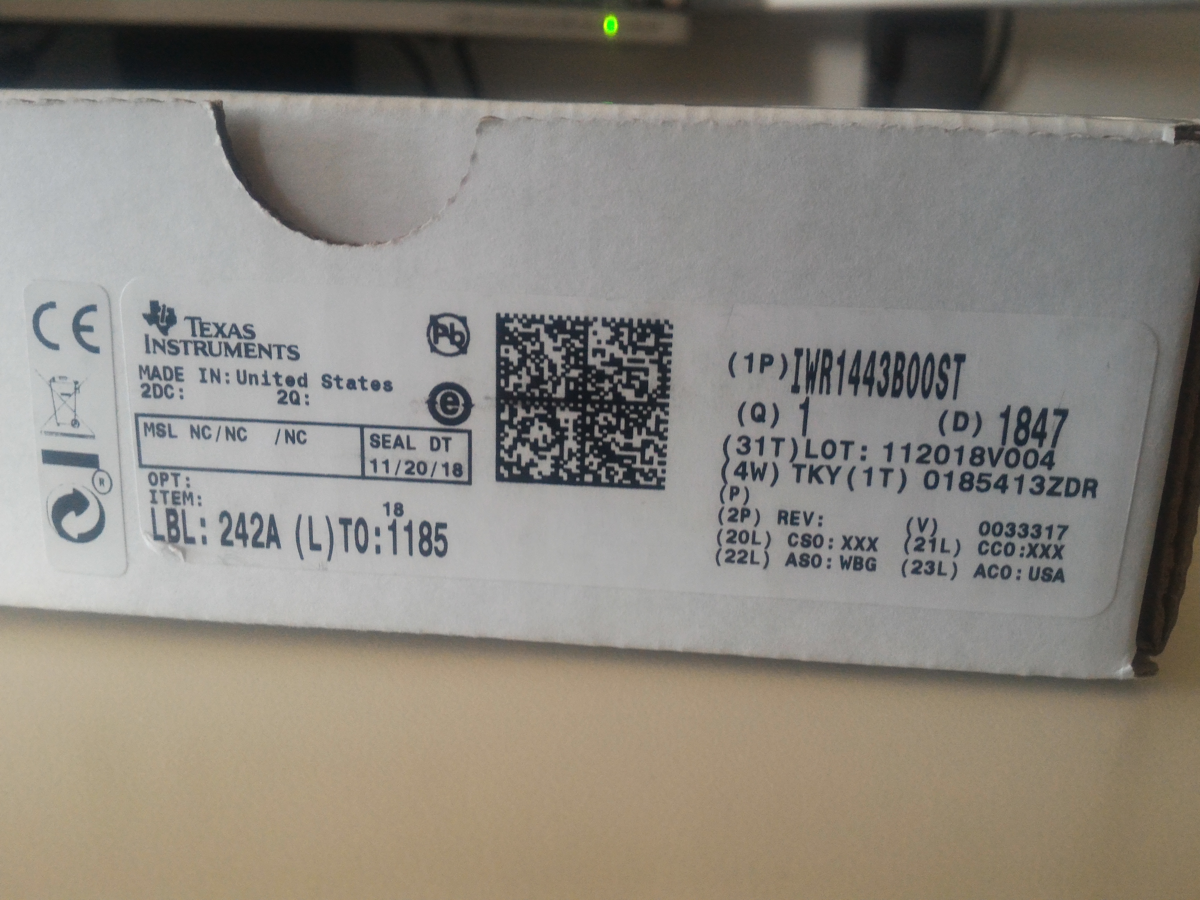

    4. What is the exact board you are using?
    That one:

    Are you using IWR1443 ES2.0 or ES3.0?
    I don't know - I did not find any information about it on the card and on the box. How can I check this out ?

    You did'nt answer my question : How check the ES version out ? It may be usefull later.
