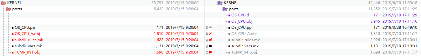

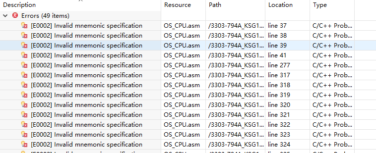

I have a question about CCS.
When I installed Code Composer Studio 8.3.1, it could not compile my program successfully. However, Code Composer Studio 7.3.0 could do it successfully. All the setup in CCS were same, even the compiler version.
The error happened in asm file. Some details could see the pictures. So, how could I solve this problem.
Best wishes for you!
    Is this OS_CPU.asm a source file that you intend to be part of the build or an assembly file generated by the compiler?
    Please see a related post here: https://e2e.ti.com/support/tools/ccs/f/81/p/734392/2711625#2711625
    I would suggest closely comparing the build log from the 7.3 build with the 8.3.1 build to look for any differences. The complete log should be output in the CCS build console
    If you are still unable to resolve the error, please send us the build logs for both versions.
    So glad to receive your reply.
    I do the same things as the related question mentioned above before I ask for help here. It seems not work.
    Here are the complete log.
    Looking forward for your solution. Best wishes to you!

    Building file: "../KERNEL/ports/OS_CPU.asm"
    Invoking: C2000 Compiler
    "F:/ti/ccsv8/tools/compiler/ti-cgt-c2000_16.9.4.LTS/bin/cl2000" -v28 -ml -mt --include_path="F:/ti/ccsv8/tools/compiler/ti-cgt-c2000_16.9.4.LTS/include" --include_path="E:/3303-794A_KSG5KDM3_V1.4_FromHwb_500V_0509_BiaoJi_OK" --advice:performance=all -g --optimize_with_debug=on --diag_warning=225 --diag_wrap=off --display_error_number --preproc_with_compile --preproc_dependency="KERNEL/ports/OS_CPU.d_raw" --obj_directory="KERNEL/ports"  "../KERNEL/ports/OS_CPU.asm"
    47 Assembly Errors, 1 Assembly Warning
    >> Compilation failure
    KERNEL/ports/subdir_rules.mk:9: recipe for target 'KERNEL/ports/OS_CPU.obj' failed
    "../KERNEL/ports/OS_CPU.asm", WARNING! at line 8: [W0003] This file contains DWARF directives that can only be used in unmodified assembly files generated by the compiler; ignoring all DWARF directives
    DW$CU .dwtag  DW_TAG_compile_unit
    "../KERNEL/ports/OS_CPU.asm", ERROR!   at line 37: [E0002] Invalid mnemonic specification
    .dwcfa 0x1d, -2
    "../KERNEL/ports/OS_CPU.asm", ERROR!   at line 38: [E0002] Invalid mnemonic specification
    .dwcfa 0x1c, 26, 0
    "../KERNEL/ports/OS_CPU.asm", ERROR!   at line 39: [E0002] Invalid mnemonic specification
    .dwcfa 0x09, 40, 26
    "../KERNEL/ports/OS_CPU.asm", ERROR!   at line 41: [E0002] Invalid mnemonic specification
    .dwcfa 0x1d, -8
    "../KERNEL/ports/OS_CPU.asm", ERROR!   at line 277: [E0002] Invalid mnemonic specification
    .dwcfa 0x1d, -2
    "../KERNEL/ports/OS_CPU.asm", ERROR!   at line 317: [E0002] Invalid mnemonic specification
    .dwcfa 0x0c, 20, 0
    "../KERNEL/ports/OS_CPU.asm", ERROR!   at line 318: [E0002] Invalid mnemonic specification
    .dwcfa 0x07, 0
    "../KERNEL/ports/OS_CPU.asm", ERROR!   at line 319: [E0002] Invalid mnemonic specification
    .dwcfa 0x07, 1
    "../KERNEL/ports/OS_CPU.asm", ERROR!   at line 320: [E0002] Invalid mnemonic specification
    .dwcfa 0x07, 2
    "../KERNEL/ports/OS_CPU.asm", ERROR!   at line 321: [E0002] Invalid mnemonic specification
    .dwcfa 0x07, 3
    "../KERNEL/ports/OS_CPU.asm", ERROR!   at line 322: [E0002] Invalid mnemonic specification
    .dwcfa 0x07, 4
    "../KERNEL/ports/OS_CPU.asm", ERROR!   at line 323: [E0002] Invalid mnemonic specification
    .dwcfa 0x07, 5
    "../KERNEL/ports/OS_CPU.asm", ERROR!   at line 324: [E0002] Invalid mnemonic specification
    .dwcfa 0x08, 6
    "../KERNEL/ports/OS_CPU.asm", ERROR!   at line 325: [E0002] Invalid mnemonic specification
    .dwcfa 0x08, 7
    "../KERNEL/ports/OS_CPU.asm", ERROR!   at line 326: [E0002] Invalid mnemonic specification
    .dwcfa 0x08, 8
    "../KERNEL/ports/OS_CPU.asm", ERROR!   at line 327: [E0002] Invalid mnemonic specification
    .dwcfa 0x08, 9
    "../KERNEL/ports/OS_CPU.asm", ERROR!   at line 328: [E0002] Invalid mnemonic specification
    .dwcfa 0x08, 10
    "../KERNEL/ports/OS_CPU.asm", ERROR!   at line 329: [E0002] Invalid mnemonic specification
    .dwcfa 0x08, 11
    "../KERNEL/ports/OS_CPU.asm", ERROR!   at line 330: [E0002] Invalid mnemonic specification
    .dwcfa 0x07, 12
    "../KERNEL/ports/OS_CPU.asm", ERROR!   at line 331: [E0002] Invalid mnemonic specification
    .dwcfa 0x07, 13
    "../KERNEL/ports/OS_CPU.asm", ERROR!   at line 332: [E0002] Invalid mnemonic specification
    .dwcfa 0x07, 14
    "../KERNEL/ports/OS_CPU.asm", ERROR!   at line 333: [E0002] Invalid mnemonic specification
    .dwcfa 0x07, 15
    "../KERNEL/ports/OS_CPU.asm", ERROR!   at line 334: [E0002] Invalid mnemonic specification
    .dwcfa 0x07, 16
    "../KERNEL/ports/OS_CPU.asm", ERROR!   at line 335: [E0002] Invalid mnemonic specification
    .dwcfa 0x07, 17
    "../KERNEL/ports/OS_CPU.asm", ERROR!   at line 336: [E0002] Invalid mnemonic specification
    .dwcfa 0x07, 18
    "../KERNEL/ports/OS_CPU.asm", ERROR!   at line 337: [E0002] Invalid mnemonic specification
    .dwcfa 0x07, 19
    "../KERNEL/ports/OS_CPU.asm", ERROR!   at line 338: [E0002] Invalid mnemonic specification
    .dwcfa 0x07, 20
    "../KERNEL/ports/OS_CPU.asm", ERROR!   at line 339: [E0002] Invalid mnemonic specification
    .dwcfa 0x07, 21
    "../KERNEL/ports/OS_CPU.asm", ERROR!   at line 340: [E0002] Invalid mnemonic specification
    .dwcfa 0x07, 22
    "../KERNEL/ports/OS_CPU.asm", ERROR!   at line 341: [E0002] Invalid mnemonic specification
    .dwcfa 0x07, 23
    "../KERNEL/ports/OS_CPU.asm", ERROR!   at line 342: [E0002] Invalid mnemonic specification
    .dwcfa 0x07, 24
    "../KERNEL/ports/OS_CPU.asm", ERROR!   at line 343: [E0002] Invalid mnemonic specification
    .dwcfa 0x07, 25
    "../KERNEL/ports/OS_CPU.asm", ERROR!   at line 344: [E0002] Invalid mnemonic specification
    .dwcfa 0x07, 26
    "../KERNEL/ports/OS_CPU.asm", ERROR!   at line 345: [E0002] Invalid mnemonic specification
    .dwcfa 0x08, 27
    "../KERNEL/ports/OS_CPU.asm", ERROR!   at line 346: [E0002] Invalid mnemonic specification
    .dwcfa 0x07, 28
    "../KERNEL/ports/OS_CPU.asm", ERROR!   at line 347: [E0002] Invalid mnemonic specification
    .dwcfa 0x07, 29
    "../KERNEL/ports/OS_CPU.asm", ERROR!   at line 348: [E0002] Invalid mnemonic specification
    .dwcfa 0x07, 30
    "../KERNEL/ports/OS_CPU.asm", ERROR!   at line 349: [E0002] Invalid mnemonic specification
    .dwcfa 0x07, 31
    "../KERNEL/ports/OS_CPU.asm", ERROR!   at line 350: [E0002] Invalid mnemonic specification
    .dwcfa 0x07, 32
    "../KERNEL/ports/OS_CPU.asm", ERROR!   at line 351: [E0002] Invalid mnemonic specification
    .dwcfa 0x07, 33
    "../KERNEL/ports/OS_CPU.asm", ERROR!   at line 352: [E0002] Invalid mnemonic specification
    .dwcfa 0x07, 34
    "../KERNEL/ports/OS_CPU.asm", ERROR!   at line 353: [E0002] Invalid mnemonic specification
    .dwcfa 0x07, 35
    "../KERNEL/ports/OS_CPU.asm", ERROR!   at line 354: [E0002] Invalid mnemonic specification
    .dwcfa 0x07, 36
    "../KERNEL/ports/OS_CPU.asm", ERROR!   at line 355: [E0002] Invalid mnemonic specification
    .dwcfa 0x07, 37
    "../KERNEL/ports/OS_CPU.asm", ERROR!   at line 356: [E0002] Invalid mnemonic specification
    .dwcfa 0x07, 38
    "../KERNEL/ports/OS_CPU.asm", ERROR!   at line 357: [E0002] Invalid mnemonic specification
    .dwcfa 0x07, 39
    "../KERNEL/ports/OS_CPU.asm", ERROR!   at line 358: [E0002] Invalid mnemonic specification
    .dwcfa 0x07, 40
    Errors in Source - Assembler Aborted
    gmake: *** [KERNEL/ports/OS_CPU.obj] Error 1

  • The build log you show above for CCS 7.3 does not show the complete build. Please do a "Rebuild" on that project with CCS 7.3 and capture the build log. Also please save the log to a text file and attach it to your reply using the paper clip icon instead of pasting the entire contents into the text field. That will make it easier for us to download and review larger logs.
    Also please check the OS_CPU.asm file. Does it actually have the .dwcfa directives? If so make a backup copy of the file (in case you have a need to revert back to it), then edit the file to remove those .dwcfa debug directives and see if that resolves the errors.
     OS_CPU.asm file is an ucos system file, could not be allowed to modify usually. Because of the portability and consistency in program, I would better not modify this file if unnecessary.
    >> Compilation failure
    		.dwcfa	0x1d, -2
    		.dwcfa	0x1c, 26, 0
    		.dwcfa	0x09, 40, 26
    		.dwcfa	0x1d, -8
    		.dwcfa	0x1d, -2
    		.dwcfa	0x0c, 20, 0
    		.dwcfa	0x07, 0
    		.dwcfa	0x07, 1
    		.dwcfa	0x07, 2
    		.dwcfa	0x07, 3
    		.dwcfa	0x07, 4
    		.dwcfa	0x07, 5
    		.dwcfa	0x08, 6
    		.dwcfa	0x08, 7
    		.dwcfa	0x08, 8
    		.dwcfa	0x08, 9
    		.dwcfa	0x08, 10
    		.dwcfa	0x08, 11
    		.dwcfa	0x07, 12
    		.dwcfa	0x07, 13
    		.dwcfa	0x07, 14
    		.dwcfa	0x07, 15
    		.dwcfa	0x07, 16
    		.dwcfa	0x07, 17
    		.dwcfa	0x07, 18
    		.dwcfa	0x07, 19
    		.dwcfa	0x07, 20
    		.dwcfa	0x07, 21
    		.dwcfa	0x07, 22
    		.dwcfa	0x07, 23
    		.dwcfa	0x07, 24
    		.dwcfa	0x07, 25
    		.dwcfa	0x07, 26
    		.dwcfa	0x08, 27
    		.dwcfa	0x07, 28
    		.dwcfa	0x07, 29
    		.dwcfa	0x07, 30
    		.dwcfa	0x07, 31
    		.dwcfa	0x07, 32
    		.dwcfa	0x07, 33
    		.dwcfa	0x07, 34
    		.dwcfa	0x07, 35
    		.dwcfa	0x07, 36
    		.dwcfa	0x07, 37
    		.dwcfa	0x07, 38
    		.dwcfa	0x07, 39
    		.dwcfa	0x07, 40
    >> Compilation failure
    		.dwcfa	0x1d, -2
    		.dwcfa	0x1c, 26, 0
    		.dwcfa	0x09, 40, 26
    		.dwcfa	0x1d, -8
    		.dwcfa	0x1d, -2
    		.dwcfa	0x0c, 20, 0
    		.dwcfa	0x07, 0
    		.dwcfa	0x07, 1
    		.dwcfa	0x07, 2
    		.dwcfa	0x07, 3
    		.dwcfa	0x07, 4
    		.dwcfa	0x07, 5
    		.dwcfa	0x08, 6
    		.dwcfa	0x08, 7
    		.dwcfa	0x08, 8
    		.dwcfa	0x08, 9
    		.dwcfa	0x08, 10
    		.dwcfa	0x08, 11
    		.dwcfa	0x07, 12
    		.dwcfa	0x07, 13
    		.dwcfa	0x07, 14
    		.dwcfa	0x07, 15
    		.dwcfa	0x07, 16
    		.dwcfa	0x07, 17
    		.dwcfa	0x07, 18
    		.dwcfa	0x07, 19
    		.dwcfa	0x07, 20
    		.dwcfa	0x07, 21
    		.dwcfa	0x07, 22
    		.dwcfa	0x07, 23
    		.dwcfa	0x07, 24
    		.dwcfa	0x07, 25
    		.dwcfa	0x07, 26
    		.dwcfa	0x08, 27
    		.dwcfa	0x07, 28
    		.dwcfa	0x07, 29
    		.dwcfa	0x07, 30
    		.dwcfa	0x07, 31
    		.dwcfa	0x07, 32
    		.dwcfa	0x07, 33
    		.dwcfa	0x07, 34
    		.dwcfa	0x07, 35
    		.dwcfa	0x07, 36
    		.dwcfa	0x07, 37
    		.dwcfa	0x07, 38
    		.dwcfa	0x07, 39
    		.dwcfa	0x07, 40

  • I see the following difference between the two logs.
    In version 7.3.0, it is building OS_CPU.c and then OS_CPU_A.asm. See lines below:
    'Building file: ../KERNEL/ports/OS_CPU.c'
    'Invoking: C2000 Compiler'
    "G:/TI/ccsv7/tools/compiler/ti-cgt-c2000_18.1.4.LTS/bin/cl2000" -v28 -ml -mt --include_path="G:/TI/ccsv7/tools/compiler/ti-cgt-c2000_18.1.4.LTS/include" --include_path="F:/Kstar task/Software Version/3303-9800_500V_Rev2.5_export" --advice:performance=all -g --optimize_with_debug=on --diag_warning=225 --diag_wrap=off --display_error_number --preproc_with_compile --preproc_dependency="KERNEL/ports/OS_CPU.d_raw" --obj_directory="KERNEL/ports" "../KERNEL/ports/OS_CPU.c"
    'Finished building: ../KERNEL/ports/OS_CPU.c'
    'Building file: ../KERNEL/ports/OS_CPU_A.asm'
    "G:/TI/ccsv7/tools/compiler/ti-cgt-c2000_18.1.4.LTS/bin/cl2000" -v28 -ml -mt --include_path="G:/TI/ccsv7/tools/compiler/ti-cgt-c2000_18.1.4.LTS/include" --include_path="F:/Kstar task/Software Version/3303-9800_500V_Rev2.5_export" --advice:performance=all -g --optimize_with_debug=on --diag_warning=225 --diag_wrap=off --display_error_number --preproc_with_compile --preproc_dependency="KERNEL/ports/OS_CPU_A.d_raw" --obj_directory="KERNEL/ports" "../KERNEL/ports/OS_CPU_A.asm"
    'Finished building: ../KERNEL/ports/OS_CPU_A.asm'
    In version 8.3.1, it is building OS_CPU.asm and then OS_CPU_A.asm. The errors are coming when building OS_CPU.asm because it is likely a compiler generated assembly file (with all those compiler generated debug directives) rather than source assembly file. I'm not sure how or why that assembly file came to be in that directory but I would expect the C file to be there and not this generated assembly file. The generated files usually go into a directory inside the \Debug directory.

    I also suspect the asm file maybe generated by compiler before. But when I open the Debug file, I could not find the asm file.  OS_CPU.c,   OS_CPU_A.asm, OS_CPU.asm are in F:\3303-794A_KSG5KDM3_V1.4_FromHwb_500V_0509_BiaoJi_OK\KERNEL\ports. All of them are the file which I write. So, the fault maybe not here. The different between F:\3303-794A_KSG5KDM3_V1.4_FromHwb_500V_0509_BiaoJi_OK\Debug\KERNEL\ports generated by compiler could be see in this picture. The red means the difference.
    So, what is the next step to solve this problem.
