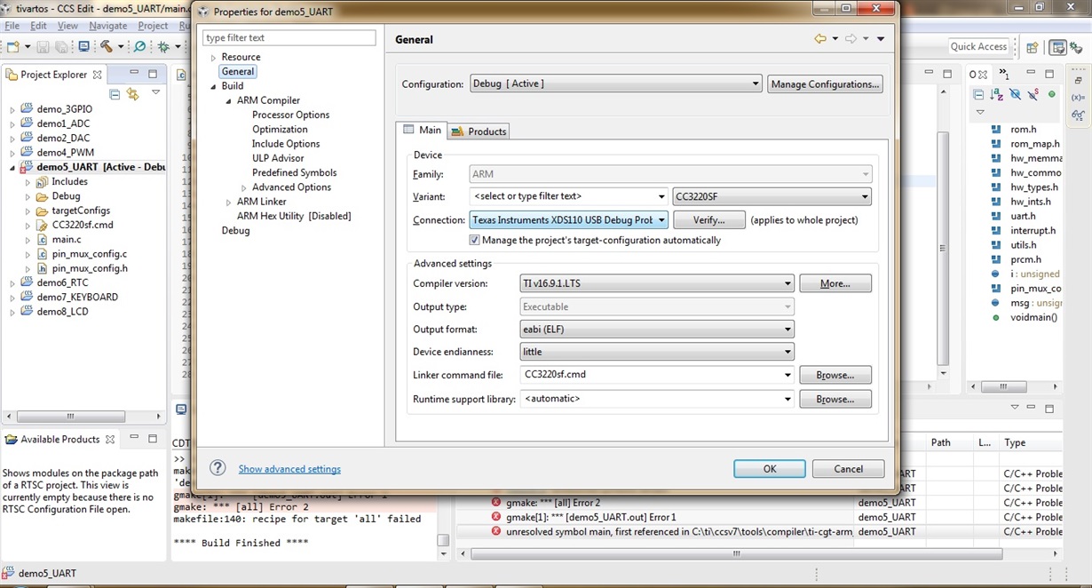

  1. “Description Resource Path Location Type #10010 errors encountered during linking; "demo5_UART.out" not built demo5_UART C/C++ Problem”
  2. “Description Resource Path Location Type
  3. href="processors.wiki.ti.com/.../10234"> unresolved symbols remain demo5_UART C/C++ Problem”
  4. “Description Resource Path Location Type unresolved symbol main, first referenced in C:\ti\ccsv7\tools\compiler\ti-cgt-arm_16.9.1.LTS\lib\rtsv7M4_T_le_eabi.lib<args_main.obj> demo5_UART C/C++ Problem”
The error is not in the program but some other error while linking.
I am using CCS V_7.1.0 & SDK version simplelink_cc32xx_sdk_3_10_00_04
I have followed the following procedure for doing the experiment. I have also attached screen shots in attachments

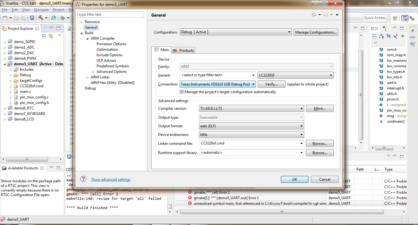

  1. Create CCS project using following configuration
I have selected the board as CC3220SF, debugger as TI XDS110 USB Debug Probe.
Then I have added necessary libraries as

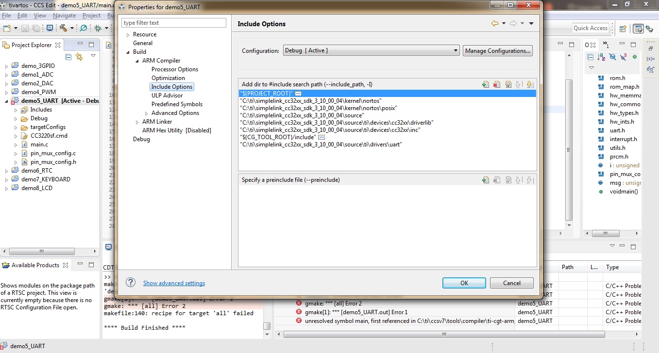

  1. The following in the include options under ARM compiler
    1. "C:\ti\simplelink_cc32xx_sdk_3_10_00_04\kernel\nortos"
    2. "C:\ti\simplelink_cc32xx_sdk_3_10_00_04\kernel\nortos\posix"
    3. "C:\ti\simplelink_cc32xx_sdk_3_10_00_04\source"
    4. "C:\ti\simplelink_cc32xx_sdk_3_10_00_04\source\ti\devices\cc32xx\driverlib"
    5. "C:\ti\simplelink_cc32xx_sdk_3_10_00_04\source\ti\devices\cc32xx\inc"
    6. "C:\ti\simplelink_cc32xx_sdk_3_10_00_04\source\ti\drivers\uart"

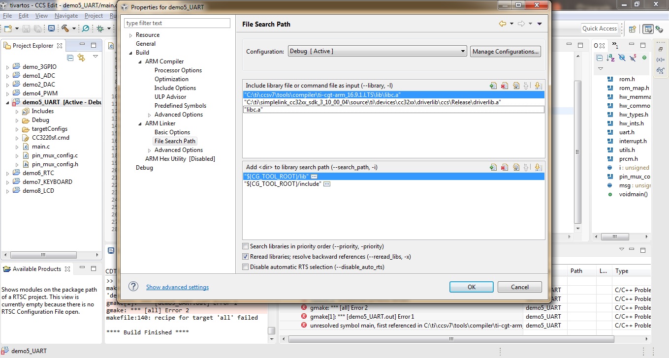

  1. The following in the File search path under ARM Linker
  2. "C:\ti\simplelink_cc32xx_sdk_3_10_00_04\source\ti\devices\cc32xx\driverlib\ccs\Release\driverlib.a"

Note:- The above mentioned procedure I have followed for other experiments and they work just fine. I have tried other versions of the compilers and the other sdk version simplelink_cc32xx_sdk_3_20_00_06 but I am getting the same error. I have also added a word file mentioning the above data & error.UART_error.docx
 Kindly guide me.
