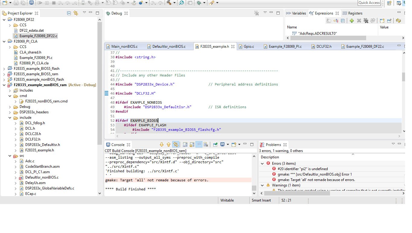

CCS/TMS320F28335: PI controller (F28335) Error: identifier "pi1" is undefined
Part Number: TMS320F28335
I am trying to implement PI controller for a dc -dc converter. I have follow the instruction from C2000WARE doc file.
The error showing is
However, I have defined the pi1.
Here is the header files and src files. I also have allocated the controller functions in the linker command file
Anyone can help me out?

  • The screenshots have still not posted. Perhaps try zipping the images and attach the zip file to the thread.
  • Thanks Ki. It was my bad. I didn't see the instructions how to upload images in this forum. It is my first post. Thanks for stepping up.
  • I think the issue is "DCL_runPI_C1" declared implicitly" . But dont know how to solve it. I got this one from error message.
  • Are you including the header file (via #include) in DefaultIsr_nonBIOS.c?
  • Hi Ki,
    No. I have included header file in Main_nonBIOs.c
  • Try also adding it to DefaultIsr_nonBIOS.c
  • My main file:

  • Sorry, here is the main_nonBIOs file. Previous one was DefaultIsr_nonBIOS file.
    As of your recommendation, I have tried with the header file in DefaultIsr_nonBIOS.c file. Didn't resolve my issue
    #include "F28335_example.h"                // Main include file
    #include "DCL.h"
    #include "DCLF32.H"
    #include "DCL_fdlog.h"

  • Is DCL_runPI_C1 and pi2 defined in F28335_example.h? If not, then you must also include the header file that does define it.
  • here is the cmd file
    The issue is with this line in: DefaultIsr_nonBIOS.c
    uk= DCL_runPI_C1(&pi2, rk, yk);
    The only header file being included there is:
    is pi2 and DCL_runPl_C1 defined in that header file? If it is not, then you need have another #include for the header file that does define them.
    The cmd file is used by the linker. You are running into a compiler error hence the cmd is not the issue.
  • F28335 example.h file:
    #ifndef F28335_EXAMPLE_H
    #define F28335_EXAMPLE_H
    // Constant Definitions
    #define ADC_BUF_LEN            50                // ADC buffer length
    #define ADC_SAMPLE_PERIOD    99            // 2999 = 50 KHz sampling w/ 150 MHz SYSCLKOUT
    #define PWM_HALF_PERIOD        50        // period/2 for 2 kHz symmetric PWM
    #define PWM_DUTY_CYCLE        PWM_HALF_PERIOD*0.7 //28125            // 25% duty cycle
    #define counter             50
    #define dc                  35

  • Here is the screenshots. Nothing resolve the issue
    Defaultisr_nonBIOS.c with header files
  • Hi Ki,
    Sorry yesterday I mistakenly gave two same sceenshot. Here is the "Defaultisr_nonBIOS.c" file. .h files are included. I have included .h file in Min_nonBIOS.c,
    Defaultisr_nonBIOS.c and in F28335_example.h file. I also gave you all the code. Could you please have another look?
    **********************************************************************/ #include "F28335_example.h" // Main include file #include "DCL.h" #include "DCLF32.h" #include "DCL_fdlog.h" #include "DCLC28.h" //--------------------------------------------------------------------- interrupt void INT13_ISR(void) // 0x000D1A INT13 (XINT13 or CPU Timer1) { // Next two lines for debug only - remove after inserting your ISR asm (" ESTOP0"); // Emulator Halt instruction while(1); } //--------------------------------------------------------------------- interrupt void INT14_ISR(void) // 0x000D1C INT14 (CPU Timer2) { // Next two lines for debug only - remove after inserting your ISR asm (" ESTOP0"); // Emulator Halt instruction while(1); } //--------------------------------------------------------------------- interrupt void DATALOG_ISR(void) // 0x000D1E DATALOG (CPU data logging interrupt) { // Next two lines for debug only - remove after inserting your ISR asm (" ESTOP0"); // Emulator Halt instruction while(1); } //--------------------------------------------------------------------- interrupt void RTOSINT_ISR(void) // 0x000D20 RTOSINT (CPU RTOS interrupt) { // Next two lines for debug only - remove after inserting your ISR asm (" ESTOP0"); // Emulator Halt instruction while(1); } //--------------------------------------------------------------------- interrupt void EMUINT_ISR(void) // 0x000D22 EMUINT (CPU emulation interrupt) { // Next two lines for debug only - remove after inserting your ISR asm (" ESTOP0"); // Emulator Halt instruction while(1); } //--------------------------------------------------------------------- interrupt void NMI_ISR(void) // 0x000D24 NMI (XNMI interrupt) { // Next two lines for debug only - remove after inserting your ISR asm (" ESTOP0"); // Emulator Halt instruction while(1); } //--------------------------------------------------------------------- interrupt void ILLEGAL_ISR(void) // 0x000D26 ILLEGAL (Illegal operation trap) { // Next two lines for debug only - remove after inserting your ISR asm (" ESTOP0"); // Emulator Halt instruction while(1); } //--------------------------------------------------------------------- interrupt void USER1_ISR(void) // 0x000D28 USER1 (Software interrupt #1) { // Next two lines for debug only - remove after inserting your ISR asm (" ESTOP0"); // Emulator Halt instruction while(1); } //--------------------------------------------------------------------- interrupt void USER2_ISR(void) // 0x000D2A USER2 (Software interrupt #2) { // Next two lines for debug only - remove after inserting your ISR asm (" ESTOP0"); // Emulator Halt instruction while(1); } //--------------------------------------------------------------------- interrupt void USER3_ISR(void) // 0x000D2C USER3 (Software interrupt #3) { // Next two lines for debug only - remove after inserting your ISR asm (" ESTOP0"); // Emulator Halt instruction while(1); } //--------------------------------------------------------------------- interrupt void USER4_ISR(void) // 0x000D2E USER4 (Software interrupt #4) { // Next two lines for debug only - remove after inserting your ISR asm (" ESTOP0"); // Emulator Halt instruction while(1); } //--------------------------------------------------------------------- interrupt void USER5_ISR(void) // 0x000D30 USER5 (Software interrupt #5) { // Next two lines for debug only - remove after inserting your ISR asm (" ESTOP0"); // Emulator Halt instruction while(1); } //--------------------------------------------------------------------- interrupt void USER6_ISR(void) // 0x000D32 USER6 (Software interrupt #6) { // Next two lines for debug only - remove after inserting your ISR asm (" ESTOP0"); // Emulator Halt instruction while(1); } //--------------------------------------------------------------------- interrupt void USER7_ISR(void) // 0x000D34 USER7 (Software interrupt #7) { // Next two lines for debug only - remove after inserting your ISR asm (" ESTOP0"); // Emulator Halt instruction while(1); } //--------------------------------------------------------------------- interrupt void USER8_ISR(void) // 0x000D36 USER8 (Software interrupt #8) { // Next two lines for debug only - remove after inserting your ISR asm (" ESTOP0"); // Emulator Halt instruction while(1); } //--------------------------------------------------------------------- interrupt void USER9_ISR(void) // 0x000D38 USER9 (Software interrupt #9) { // Next two lines for debug only - remove after inserting your ISR asm (" ESTOP0"); // Emulator Halt instruction while(1); } //--------------------------------------------------------------------- interrupt void USER10_ISR(void) // 0x000D3A USER10 (Software interrupt #10) { // Next two lines for debug only - remove after inserting your ISR asm (" ESTOP0"); // Emulator Halt instruction while(1); } //--------------------------------------------------------------------- interrupt void USER11_ISR(void) // 0x000D3C USER11 (Software interrupt #11) { // Next two lines for debug only - remove after inserting your ISR asm (" ESTOP0"); // Emulator Halt instruction while(1); } //--------------------------------------------------------------------- interrupt void USER12_ISR(void) // 0x000D3E USER12 (Software interrupt #12) { // Next two lines for debug only - remove after inserting your ISR asm (" ESTOP0"); // Emulator Halt instruction while(1); } //--------------------------------------------------------------------- interrupt void SEQ1INT_ISR(void) // PIE1.1 @ 0x000D40 SEQ1INT (ADC SEQ1) { PieCtrlRegs.PIEACK.all = PIEACK_GROUP1; // Must acknowledge the PIE group // Next two lines for debug only - remove after inserting your ISR asm (" ESTOP0"); // Emulator Halt instruction while(1); } //--------------------------------------------------------------------- interrupt void SEQ2INT_ISR(void) // PIE1.2 @ 0x000D42 SEQ2INT (ADC SEQ2) { PieCtrlRegs.PIEACK.all = PIEACK_GROUP1; // Must acknowledge the PIE group // Next two lines for debug only - remove after inserting your ISR asm (" ESTOP0"); // Emulator Halt instruction while(1); } //--------------------------------------------------------------------- // PIE1.3 @ 0x000D44 reserved //--------------------------------------------------------------------- interrupt void XINT1_ISR(void) // PIE1.4 @ 0x000D46 XINT1 { PieCtrlRegs.PIEACK.all = PIEACK_GROUP1; // Must acknowledge the PIE group // Next two lines for debug only - remove after inserting your ISR asm (" ESTOP0"); // Emulator Halt instruction while(1); } //--------------------------------------------------------------------- interrupt void XINT2_ISR(void) // PIE1.5 @ 0x000D48 XINT2 { PieCtrlRegs.PIEACK.all = PIEACK_GROUP1; // Must acknowledge the PIE group // Next two lines for debug only - remove after inserting your ISR asm (" ESTOP0"); // Emulator Halt instruction while(1); } //--------------------------------------------------------------------- interrupt void ADCINT_ISR(void) // PIE1.6 @ 0x000D4A ADCINT { static volatile Uint16 GPIO32_count = 0; // Counter for pin toggle static Uint16 *AdcBufPtr = AdcBuf; // Pointer to buffer PieCtrlRegs.PIEACK.all = PIEACK_GROUP1; // Must acknowledge the PIE group //--- Manage the ADC registers AdcRegs.ADCTRL2.bit.RST_SEQ1 = 1; // Reset SEQ1 to CONV00 state AdcRegs.ADCST.bit.INT_SEQ1_CLR = 1; // Clear ADC SEQ1 interrupt flag //--- Read the ADC result *AdcBufPtr++ = AdcRegs.ADCRESULT0 >> 4; // Read the result //--- Brute-force the circular buffer if( AdcBufPtr == (AdcBuf + ADC_BUF_LEN) ) AdcBufPtr = AdcBuf; // Rewind the pointer to beginning //--- Example: Toggle GPIO32 and GPIO34, one of which is connected to the LED on the board if(GPIO32_count++ > 12500) // Toggle slowly to see the LED blink { GpioDataRegs.GPBTOGGLE.bit.GPIO32 = 1; // Toggle the pin GpioDataRegs.GPBTOGGLE.bit.GPIO34 = 1; // Toggle the pin GPIO32_count = 0; // Reset the counter } EPwm1Regs.TBPRD = 75000/(90); //210 FOR THE 3PH CIRCUIT EPwm1Regs.CMPA.half.CMPA = EPwm1Regs.TBPRD*(1-0.35); //0.2 FOR THE 3PH CIRCUIT EPwm2Regs.TBPRD = 75000/(150); //210 FOR THE 3PH CIRCUIT EPwm2Regs.CMPA.half.CMPA = EPwm2Regs.TBPRD*(1-0.35); //0.2 FO //EPwm5Regs.CMPA.half.CMPA = EPwm5Regs.TBPRD*(1-d); // where d is the duty cycle. // EPwm3Regs.TBPRD = 75000/(200); //GPIO08 // EPwm3Regs.CMPA.half.CMPA = EPwm3Regs.TBPRD*(1-0.30); //MPPT CODE yk=((AdcRegs.ADCRESULT1>>4)*3.3/4096)*(10.7); uk= DCL_runPI_C1(&pi2, rk, yk); //yk = ((AdcRegs.ADCRESULT1>>4)*3.3/4096)*(10.7); //uk=DCL_runPI_C1(&pi1, rk, yk); //Voltage = ((AdcRegs.ADCRESULT1>>4)*3.3/4096)*(10.7); Current = ((AdcRegs.ADCRESULT0>>4)*3.3/4096)/0.5; Power = Voltage*Current; if(outputCounter >= 100) { if((Power-oldPower) > 0) { if((Voltage - oldVoltage) >= 0) { if (fcounter >=freqMax) fcounter = freqMax; else fcounter = fcounter + x; } else { if (fcounter <= freqMin) fcounter = freqMin; else fcounter = fcounter - x; } outputCounter = 1; } else { if((Voltage - oldVoltage) <= 0) { if (fcounter >=freqMax) fcounter = freqMax; else fcounter = fcounter + x; } else { if (fcounter <= freqMin) fcounter = freqMin; else fcounter = fcounter - x; } outputCounter = 1; } outputCounter = 1; // a = (1/((counter)*1000))/(0.01/(10*10*10*10*10*10)); oldVoltage = Voltage; oldCurrent = Current; oldPower = Power; } else { outputCounter = outputCounter+1; EPwm3Regs.TBPRD = 75000/(fcounter); //GPIO08 EPwm3Regs.CMPA.half.CMPA = EPwm3Regs.TBPRD*(1-0.30); } /*if (ccounter < 500000) { EPwm1Regs.TBPRD = 75000/(280); //210 FOR THE 3PH CIRCUIT EPwm1Regs.CMPA.half.CMPA = EPwm1Regs.TBPRD*(1-0.3); //0.2 FOR THE 3PH CIRCUIT ccounter = ccounter + 1; } else { EPwm1Regs.TBPRD = 75000/(260); //210 FOR THE 3PH CIRCUIT EPwm1Regs.CMPA.half.CMPA = EPwm1Regs.TBPRD*(1-0.3); //0.2 FOR THE 3PH CIRCUIT } */ /* if((AdcRegs.ADCRESULT0 >> 4) > 500) { EPwm5Regs.TBPRD = 75000/(300); //GPIO08 EPwm5Regs.CMPA.half.CMPA = EPwm5Regs.TBPRD*(1-0.5); } else { EPwm5Regs.TBPRD = 75000/(100); //GPIO08 EPwm5Regs.CMPA.half.CMPA = EPwm5Regs.TBPRD*(1-0.5); } */ //if(test < counter) // { // if(test<dc) // GpioDataRegs.GPASET.bit.GPIO16 = 1; // else // GpioDataRegs.GPACLEAR.bit.GPIO16 = 1; // test = test + 1; // } // else // test = 0; } //--------------------------------------------------------------------- interrupt void TINT0_ISR(void) // PIE1.7 @ 0x000D4C TINT0 (CPU TIMER 0) { PieCtrlRegs.PIEACK.all = PIEACK_GROUP1; // Must acknowledge the PIE group // Next two lines for debug only - remove after inserting your ISR asm (" ESTOP0"); // Emulator Halt instruction while(1); } //--------------------------------------------------------------------- interrupt void WAKEINT_ISR(void) // PIE1.8 @ 0x000D4E WAKEINT (LPM/WD) { PieCtrlRegs.PIEACK.all = PIEACK_GROUP1; // Must acknowledge the PIE group // Next two lines for debug only - remove after inserting your ISR asm (" ESTOP0"); // Emulator Halt instruction while(1); } //--------------------------------------------------------------------- interrupt void EPWM1_TZINT_ISR(void) // PIE2.1 @ 0x000D50 EPWM1_TZINT { PieCtrlRegs.PIEACK.all = PIEACK_GROUP2; // Must acknowledge the PIE group // Next two lines for debug only - remove after inserting your ISR asm (" ESTOP0"); // Emulator Halt instruction while(1); } //--------------------------------------------------------------------- interrupt void EPWM2_TZINT_ISR(void) // PIE2.2 @ 0x000D52 EPWM2_TZINT { PieCtrlRegs.PIEACK.all = PIEACK_GROUP2; // Must acknowledge the PIE group // Next two lines for debug only - remove after inserting your ISR asm (" ESTOP0"); // Emulator Halt instruction while(1); } //--------------------------------------------------------------------- interrupt void EPWM3_TZINT_ISR(void) // PIE2.3 @ 0x000D54 EPWM3_TZINT { PieCtrlRegs.PIEACK.all = PIEACK_GROUP2; // Must acknowledge the PIE group // Next two lines for debug only - remove after inserting your ISR asm (" ESTOP0"); // Emulator Halt instruction while(1); } //--------------------------------------------------------------------- interrupt void EPWM4_TZINT_ISR(void) // PIE2.4 @ 0x000D56 EPWM4_TZINT { PieCtrlRegs.PIEACK.all = PIEACK_GROUP2; // Must acknowledge the PIE group // Next two lines for debug only - remove after inserting your ISR asm (" ESTOP0"); // Emulator Halt instruction while(1); } //--------------------------------------------------------------------- interrupt void EPWM5_TZINT_ISR(void) // PIE2.5 @ 0x000D58 EPWM5_TZINT { PieCtrlRegs.PIEACK.all = PIEACK_GROUP2; // Must acknowledge the PIE group // Next two lines for debug only - remove after inserting your ISR asm (" ESTOP0"); // Emulator Halt instruction while(1); } //--------------------------------------------------------------------- interrupt void EPWM6_TZINT_ISR(void) // PIE2.6 @ 0x000D5A EPWM6_TZINT { PieCtrlRegs.PIEACK.all = PIEACK_GROUP2; // Must acknowledge the PIE group // Next two lines for debug only - remove after inserting your ISR asm (" ESTOP0"); // Emulator Halt instruction while(1); } //--------------------------------------------------------------------- // PIE2.7 @ 0x000D5C reserved // PIE2.8 @ 0x000D5E reserved //--------------------------------------------------------------------- interrupt void EPWM1_INT_ISR(void) // PIE3.1 @ 0x000D60 EPWM1_INT { PieCtrlRegs.PIEACK.all = PIEACK_GROUP3; // Must acknowledge the PIE group // Next two lines for debug only - remove after inserting your ISR asm (" ESTOP0"); // Emulator Halt instruction while(1); } //--------------------------------------------------------------------- interrupt void EPWM2_INT_ISR(void) // PIE3.2 @ 0x000D62 EPWM2_INT { PieCtrlRegs.PIEACK.all = PIEACK_GROUP3; // Must acknowledge the PIE group // Next two lines for debug only - remove after inserting your ISR asm (" ESTOP0"); // Emulator Halt instruction while(1); } //--------------------------------------------------------------------- interrupt void EPWM3_INT_ISR(void) // PIE3.3 @ 0x000D64 EPWM3_INT { PieCtrlRegs.PIEACK.all = PIEACK_GROUP3; // Must acknowledge the PIE group // Next two lines for debug only - remove after inserting your ISR asm (" ESTOP0"); // Emulator Halt instruction while(1); } //--------------------------------------------------------------------- interrupt void EPWM4_INT_ISR(void) // PIE3.4 @ 0x000D66 EPWM4_INT { PieCtrlRegs.PIEACK.all = PIEACK_GROUP3; // Must acknowledge the PIE group // Next two lines for debug only - remove after inserting your ISR asm (" ESTOP0"); // Emulator Halt instruction while(1); } //--------------------------------------------------------------------- interrupt void EPWM5_INT_ISR(void) // PIE3.5 @ 0x000D68 EPWM5_INT { PieCtrlRegs.PIEACK.all = PIEACK_GROUP3; // Must acknowledge the PIE group // Next two lines for debug only - remove after inserting your ISR asm (" ESTOP0"); // Emulator Halt instruction while(1); } //--------------------------------------------------------------------- interrupt void EPWM6_INT_ISR(void) // PIE3.6 @ 0x000D6A EPWM6_INT { PieCtrlRegs.PIEACK.all = PIEACK_GROUP3; // Must acknowledge the PIE group // Next two lines for debug only - remove after inserting your ISR asm (" ESTOP0"); // Emulator Halt instruction while(1); } //--------------------------------------------------------------------- // PIE3.7 @ 0x000D6C reserved // PIE3.8 @ 0x000D6E reserved //--------------------------------------------------------------------- interrupt void ECAP1_INT_ISR(void) // PIE4.1 @ 0x000D70 ECAP1_INT { PieCtrlRegs.PIEACK.all = PIEACK_GROUP4; // Must acknowledge the PIE group ECap1Regs.ECCLR.bit.INT = 1; // Clear the ECAP1 interrupt flag ECap1Regs.ECCLR.bit.CEVT3 = 1; // Clear the CEVT3 flag // Compute the PWM duty period (rising edge to falling edge) PwmDuty = (int32)ECap1Regs.CAP2 - (int32)ECap1Regs.CAP1; // Compute the PWM period (rising edge to rising edge) PwmPeriod = (int32)ECap1Regs.CAP3 - (int32)ECap1Regs.CAP1; } //--------------------------------------------------------------------- interrupt void ECAP2_INT_ISR(void) // PIE4.2 @ 0x000D72 ECAP2_INT { PieCtrlRegs.PIEACK.all = PIEACK_GROUP4; // Must acknowledge the PIE group // Next two lines for debug only - remove after inserting your ISR asm (" ESTOP0"); // Emulator Halt instruction while(1); } //--------------------------------------------------------------------- interrupt void ECAP3_INT_ISR(void) // PIE4.3 @ 0x000D74 ECAP3_INT { PieCtrlRegs.PIEACK.all = PIEACK_GROUP4; // Must acknowledge the PIE group // Next two lines for debug only - remove after inserting your ISR asm (" ESTOP0"); // Emulator Halt instruction while(1); } //--------------------------------------------------------------------- interrupt void ECAP4_INT_ISR(void) // PIE4.4 @ 0x000D76 ECAP4_INT { PieCtrlRegs.PIEACK.all = PIEACK_GROUP4; // Must acknowledge the PIE group // Next two lines for debug only - remove after inserting your ISR asm (" ESTOP0"); // Emulator Halt instruction while(1); } //--------------------------------------------------------------------- interrupt void ECAP5_INT_ISR(void) // PIE4.5 @ 0x000D78 ECAP5_INT { PieCtrlRegs.PIEACK.all = PIEACK_GROUP4; // Must acknowledge the PIE group // Next two lines for debug only - remove after inserting your ISR asm (" ESTOP0"); // Emulator Halt instruction while(1); } //--------------------------------------------------------------------- interrupt void ECAP6_INT_ISR(void) // PIE4.6 @ 0x000D7A ECAP6_INT { PieCtrlRegs.PIEACK.all = PIEACK_GROUP4; // Must acknowledge the PIE group // Next two lines for debug only - remove after inserting your ISR asm (" ESTOP0"); // Emulator Halt instruction while(1); } //--------------------------------------------------------------------- // PIE4.7 @ 0x000D7C reserved // PIE4.8 @ 0x000D7E reserved //--------------------------------------------------------------------- interrupt void EQEP1_INT_ISR(void) // PIE5.1 @ 0x000D80 EQEP1_INT { PieCtrlRegs.PIEACK.all = PIEACK_GROUP5; // Must acknowledge the PIE group // Next two lines for debug only - remove after inserting your ISR asm (" ESTOP0"); // Emulator Halt instruction while(1); } //--------------------------------------------------------------------- interrupt void EQEP2_INT_ISR(void) // PIE5.2 @ 0x000D82 EQEP2_INT { PieCtrlRegs.PIEACK.all = PIEACK_GROUP5; // Must acknowledge the PIE group // Next two lines for debug only - remove after inserting your ISR asm (" ESTOP0"); // Emulator Halt instruction while(1); } //--------------------------------------------------------------------- // PIE5.3 @ 0x000D84 reserved // PIE5.4 @ 0x000D86 reserved // PIE5.5 @ 0x000D88 reserved // PIE5.6 @ 0x000D8A reserved // PIE5.7 @ 0x000D8C reserved // PIE5.8 @ 0x000D8E reserved //--------------------------------------------------------------------- interrupt void SPIRXINTA_ISR(void) // PIE6.1 @ 0x000D90 SPIRXINTA (SPI-A) { PieCtrlRegs.PIEACK.all = PIEACK_GROUP6; // Must acknowledge the PIE group // Next two lines for debug only - remove after inserting your ISR asm (" ESTOP0"); // Emulator Halt instruction while(1); } //--------------------------------------------------------------------- interrupt void SPITXINTA_ISR(void) // PIE6.2 @ 0x000D92 SPITXINTA (SPI-A) { PieCtrlRegs.PIEACK.all = PIEACK_GROUP6; // Must acknowledge the PIE group // Next two lines for debug only - remove after inserting your ISR asm (" ESTOP0"); // Emulator Halt instruction while(1); } //--------------------------------------------------------------------- interrupt void MRINTB_ISR(void) // PIE6.3 @ 0x000D94 MRINTB (McBSP-B) { PieCtrlRegs.PIEACK.all = PIEACK_GROUP6; // Must acknowledge the PIE group // Next two lines for debug only - remove after inserting your ISR asm (" ESTOP0"); // Emulator Halt instruction while(1); } //--------------------------------------------------------------------- interrupt void MXINTB_ISR(void) // PIE6.4 @ 0x000D96 MXINTB (McBSP-B) { PieCtrlRegs.PIEACK.all = PIEACK_GROUP6; // Must acknowledge the PIE group // Next two lines for debug only - remove after inserting your ISR asm (" ESTOP0"); // Emulator Halt instruction while(1); } //--------------------------------------------------------------------- interrupt void MRINTA_ISR(void) // PIE6.5 @ 0x000D98 MRINTA (McBSP-A) { PieCtrlRegs.PIEACK.all = PIEACK_GROUP6; // Must acknowledge the PIE group // Next two lines for debug only - remove after inserting your ISR asm (" ESTOP0"); // Emulator Halt instruction while(1); } //--------------------------------------------------------------------- interrupt void MXINTA_ISR(void) // PIE6.6 @ 0x000D9A MXINTA (McBSP-A) { PieCtrlRegs.PIEACK.all = PIEACK_GROUP6; // Must acknowledge the PIE group // Next two lines for debug only - remove after inserting your ISR asm (" ESTOP0"); // Emulator Halt instruction while(1); } //--------------------------------------------------------------------- // PIE6.7 @ 0x000D9C reserved // PIE6.8 @ 0x000D9E reserved //--------------------------------------------------------------------- interrupt void DINTCH1_ISR(void) // PIE7.1 @ 0x000DA0 DINTCH1 (DMA) { PieCtrlRegs.PIEACK.all = PIEACK_GROUP7; // Must acknowledge the PIE group // Next two lines for debug only - remove after inserting your ISR asm (" ESTOP0"); // Emulator Halt instruction while(1); } //--------------------------------------------------------------------- interrupt void DINTCH2_ISR(void) // PIE7.2 @ 0x000DA2 DINTCH2 (DMA) { PieCtrlRegs.PIEACK.all = PIEACK_GROUP7; // Must acknowledge the PIE group // Next two lines for debug only - remove after inserting your ISR asm (" ESTOP0"); // Emulator Halt instruction while(1); } //--------------------------------------------------------------------- interrupt void DINTCH3_ISR(void) // PIE7.3 @ 0x000DA4 DINTCH3 (DMA) { PieCtrlRegs.PIEACK.all = PIEACK_GROUP7; // Must acknowledge the PIE group // Next two lines for debug only - remove after inserting your ISR asm (" ESTOP0"); // Emulator Halt instruction while(1); } //--------------------------------------------------------------------- interrupt void DINTCH4_ISR(void) // PIE7.4 @ 0x000DA6 DINTCH4 (DMA) { PieCtrlRegs.PIEACK.all = PIEACK_GROUP7; // Must acknowledge the PIE group // Next two lines for debug only - remove after inserting your ISR asm (" ESTOP0"); // Emulator Halt instruction while(1); } //--------------------------------------------------------------------- interrupt void DINTCH5_ISR(void) // PIE7.5 @ 0x000DA8 DINTCH5 (DMA) { PieCtrlRegs.PIEACK.all = PIEACK_GROUP7; // Must acknowledge the PIE group // Next two lines for debug only - remove after inserting your ISR asm (" ESTOP0"); // Emulator Halt instruction while(1); } //--------------------------------------------------------------------- interrupt void DINTCH6_ISR(void) // PIE7.6 @ 0x000DAA DINTCH6 (DMA) { PieCtrlRegs.PIEACK.all = PIEACK_GROUP7; // Must acknowledge the PIE group // Next two lines for debug only - remove after inserting your ISR asm (" ESTOP0"); // Emulator Halt instruction while(1); } //--------------------------------------------------------------------- // PIE7.7 @ 0x000DAC reserved // PIE7.8 @ 0x000DAE reserved //--------------------------------------------------------------------- interrupt void I2CINT1A_ISR(void) // PIE8.1 @ 0x000DB0 I2CINT1A (I2C-A) { PieCtrlRegs.PIEACK.all = PIEACK_GROUP8; // Must acknowledge the PIE group // Next two lines for debug only - remove after inserting your ISR asm (" ESTOP0"); // Emulator Halt instruction while(1); } //--------------------------------------------------------------------- interrupt void I2CINT2A_ISR(void) // PIE8.2 @ 0x000DB2 I2CINT2A (I2C-A) { PieCtrlRegs.PIEACK.all = PIEACK_GROUP8; // Must acknowledge the PIE group // Next two lines for debug only - remove after inserting your ISR asm (" ESTOP0"); // Emulator Halt instruction while(1); } //--------------------------------------------------------------------- // PIE8.3 @ 0x000DB4 reserved // PIE8.4 @ 0x000DB6 reserved //--------------------------------------------------------------------- interrupt void SCIRXINTC_ISR(void) // PIE8.5 @ 0x000DB8 SCIRXINTC (SCI-C) { PieCtrlRegs.PIEACK.all = PIEACK_GROUP8; // Must acknowledge the PIE group // Next two lines for debug only - remove after inserting your ISR asm (" ESTOP0"); // Emulator Halt instruction while(1); } //--------------------------------------------------------------------- interrupt void SCITXINTC_ISR(void) // PIE8.6 @ 0x000DBA SCIRXINTC (SCI-C) { PieCtrlRegs.PIEACK.all = PIEACK_GROUP8; // Must acknowledge the PIE group // Next two lines for debug only - remove after inserting your ISR asm (" ESTOP0"); // Emulator Halt instruction while(1); } //--------------------------------------------------------------------- // PIE8.7 @ 0x000DBC reserved // PIE8.8 @ 0x000DBE reserved //--------------------------------------------------------------------- interrupt void SCIRXINTA_ISR(void) // PIE9.1 @ 0x000DC0 SCIRXINTA (SCI-A) { PieCtrlRegs.PIEACK.all = PIEACK_GROUP9; // Must acknowledge the PIE group // Next two lines for debug only - remove after inserting your ISR asm (" ESTOP0"); // Emulator Halt instruction while(1); } //--------------------------------------------------------------------- interrupt void SCITXINTA_ISR(void) // PIE9.2 @ 0x000DC2 SCITXINTA (SCI-A) { PieCtrlRegs.PIEACK.all = PIEACK_GROUP9; // Must acknowledge the PIE group // Next two lines for debug only - remove after inserting your ISR asm (" ESTOP0"); // Emulator Halt instruction while(1); } //--------------------------------------------------------------------- interrupt void SCIRXINTB_ISR(void) // PIE9.3 @ 0x000DC4 SCIRXINTB (SCI-B) { PieCtrlRegs.PIEACK.all = PIEACK_GROUP9; // Must acknowledge the PIE group // Next two lines for debug only - remove after inserting your ISR asm (" ESTOP0"); // Emulator Halt instruction while(1); } //--------------------------------------------------------------------- interrupt void SCITXINTB_ISR(void) // PIE9.4 @ 0x000DC6 SCITXINTB (SCI-B) { PieCtrlRegs.PIEACK.all = PIEACK_GROUP9; // Must acknowledge the PIE group // Next two lines for debug only - remove after inserting your ISR asm (" ESTOP0"); // Emulator Halt instruction while(1); } //--------------------------------------------------------------------- interrupt void ECAN0INTA_ISR(void) // PIE9.5 @ 0x000DC8 ECAN0_INTA (ECAN-A) { PieCtrlRegs.PIEACK.all = PIEACK_GROUP9; // Must acknowledge the PIE group // Next two lines for debug only - remove after inserting your ISR asm (" ESTOP0"); // Emulator Halt instruction while(1); } //--------------------------------------------------------------------- interrupt void ECAN1INTA_ISR(void) // PIE9.6 @ 0x000DCA ECAN1_INTA (ECAN-A) { PieCtrlRegs.PIEACK.all = PIEACK_GROUP9; // Must acknowledge the PIE group // Next two lines for debug only - remove after inserting your ISR asm (" ESTOP0"); // Emulator Halt instruction while(1); } //--------------------------------------------------------------------- interrupt void ECAN0INTB_ISR(void) // PIE9.7 @ 0x000DCC ECAN0_INTB (ECAN-B) { PieCtrlRegs.PIEACK.all = PIEACK_GROUP9; // Must acknowledge the PIE group // Next two lines for debug only - remove after inserting your ISR asm (" ESTOP0"); // Emulator Halt instruction while(1); } //--------------------------------------------------------------------- interrupt void ECAN1INTB_ISR(void) // PIE9.8 @ 0x000DCE ECAN1_INTB (ECAN-B) { PieCtrlRegs.PIEACK.all = PIEACK_GROUP9; // Must acknowledge the PIE group // Next two lines for debug only - remove after inserting your ISR asm (" ESTOP0"); // Emulator Halt instruction while(1); } //--------------------------------------------------------------------- // PIE10.1 @ 0x000DD0 reserved // PIE10.2 @ 0x000DD2 reserved // PIE10.3 @ 0x000DD4 reserved // PIE10.4 @ 0x000DD6 reserved // PIE10.5 @ 0x000DD8 reserved // PIE10.6 @ 0x000DDA reserved // PIE10.7 @ 0x000DDC reserved // PIE10.8 @ 0x000DDE reserved //--------------------------------------------------------------------- // PIE11.1 @ 0x000DE0 reserved // PIE11.2 @ 0x000DE2 reserved // PIE11.3 @ 0x000DE4 reserved // PIE11.4 @ 0x000DE6 reserved // PIE11.5 @ 0x000DE8 reserved // PIE11.6 @ 0x000DEA reserved // PIE11.7 @ 0x000DEC reserved // PIE11.8 @ 0x000DEE reserved //--------------------------------------------------------------------- interrupt void XINT3_ISR(void) // PIE12.1 @ 0x000DF0 XINT3 { PieCtrlRegs.PIEACK.all = PIEACK_GROUP12; // Must acknowledge the PIE group // Next two lines for debug only - remove after inserting your ISR asm (" ESTOP0"); // Emulator Halt instruction while(1); } //--------------------------------------------------------------------- interrupt void XINT4_ISR(void) // PIE12.2 @ 0x000DF2 XINT4 { PieCtrlRegs.PIEACK.all = PIEACK_GROUP12; // Must acknowledge the PIE group // Next two lines for debug only - remove after inserting your ISR asm (" ESTOP0"); // Emulator Halt instruction while(1); } //--------------------------------------------------------------------- interrupt void XINT5_ISR(void) // PIE12.3 @ 0x000DF4 XINT5 { PieCtrlRegs.PIEACK.all = PIEACK_GROUP12; // Must acknowledge the PIE group // Next two lines for debug only - remove after inserting your ISR asm (" ESTOP0"); // Emulator Halt instruction while(1); } //--------------------------------------------------------------------- interrupt void XINT6_ISR(void) // PIE12.4 @ 0x000DF6 XINT6 { PieCtrlRegs.PIEACK.all = PIEACK_GROUP12; // Must acknowledge the PIE group // Next two lines for debug only - remove after inserting your ISR asm (" ESTOP0"); // Emulator Halt instruction while(1); } //--------------------------------------------------------------------- interrupt void XINT7_ISR(void) // PIE12.5 @ 0x000DF8 XINT7 { PieCtrlRegs.PIEACK.all = PIEACK_GROUP12; // Must acknowledge the PIE group // Next two lines for debug only - remove after inserting your ISR asm (" ESTOP0"); // Emulator Halt instruction while(1); } //--------------------------------------------------------------------- // PIE12.6 @ 0x000DFA reserved //--------------------------------------------------------------------- interrupt void LVF_ISR(void) // PIE12.7 @ 0x000DFC LVF (FPU OVERFLOW) { PieCtrlRegs.PIEACK.all = PIEACK_GROUP12; // Must acknowledge the PIE group // Next two lines for debug only - remove after inserting your ISR asm (" ESTOP0"); // Emulator Halt instruction while(1); } //--------------------------------------------------------------------- interrupt void LUF_ISR(void) // PIE12.8 @ 0x000DFE LUF (FPU UNDERFLOW) { PieCtrlRegs.PIEACK.all = PIEACK_GROUP12; // Must acknowledge the PIE group // Next two lines for debug only - remove after inserting your ISR asm (" ESTOP0"); // Emulator Halt instruction while(1); } //--------------------------------------------------------------------- interrupt void rsvd_ISR(void) // Reserved PIE vectors { // This ISR is for reserved PIE vectors. It should never be reached by // properly executing code. If you get here, it means something is wrong. // Next two lines for debug only - remove after inserting your ISR asm (" ESTOP0"); // Emulator Halt instruction while(1); } //--- end of file -----------------------------------------------------
  • I was looking back at a prior psot and I think i get it now.
    In you main_nonBIOS file, you have:
    DCL_PI pi2= PI_DEFAULTS;
    In DefaultIsr_nonBIOS you have:
    So your definition of pi2 is right in the main_nonBIOS.c file, and not a header file.
    DefaultIsr_nonBIOS.c references pi2 but doesn't know about the definition in main_nonBIOS.c (since it is in another source file), so that is why you are getting an "undefined" error when compiling DefaultIsr_nonBIOS.c. You can move the definition to a header file that is referenced by both source files. In any case, this is not a CCS issue but an issue with your code trying to use a variable where it cannot find the definition for.
