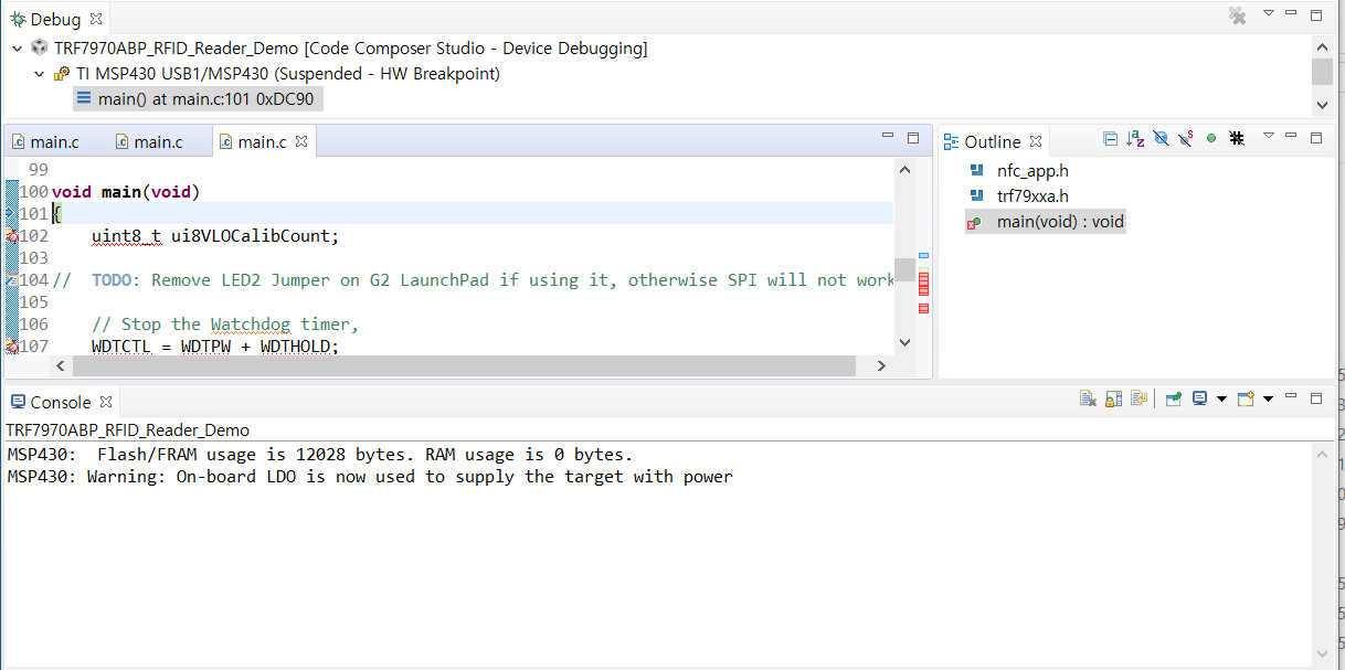

JD Crutchfield told me that he recommend to implement the software from http://www.ti.com/tool/DLP-7970ABP
So I found that file from the web site, and implemented the file on CCS
I want to check ADC value from RF430-TMPSNS-EVM. I connected with TRF-7970ABP with MSP-EXP430G2ET and RF430-TMPSNS-EVM.
But I coudn't check ADC value. How can I check the ADC value from RF430-TMPSNS-EVM?
Thank you in advance

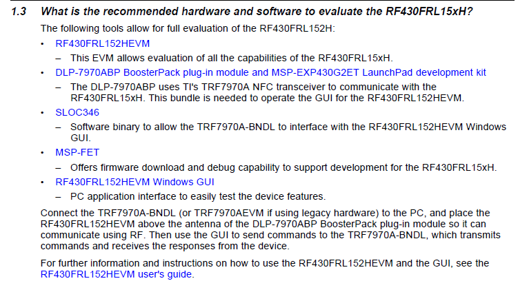

  • Hello Jinwook,
    That is not the right software. See Section 1.3 of the FAQ guide which walks you through everything you need software wise and provides links to other collateral: http://www.ti.com/lit/pdf/sloa247

    I checked the FAQ 1.3.
    Which one do I have to check? sloc346?

  • Hello Jinwook,
    We do not have an example code that is designed to display the ADC values in CCS but you can use breakpoints and check the register value if that is what you want.
    If you don't want to use our provided GUI then you need to implement your desired functionality on your end, our example is specifically setup to highlight all device functionality through the GUI as a singular platform to allow the best evaluation of the device.
