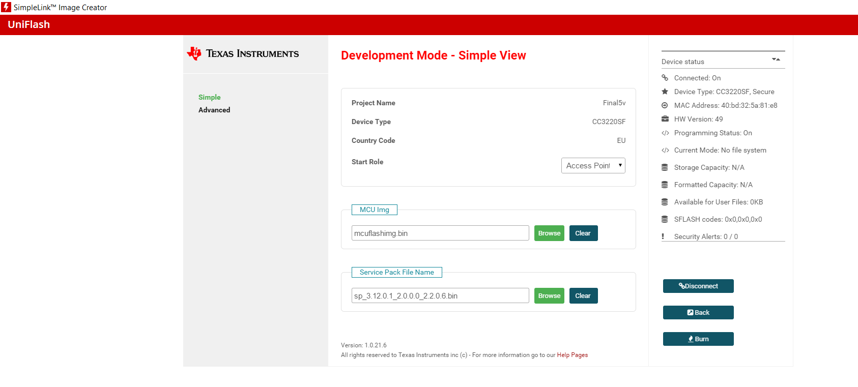

  • Part Number: CC3220MODA
    I'm using CC3220MODASF12MONR module in my board. It came in production mode so i can't able debug using JTAG. Then I tried lot of method. I listed out those below. I have some queries from those attempts.
    1.First Attempt:
    I didn't give a connection for UART in my board. so I removed the module and tapped every wires also UART. Then I changed mode using launchpad3220moda. Then I soldered module again. Then I tested power-on test, the result was good. I debugged all my gpios and other interfaces. At finally I loaded my software file using JTAG debugger XDS110. it worked for all interfaces and connections. But, After the power-on reset, the software gone. I needed to load the software again and again for each power-on reset. So I can't use this board in a product.
    Is there any problem in development mode ?... Can you suggest how to keep my code in my board always even the power-on reset? Because again I can't tap the UART wire and also it's dangerous to remove the module again!!!..
    2. Second Attempt:
    In meanwhile, I removed the metal can of the module in another board. Then I tap the wire for UART pin then I tried flash it in UNIFLASH. It is connected and I saw the MAC address. But I can't burn my img. It shows like this when I try to program image.
    Also I found this please see the memory status in picture.
    Is there any problem in removing the metal can from module? But I Could get the MAC address it means the UART communication happening in the module right?
    Please give me some suggestions 1!!
    Thanks and regards,
    RajeshK
  • Hi RajeshK,
    By "metal can", do you mean the shield on the module? You should not remove that.
    You must flash the device to retain your application upon reboot. You cannot load through the debugger. Please see the device overview of the Out of Box Experience: http://dev.ti.com/tirex/explore/node?node=ANkGhhEkpfMuOBJ20Qo2Jw__fc2e6sr__LATEST
    You are not seeing the storage capacity of the serial flash when you connect, which seems like you may have shorted or damaged the module while removing the shield. Do you have another module?
    Sarah
