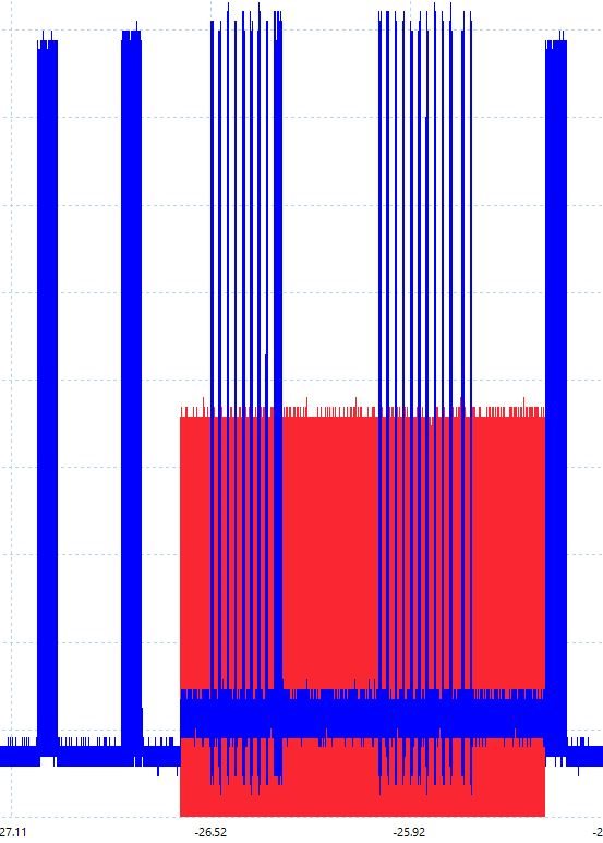

Hey,
I'm using 2 SPI's , each spi transaction works fine tell SPI's transactions works at the same time, both SPI's clock fragmented (see attached picture )
(BLUE-clock of SPI1, RED clock od SPI2)

  • Hey ,
    thanks for your response ,
    This is spi definition
    #include <ti/drivers/SPI.h>
    #include <ti/drivers/spi/SPICC26XXDMA.h>

    SPI master and slave size =8 , both in mode callback , both in mode 3 ( PHA1POL1) ,both in callback .
    spi master transaction 70, abd slave 1000,
    master transaction each 250 microsecinds and slave transaction each 6 milliseconds .
    both SPI's work fine separately .

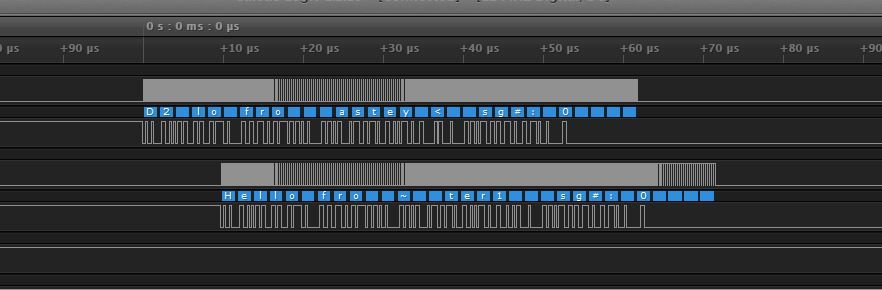

  • I have not had success in recreating the issue.
    Please see the attached project.  I am using the launchpad.dualSPI.zip

  • Hey,
    Thanks for your code example .
    I'm using simplelink_cc2640r2_sdk_1_40_00_45 and the SPI driver looks different .
    I thinks changing the simple link version should solve the issue .
    Thanks a lot , i need to check this and i will keep you updated .
