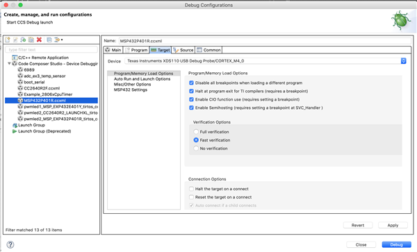

         I am working with a MSP432 LAUNCH PAD. I want to connect to a running device. I am not able to attach to it with out stopping the Micro. When I connect to the device, it always becomes halted.
With the TMS320F28035 I can connect with it, and the device continues running without any problem.

    Which version of CCS are you using?  Historically this was not supported on Cortex M based devices. However with the latest debug stack this is supported.
    I am running CCSv9.1.0 and I can connect to the MSP432P401R LaunchPad without halting the device.
    In my case I am launching a debug session for the .ccxml file (vs the project) so that the program is not flashed again and I have the option to halt on connect disabled (bottom right):
    With this I can launch my debug session, connect to the device, and the program keeps running.  I flashed a program that was blinking the LED rapidly so that I would know if there was any interruption.

                 Thanks for your reply. I have tried with CCSv9 and works perfectly. I was working with CCSv8.
