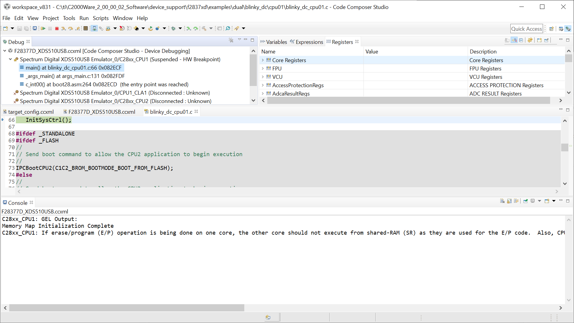

I can connect to and program a secured TMS320F28377D using the XDS510 emulator, but following the exact same procedure with an XDS200 fails.  I am currently using the DSAPI but the same problem happens using CCS directly.
Transcript using XDS510:

C28xx_CPU1: If erase/program (E/P) operation is being done on one core, the other core should not execute from shared-RAM (SR) as they are used for the E/P code.  Also, CPU1 will be halted to determine SR ownership for the CPU which will run the Flash Plugin code, after which CPU1 will be set to run its application. User code execution from SR could commence after both flash banks are programmed.
log: Target is now connected

Both ccxml files point to the same gel script that unlocks zone 1, this can be seen executing when using an XDS510 but not when using an XDS200.  The gel script is read when using an XDS200 but it just does not seem to run.
The session options are identical between the two emulators save for the 'HaltOnConnect' boolean which is false (and unsettable) for the XDS510 but true for the XDS200, setting this to false for the XDS200 makes no difference.
The same JS code is run for both examples, just the config file (ccxml) is different.
Therefore, is there an issue with gel scripts with the XDS200?  Or is something else going on?

  • Richard,
    Despite the logs show the output of the debug server, can you also check the output of the GEL itself? If not redirected to a file, the GEL script usually outputs to the console. Perhaps this output can give additional hints as to what exact point in the GEL routine the processor is locking itself up.
    Considering all other details identical, one thing to keep in mind is that typically the XDS200 has twice the data throughput of a XDS510, thus potentially affecting any delay routine on the GEL itself. Although not with the exact same condition as yours, but I have seen DDR and PLL setup routines causing the processor lockup due to the absence of delays.
    A bit more obscure issue could be a borderline condition in hardware that is causing the XDS200 data transfers to have insufficient noise margin when compared to the XDS510. Given the XDS200 can have its TCLK adjustable in the .ccxml file, you can try to reduce its speed and see if the behaviour changes.

  • Hi Rafael,
    Thank you for your response.
    As the first trace shows, the gel script is outputting to the console, the second trace shows the process with exactly the same gel script, therefore if the gel script was run I would fully expect the output to appear in the trace. Or is there some other output that is available that I'm not aware of?
    I don't know whether the issue is something breaking before the gel script is run or the gel script isn't run for some other reason.
    Changing the JTAG clock speed of the XDS200 down to 1MHz (from 10MHz) made no difference.
    Also, the process also fails with an XDS100v2 so the issue is with both the XDS200 and XDS100.  There is no option to control the JTAG clock speed on an XDS100.
    Any further advice would be greatly appreciated.

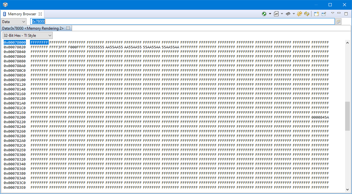

  • Richard,
    Please apologize; I missed your replies and the GEL output on your logs (somehow the failed output tricked me into thinking the GEL was not being printed out).
    It took me a while to figure out the exact steps to protect the Flash memory (it's been a while since I did this), but I was able to program the password and the Z1-EXEONLYSECT registers with CCS (I don't have a script) using my XDS200 Debug Probe. The only errors returned were when I tried to access the protected areas of the locked device.
    I also tested with a XDS560v2 and a XDS100v2 - accessing the protected areas, that is (as the OTP was already programmed  the XDS200).
    Therefore I am not entirely sure what is happening in your case - if this is due to an inherent difference of speed between the two Debug Probes (the faster XDS200 being a bit less forgiving with a possible delay on the target) or a hardware factor (noise or other aspect). Are you using a galvanic isolator between the Debug Probe and the device?

    Below is a memory dump of 0x78000 onwards on my device (connected via an XDS510 and unlocked), is there anything here that is different to yours? Is there anything that looks suspicious?  Am I right in thinking that all the DCSM settings are contained within this block or is there any other settings held in OTP that could explain the difference in behaviour?
    I'm wondering whether the only route now is to send you the board we have and see whether you can connect to it, would this be possible?
    Richard.
  • Richard,
    Unfortunately I can't see the screenshot. Could you resend it, but now you have to click on the small clip button at the top of the editor view?
    I am pretty sure the DCSM settings written to OTP would influence the ability to connect or probe the device, but still the difference between the XDS510 and the XDS200 is really baffling and could only be explained by some borderline hardware condition.
    I could potentially analyze this on your hardware but I would have to confirm with other folks if there is am not familiar with a specific process to do this. I will report back.
    Rafael
  • Hi Rafael,
    Apologies, hopefully this will be visible:
    Richard.
  • Richard,
    Thanks for sending the screenshot. Are you showing this with the XDS200 or the XDS510?
    I see a very similar thing as you, although I had to move the link pointer one position (I goofed up the first time). That is why you see multiple entries on my screenshot. I also do not have anything set on Z2.
    With that, I suspect the focus of the issue is with the XDS200 + board combination.

    XDS510USB failed to connect with bootmode:
    XDS510USB successfully connected with bootmode:
