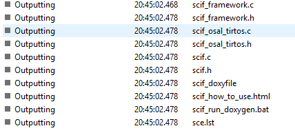

I used SCS (Sensor Controller Studio)examples----LED PMW and it just generated ten scif related files like the first figure.WHY no main_trtos files?
Then I used CCS9.1 to import the project from the default path it will report the error as shown in the second figure.
I want to know how the main.c run in the CCS and how to set the duty cycle and why now I cannot see it in CCS.
