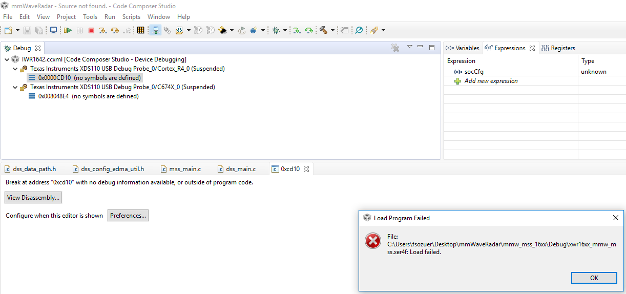

  • Hello;
    I have restored the mmWave SDK to v2.0.0. But now I get a constant error on the XDS110 debugger that is available in IWR1642BOOST. Once I disconnect and plug in the USB cable, the error goes away. The USB error report is below.

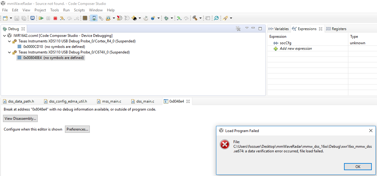

    This error goes away once I remove the USB and plug it in again. But after that, when I say Load program, I can't load "xwr16xx_mmw_dss.xe674" and "xwr16xx_mmw_mss.xer4f" files. The errors are below.
    Finally, I tried to update with the "xdsdfu.exe" program in the path "C: \ ti \ ccs_base \ common \ uscif \ xds110" that you suggested for the XDS110 debug update. However, "xdsdfu.exe" program does not open.

  • Hello Tomasz
    I have applied all the links in the link you gave. The result is the same. Frankly, I'm very sorry for the update. do I have the chance to undo all updates? In no way can I embed the files in the chip.
    Sincelery.
  • Hello Faruk,
    Since you can connect to the device, I believe your main issue is the data verification error. This is a common error, with many potential root causes, that is described in detail in the below link:
    http://dev.ti.com/tirex/explore/node?node=APy2XbLelxyqBB2Yz0WR.w__FUz-xrs__LATEST

  • Hello Ki and Thomasz
    I solved the problem. code composer re-uploaded the old past. Based on this, I just updated the resource explorer. I installed mmwave 2.0.0.4. I re-installed mmwave industrial and automotive files in resource explorer. The problem was solved.
    I think the version problem I have experienced is that the new revision used was written according to another silicon family. I observed differences in linker files.
    Thanks for helping. Sincelery
