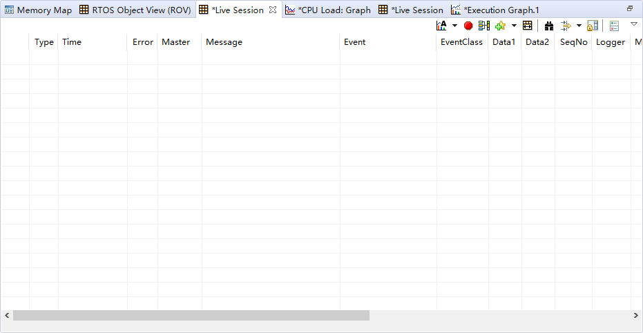

My project is stairstepStopMode_TMS320F28335 which is official example.My chip is TMS320F28335,using loggerStopMode, but after running the download program, click suspend does not show.Just like the following figure:
Of course, there is no display in the next few, but the CPU load in the ROV has data, repeatedly clicking suspend CPU load will change:
and my uia is:
There is automatic generation, but I see the clock is 50MHz, I changed it, of course, before the automatic generation is not shown.And here's my CFG code:

I don't know what my problem is.
