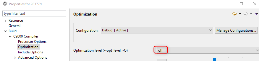

    I have code optimisation turned off (0)
    '0' is not 'off'. To turn it off, you need to explicitly select 'off':
    Please turn off all optimization and see if you can reproduce the issue
    ki

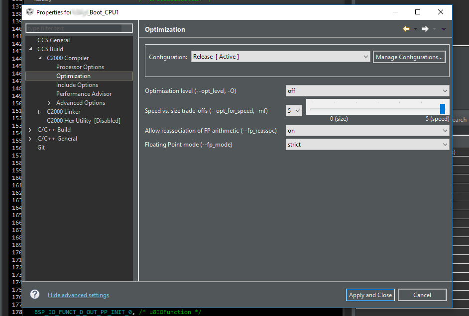

  • Hi Ki,
    sorry for the confusion, it was already set to 'off', not 0. This is how I have optimisation set, which gives me the no local variables problem:

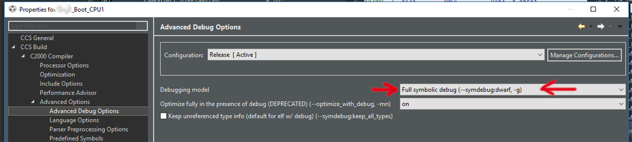

  • I found a solution to my problem. In Project properties, Advanced Debug Options.
    We use this setting as default in our company:

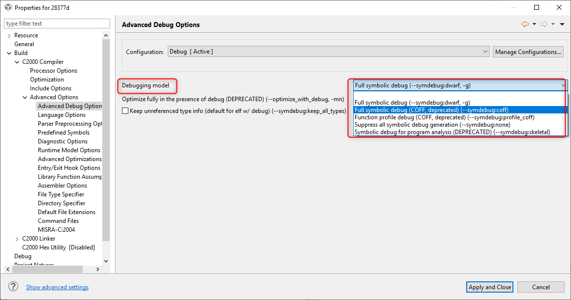

    But if I change the Debugging model setting to be as shown below, then the local watch variables work fine! The address used in the watch window is a stack location, as it should be.
    Why is this the solution, and which setting do you recommend we use as standard? Is there any disadvantage to using 'Full symbolic debug (--symdebug:dwarf, -g' instead of "Full symbolic debug (COFF deprecated:coff)?

  • Good catch.
    DWARF debug symbols has been the default for some time now. It has much more information than the old STABS format.
    And yes, the old debug format was STABS. The text in that drop down menu for the 'Debugging model' is misleading. COFF is technically a file format (like ELF).
    Hence the options in the below screenshot for the file output format make sense, and is technically correct:
    But the drop down for the debug symbol format is not technically correct:
    COFF is NOT a debug symbol format. It is a file format like ELF.
    DWARF is a debug symbol format. Another debug symbol format is STABS. In the last screenshot, 'COFF' really refers to 'STABS'.
    That is why you can select COFF for your file format but select DWARF for your debug symbols.
    the reason for the confusion was TI was historically COFF/STABS for the file format and debug symbol format. Somewhere along the way, people just referred to everything as just COFF format, hence the confusion and why debug symbol information is sometimes referred to as 'COFF'.
    At least this is my understanding of events.
    While STABS is deprecated in support, this looks like a bug that should be fixed in CCS. I filed a bug for this. Tracking ID: CCBT-2475
    If it is not an issue, I recommend building with DWARF symbols instead.
    DWARF is better in every way with the exception that the generated symbols will be larger (2x to 3x larger I think). But this is only for the debug symbols that get loaded to the debugger. There is NO impact on the actual code size of the program.
